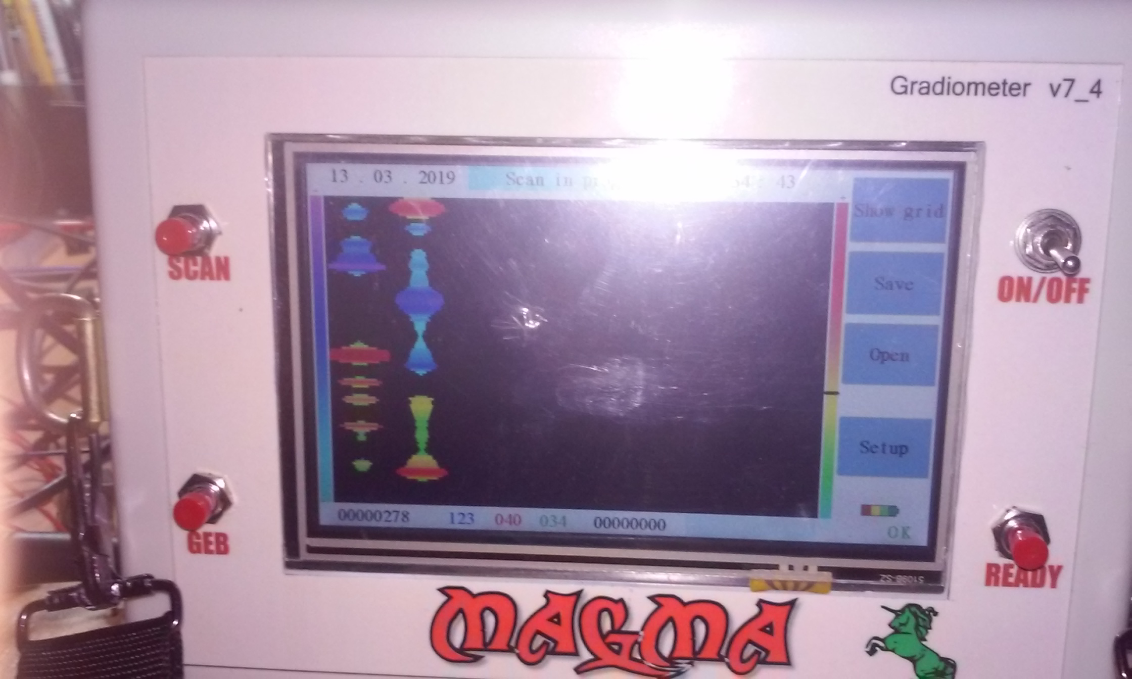

                • I have been using Nextion for a long time he is great can be used for multiplicity application i use it for my magnetometer it's a language pretty easy to learn.
                    [ATTACH]48335[/ATTACH]
                    Nice work Orbit

                        @Orbit your graphics look great. Do you have a video of the display reacting?
                        • I'm using an enhanced version NX8048K050 the first version was written in 2017 and it contains graphics in Nextion depending on the voltage sends command what color to display ,and this is the version you can watch, in the second version it works dynamically which works a lot faster it contains in the processor and sends a command which a specific number for a particular coloractivates ,in both versions it measures 17 times per second then from 17 measurements I draw a mean average and I send a command to Nextion .I will post the second version in a few days that you can see ....https://www.youtube.com/watch?v=NQahEUWLF8k
                          I'm personally very happy with the speed of the reaction the speed of the processor to Nextion is 57600 baudsrate

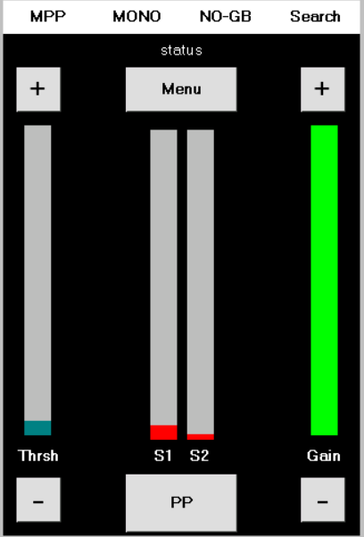

                            • BiPolar PI using Nextion for user interface
                              Using the Nexion Editor. I have started coding up the user interface based on the Nextion 3.5 Enhanced. With just the little I have done with three screens indicates that the Nextion interface will oflfoad considerable processing and development effort from the Cmod-A7. I can already see that I can remove the user interface, PmodOLEDrgb HDL and Flash interface modules along with 5 interrupts and 11 external ports.. The Nextion interface will occupy only 2 external ports and use the Vivado uartlite serial interface with interrupt. Also large chunks of code (both library support and application) can be discarded. I have already identified about 2800 lines of "C" code that can be omitted. Most of the user interface running in the Nextion runs without needing any communications with the Cmod-A7 embedded microprocessor (upc). Almost all of the TX-RX operational parameter initialization can be accomplished by the Nextion and sent to the TX-RX thru the embedded upc. The parameter storage for retention between startups can be handled by the Nextion. The communications load between the Nextion and Cmod-A7 is minmal 50-60 bytes from the Cmod-A7 at 5ms intervals. Communications from the Nextion back to the Cmod-A7 is only needed when there is a change to the operating environment. All of the communications can be handled with no bottlenecks with a baud rate of 115200 and the baud rate can be increased to 230400 if needed.
                              I am going to freeze the current project at it's current state and start a new branch using the Nextion as the user interface. I will leave the link to the current project archive active in case anyone wants to continue development using the current user interface hardware. Future project archives will include the Vivado TX-RX development archive and the Nextion user interface development archive.
