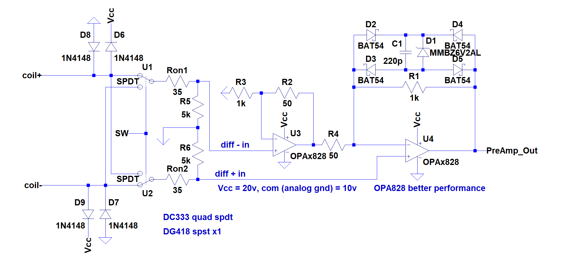

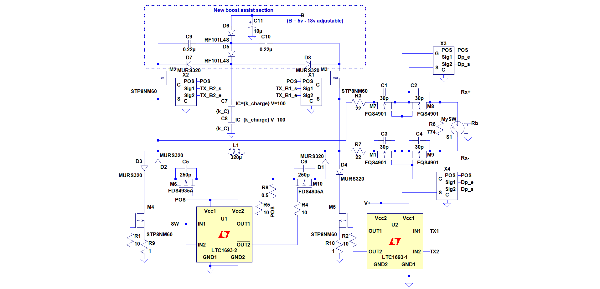

      • Proposed version 2.0 Upgrade to TX-RX schematic/PCB
        I have identified 2 areas of the TX-RX schematic/PCB board set that I would like to upgrade in verison 2,0 of the TX-RX board set:
        (1)RX pre-amp... Get rid of the THAT1512 - OPA828 configuration and replace it with two OPA828's configured as a modified two op-amp instrumentation amplifier. Modified in the sense that the positive input section has a pseudo linlog response to eliminate any pre-amp saturation condition and provide infinite dynamic range of the input. The two OPA828 configuration also has better noise performance that the THAT1512 in low gain conditions (the THAT1512 gain in the current design has a gain of less than x6). The maximum gain is configured by the size of R1 in the following schematic fragment.

        (2) Add circuitry to assist the boost provided to the TX This assist pumps the boost by the voltage at "B" of the following schematic fragment. As configured, a B of about 9.6v provides fo an absolute flat 1.10A TX for 45 usec of a 50 usec TX pulse.

          Been trying to follow your interesting thread. Wondering what targets you think might drive an amplifier with a gain of 21 into the nonlinear region.
            It depends on what you consider a target, the inductance and configuration of the coil, the configuration of the amplifier, and the headroom of the amplifier circuit. I tend to view a target as anything the input stage might experience across the coil, originating from any source. In the circuit proposed, the headroom is +- 10v around the 10v common voltage. The zener diode controls the transition into the pseudo log response region and prevents the amplified signal from reaching the the headroom limit. With the specified zener, the nonlinear transition region starts about +- 3V, which would translate to a signal of ~143mv. The goal of this circuit is to prevent the pre-amp from going into saturation regardless of the input level thereby not having to deal with recovery whether it is a target, interference, or even the TX voltage during transmit. The gain of 21 shown in the attachment is for interfacing with a 20 bit ADC... to interface with a 16 bit ADC the gain might need to be 256x - 350x. To interface with a 12 bit ADC the gain might need to be >= 1000x. At 350x the non-linear transition would be realized with an input of about 9mv... at 1000x about 3mv
            Kind regards, J.L. King
            • Thanks, does R1 and R3 need to be equal resistance? For a gain of 300 would you change R1 resistance or add another stage of gain?
                Yes... for a 2 op-amp instrumentation configuration R1 and R3 are the same. Also R2 and R4 are the same. The maximum gain si set by the ratio (R1/R4)+1. For a true linear 2 op-amp instrumentation amplifier configuration, eliminate diodes D1,D2, D3, D4, D5, and C1. BTW: the reference common voltage does not have to be 1/2 of Vcc.
                Kid regards, J.L. King
                  ... For a gain of 300 would you change R1 resistance or add another stage of gain?
                  Sorry, I missed the second part of your question... For a gain of 300 change R1 and R3 to 15k. In post #367, I incorrectly stated "The maximum gain si set by the ratio (R1/R4)+1"... it is actually set by the ratio R1/R4 with R1 = R3 and R2 = R4.
                    Thanks, brings up the question. What is the minimum amplifier frequency cutoff? I've been trying for 1MHz with my testing, probably higher than needed. Think MPP calculates around 300kHz. If I calculate correctly, your amplifier with a gain of 300 would be around 150kHz. With a gain of 21, around 2MHz.
                      Actual measured with LtSpice with gain of 300 is 133 kHz (when the ac is set correctly).
                          (1)RX pre-amp... Get rid of the THAT1512 - OPA828 configuration and replace it with two OPA828's configured as a modified two op-amp instrumentation amplifier...............

                          I really like the proposed OPA828 configuration and boost circuit it makes good sense as does removing the unused IF PMOD connectors, it will make for a very nice compact design.
                          Yes, I agree, we need time to test the current version and take notes for improvements for sure.
