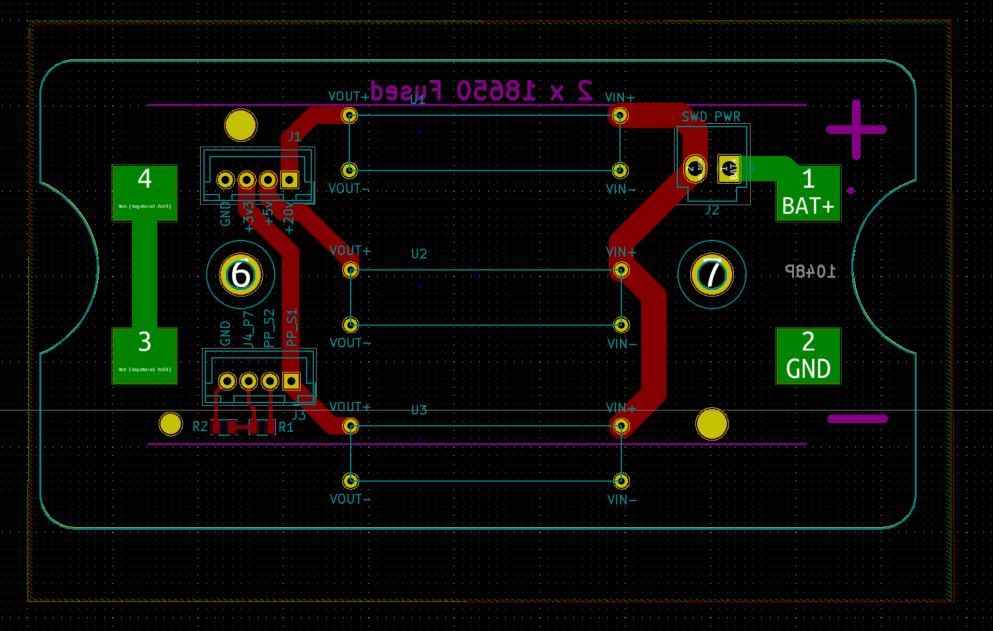

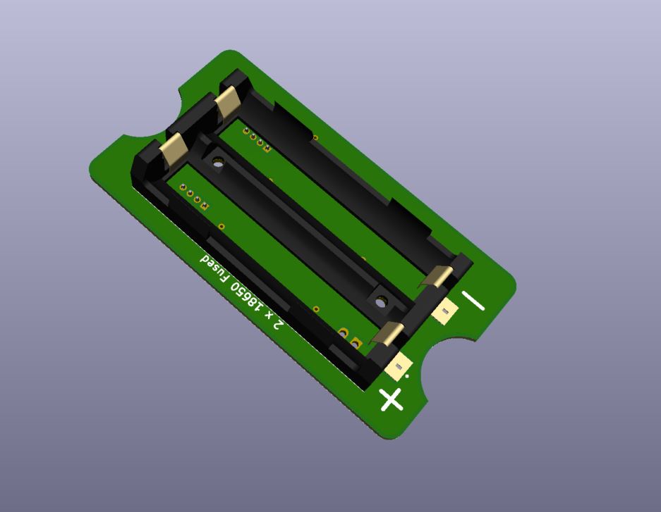

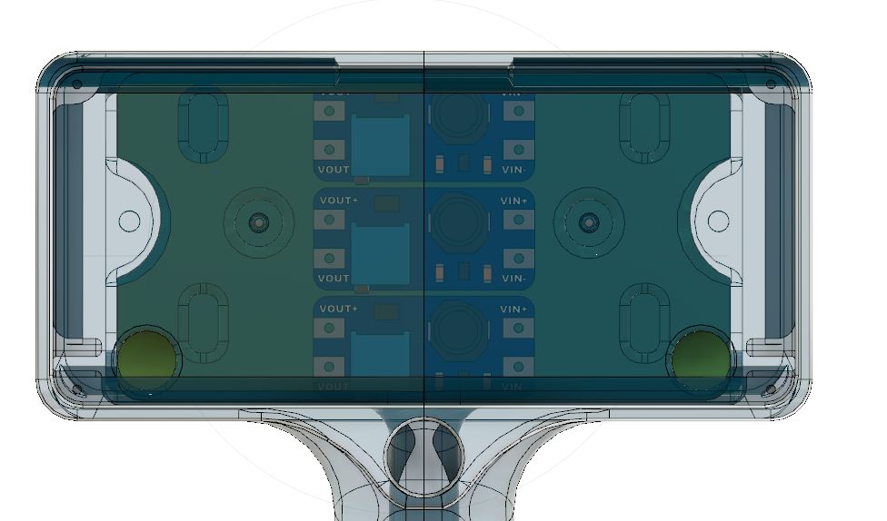

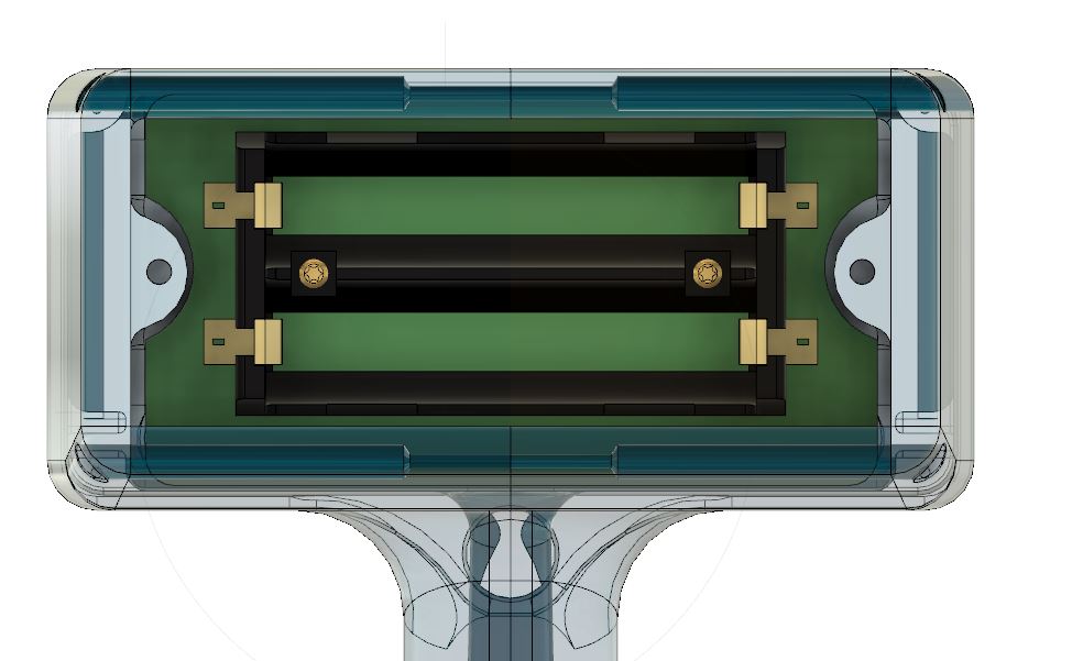

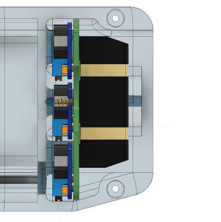

  • JL, I have been working on another option for this particular enclosure, its not developed fully for this particular design but is the general layout I use for my power sources albeit with different circuits.
    Battery holder one side, power supply and protection on the other.
    I still have the full discrete wire version as per last post as I do understand your modular approach but thought I would put this forward as another option for this particular enclosure.
    I envisaged a single row header friction lock 4 or 6 pins mounted on the rear of the PCB with a cutout into the main enclosure.
    If a 6pin connector is used, this would carry Gnd, +20, +5, +3v , Bat+, SW Bat+.
    If a 4 pin connector is used then just Gnd, +20, +5, +3v.
    If the 4 x support pillars in the enclosure were moved to corners of the PCB, this may give enough space to include the coil switch circuit, a cut-out in the rear wall to account for the relay height would be required.
    The cost of the board would be minimal, a little less wiring
    Just a thought for this enclosure

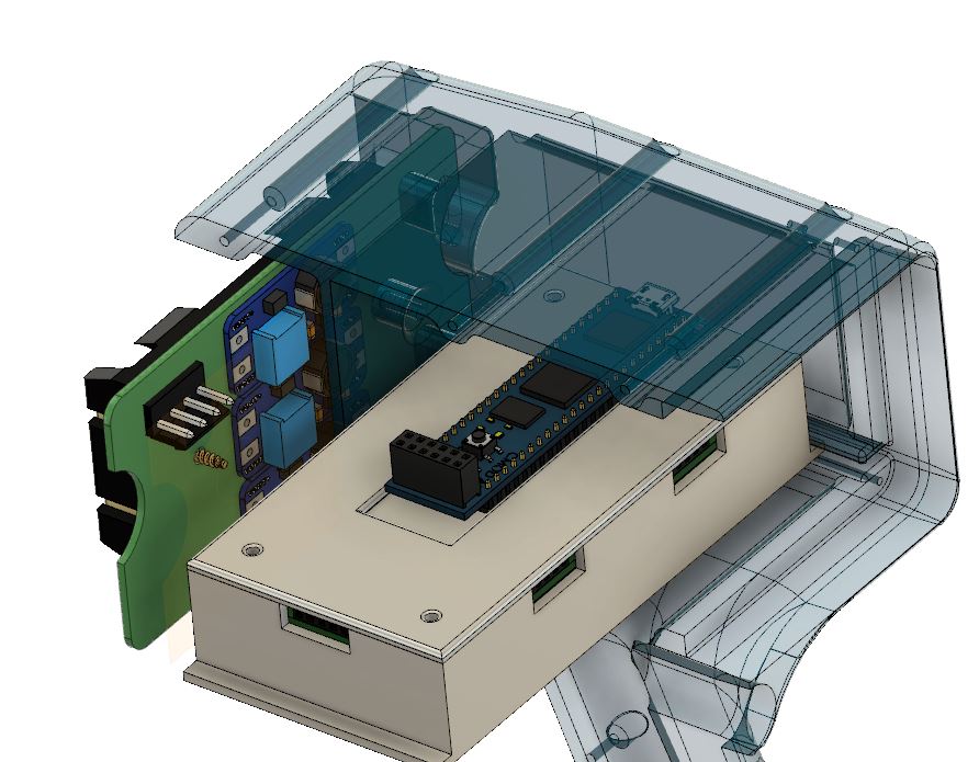

    • Connector placed on PCB , mating to female inline wire tail connector.
      Position shown can be changed to right hand side looking from front of enclosure, depends on position of power switch

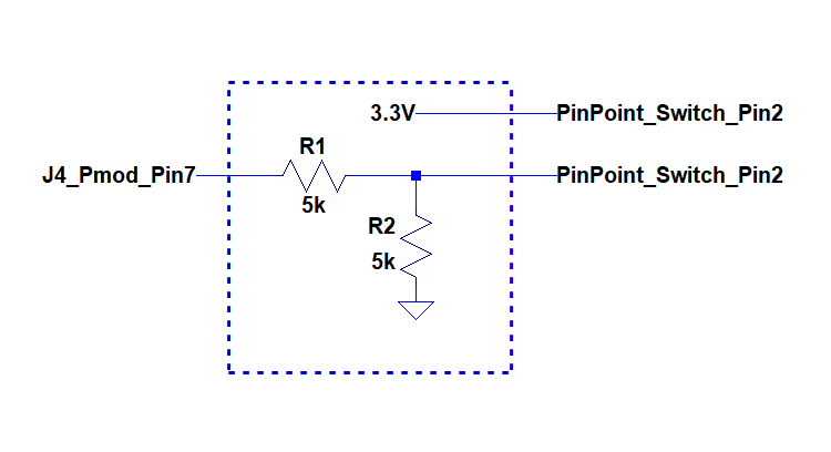

        The more I think about this, the more I like it. It may also be a convenient/logical place for this minimal circuit that is required for Pin Point.
Name:	PP switch.png
        I was going to include it with the probe switch circuit, but was not really satisfied with that approach as not all would wish to include the probe circuit. But the PP switch is required in all configurations and so is power. It only requires 2 resistors and 3 connection pins (3.3V to PP switch, PP switch to pull down(junction of R1 & R2), and a connection for Pmod j4 pin 7 to current limiting resistor(R1)).
        • Power PCB Option1

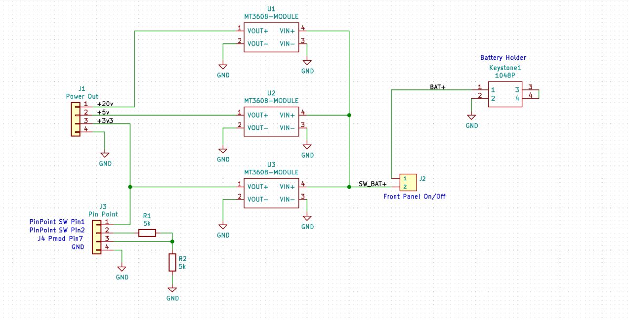

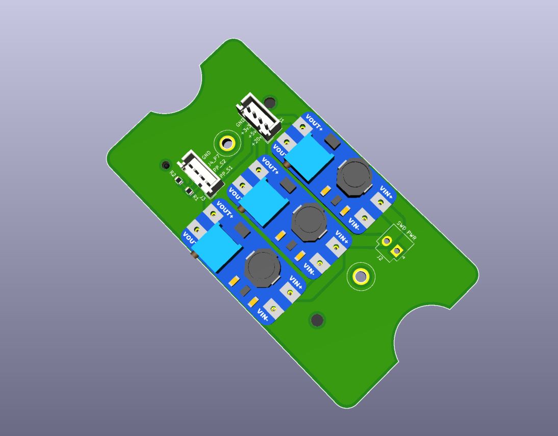

                  • I have been busy on the power supply PCB layout for the posted enclosure design.
                    Still some tidy-up work to do on it, mainly the library inclusions and ground pours. I will post KiCad files later tomorrow.

                        I noticed a small problem with using the MT3608 modules, reading the specs, they are only a boost mode device, I thought they were buck/boost.
                        I don't have delivery of my modules yet, so I can't test.
                        I had thought the batteries would be in series ~7.2v which is fine for the 20v but while drawing up the layout, I thought I would check the device specs and noticed the Boost only mode.
                        This would mean the 5 and 3v3 would not work on 2 series connect cells (I think anyway)
                        If this is the case, then we can simply use 2 x 18650 in parallel ~ 3.6-4v output and put a diode in series with the module used for 3v3 output.
                        As I say, I don't have my modules yet so can't check and maybe I've missed something but best to ask the question...
                        Cheers
                        Mdtoday
                        • Originally posted by Mdtoday View Post
                          Thanks JL, getting there.
                          Cheers
                          Mdtoday
                          so far in all of my projects, I have only used them with 3 and 4.5 volt inputs... and I had not yet used them to generate 3.3V.,, it was always 5V and higher. I probably need to hook one up and test for generating 3.3V.
                            Thanks, that makes sense, I should receive the order of MT3608 modules in a day or two and can check, if you are busy with code.

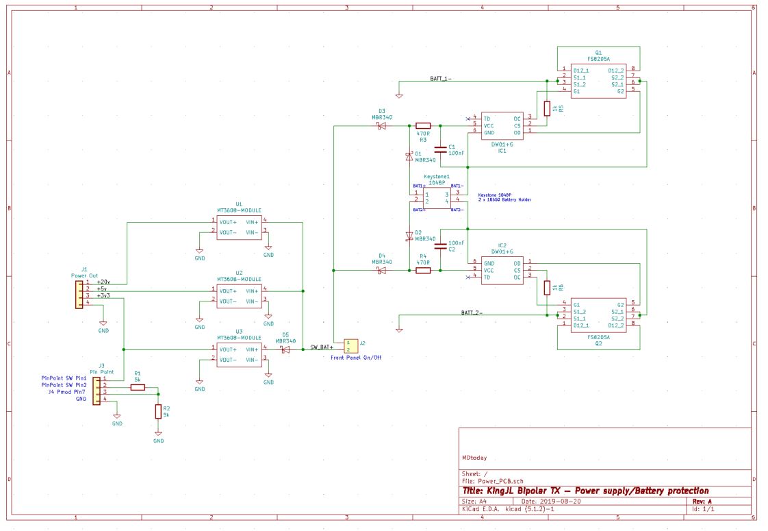

                            • On the Power PCB my thoughts are to include UV/reverse polarity protection circuits for each 18650 cell to prevent any nasty problems occurring.
                              Probably using something like the TI BQ279700, Seiko S-8200 or Fortune DW01-P devices.
                              It adds cost but with Li power cells, safety is always a concern.
                                Here is a draft of cell protection circuit, Click image for larger version
Name:	Power supply_battery protection_A.JPG
ID:	354728 It's a work in progress
                                IC1 and IC2 along with Q1,Q2 respectively provide the protection for each 18650 cell.
                                D1 and D2 provide the reverse polarity protection in case either battery is inserted the wrong way.
                                This will cause the UV/OV points to move but I think this can be corrected somewhat by inserting a voltage divider in place of R3 and R4
                                D3 and D4 provide the isolation for each protection circuit.
                                D5 + D1/D3 or D2/D4 in series should drop the voltage enough to the MT3608 module U3 to work at a lower voltage required to boost up to 3v3... it's not tested yet so we will see once I get delivery of some modules...
                                D3, D4,D5 may have to be standard diodes to get the required voltage drop to U3
                                The MT3608 modules work down to 2v
                                Additional cost of the protection circuit is around $4-$5
