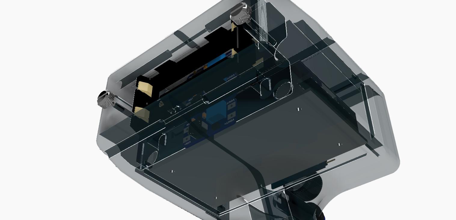

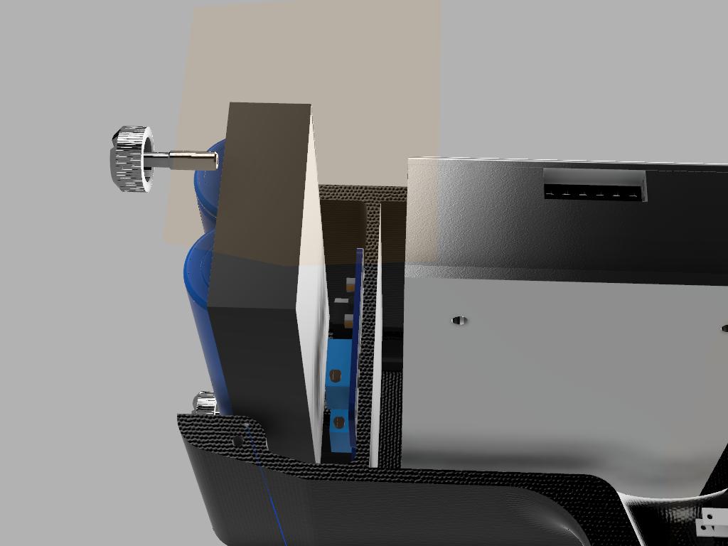

    The Knob is a press fit but can be changed to screw type if required. There is ample height and clearance for screw type knobs though.
    The two halves are mated with 25mm screws in full length support posts [ATTACH]47128[/ATTACH]
    Ribs are yet to be added as there position depends on power supply board placement/clearance
    cheers
    Mdtoday
    As usual you are miles ahead of me!! The reason I asked about the knob was that I have non that are a press fit for a smooth "D" shaft that is used on the Pmod encoder... I may have to go looking!!
      Not a problem JL, I have allowed for up to 20mm diameter knob but this can easily be modified.
      I will put some in the package along with the enclosures and some screws when I send them.

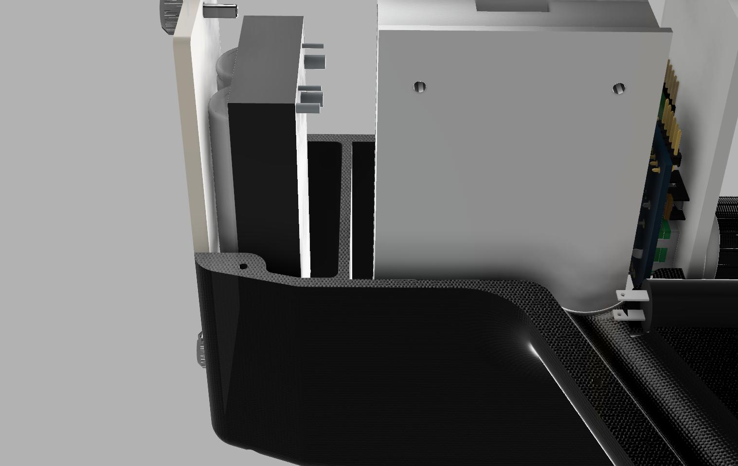

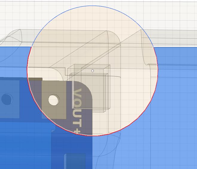

                    • Increased enclosure length slightly to gain 10mm clearance around battery holder top, bottom and back.
                      I will add ribs and wire holes next

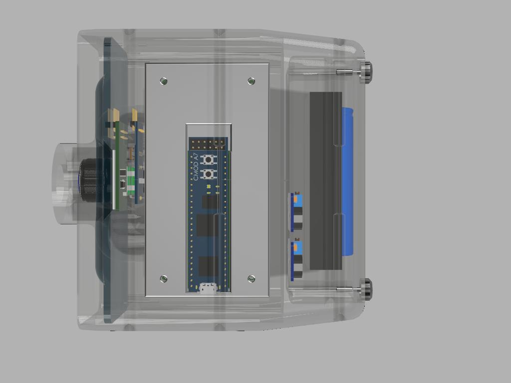

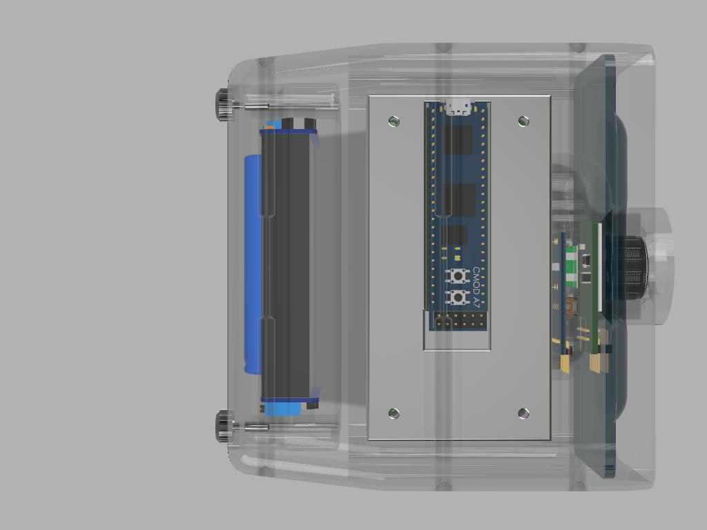

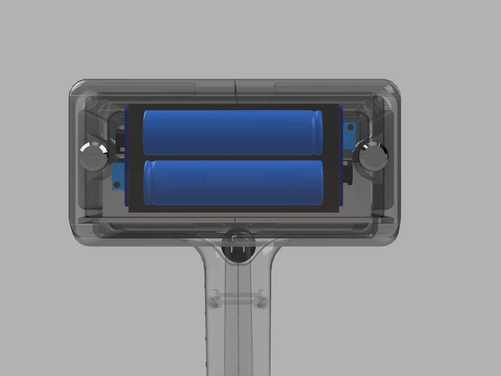

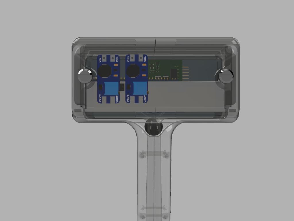

                          • More work on the enclosure, included options for switching power supply module positions
                            Vertical left rear (or right) Click image for larger version
ID:	354682 , Click image for larger version
Name:	KingJL_enclosure _PST1.jpg
ID:	354676 , Click image for larger version
ID:	354677 which is my preference for ease of wiring

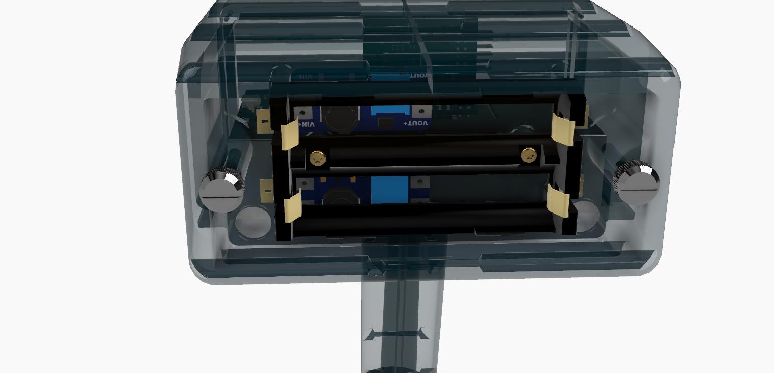

                            Vertical mounted into slots Click image for larger version
ID:	354681 either side of battery carrier on rear wall
ID:	354678 , Click image for larger version
ID:	354679 , Click image for larger version
ID:	354680 useful if voltage requires adjustment
                            Both versions would be clip in type mount

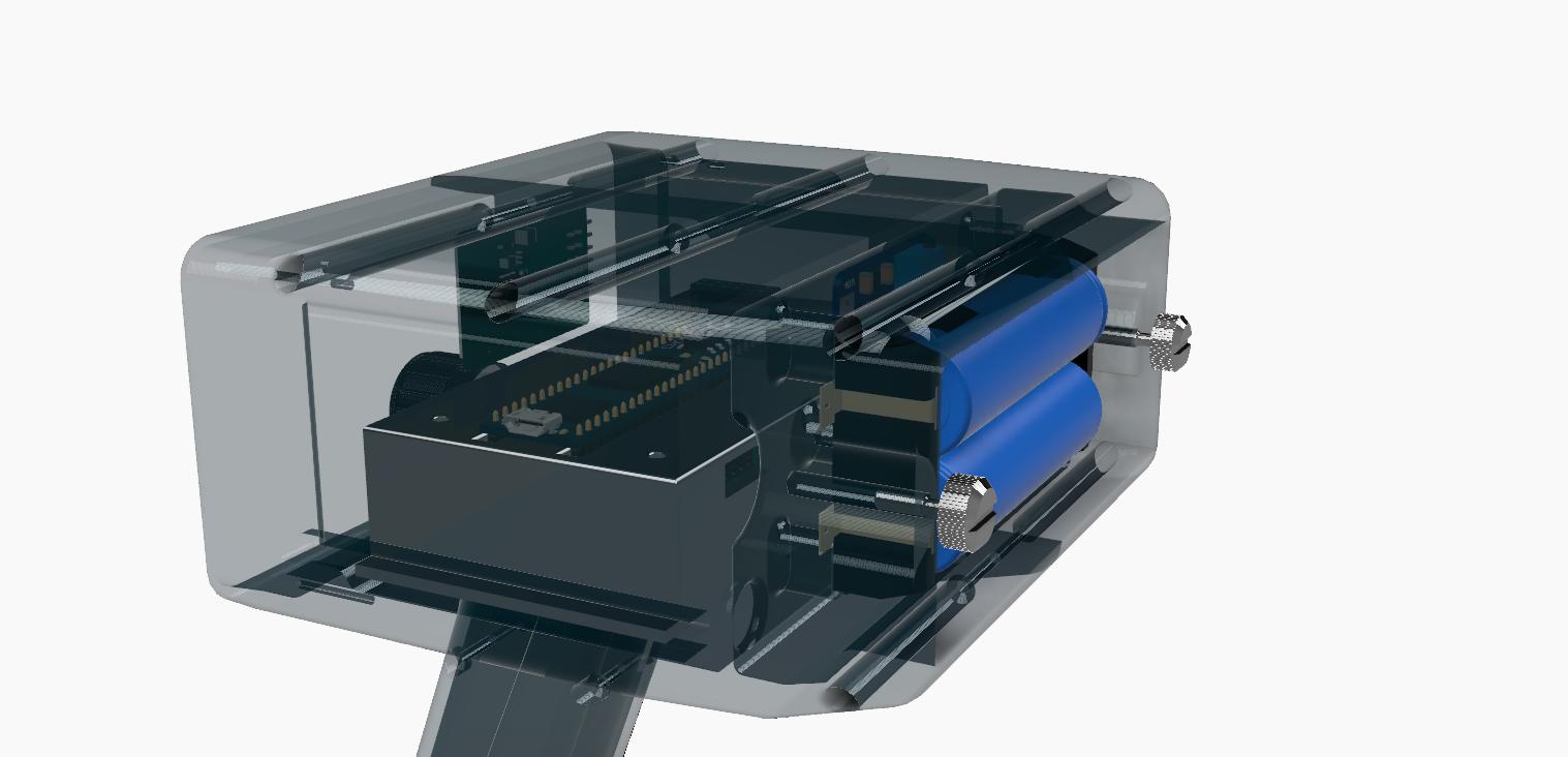

                            • Originally posted by Mdtoday View Post
                              ... Vertical left rear (or right) [ATTACH]47142[/ATTACH] , [ATTACH]47136[/ATTACH] , [ATTACH]47137[/ATTACH] which is my preference for ease of wiring...
                              Both versions would be clip in type mount...
                              I like your preference... and there will be 3 modules used; 5V, 20V, and 3.3V (the only Pmod that is fed 3.3V from the Cmod-A7 is JA (the Cmod-A7 Pmod). The Pmods on the I/F PCB require 3.3V connected to through hole J7).
                                Excellent, wiring will be easier and thanks for reminding me of the 3rd module.

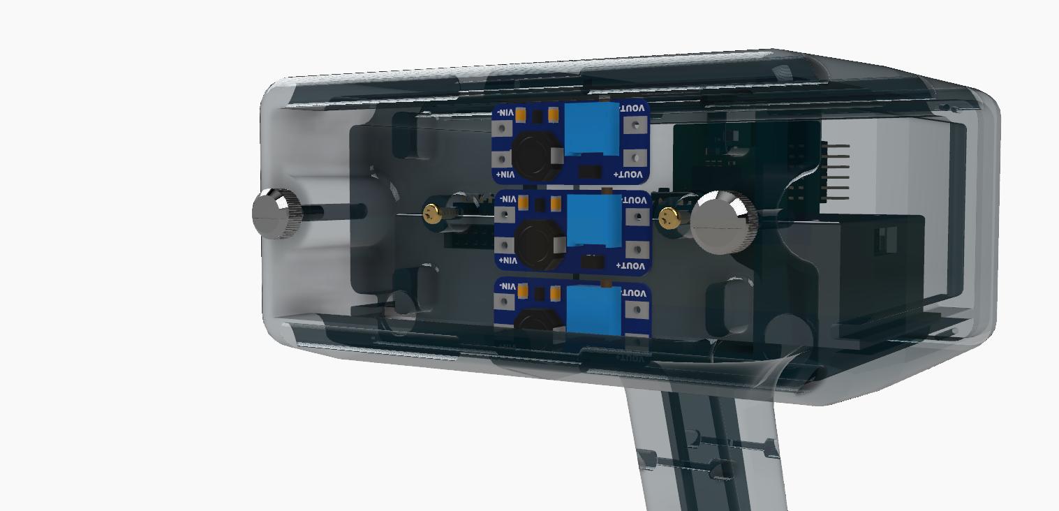

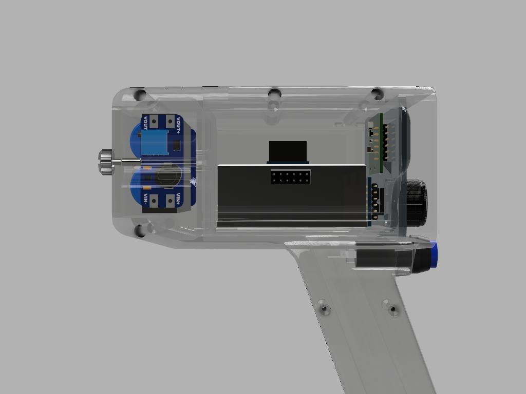

                                I have modified the positions of the modules and added pillars and supports for the Battery holder, along with 2 x 10mm holes through to main electronics area
