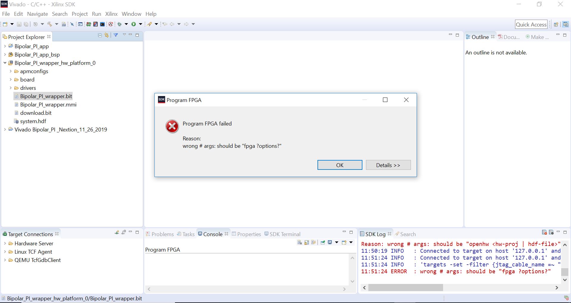

              @JL, here is a screenshot of the SDK errors I am getting. Click image for larger version
              The project is off the root directory, Vivado Projects/
              I have renamed all other previous Vivado project folders with prefix of AA_

                Try starting Vivado... Opening Bipolar_PI... open Block design. Top right should say "write bitsteam complete" with a green check mark. If so go to file > export > export hardware... (make sure that "include bitstream" is checked... accept all other defaults... click OK. After hardware export complete go to File > Launch SDK. Meanwhile I'll try to go over the logs.
                • [QUOTE=KingJL;263798]
                  After starting SDK right click on "Bipolar_PI_app" > clean project. See if it will rebuild everything. After rebuild complete try Xilinx >> Program FPGA

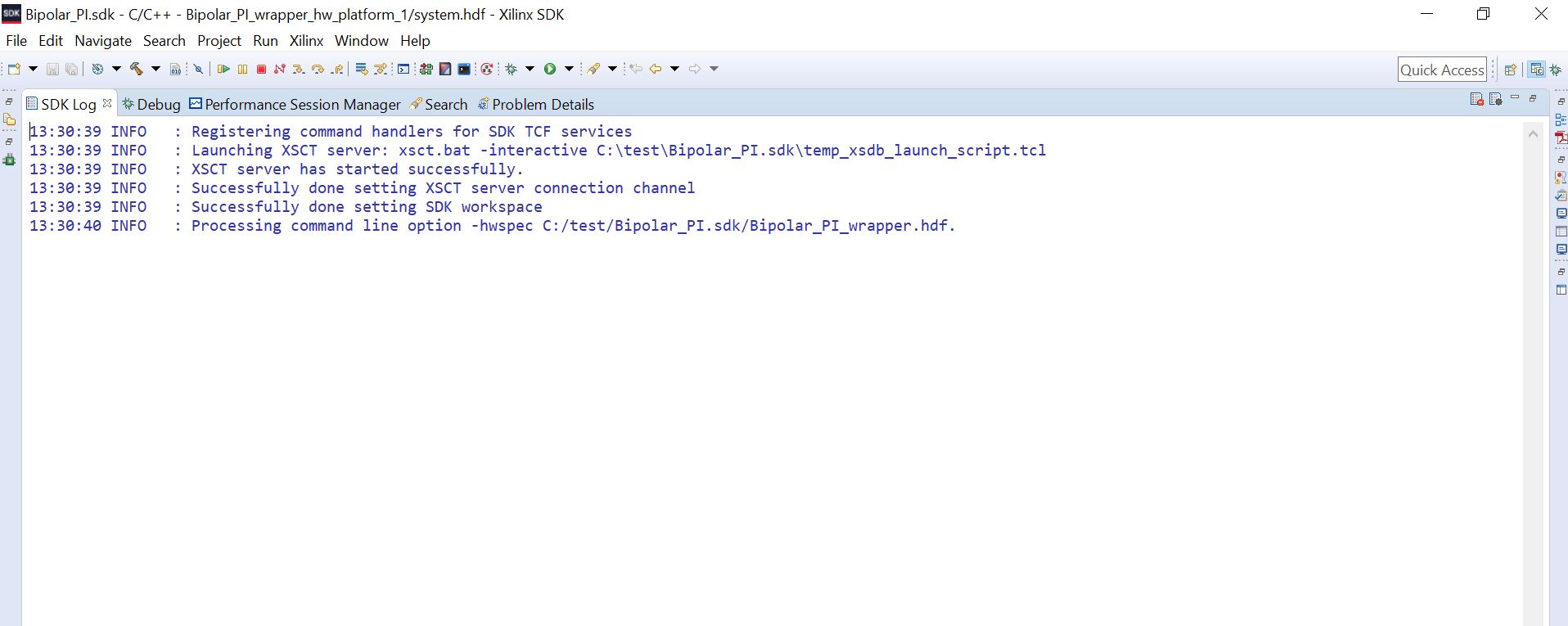

                    • @Mdtoday, I just created a new directory c:\test... unziped the new archive in it... started Vivado, cleared project list... Open Project... navigated to c:\test... selected Bipolar_PI.xpr. In Vivado went to File>Launch SDK... SDK started and rebuilt everything (make.all).
                      Log:
                      Registering command handlers for SDK TCF services
                      21:28:28 INFO : Launching XSCT server: xsct.bat -interactive C:\test\Bipolar_PI.sdk\temp_xsdb_launch_script.tcl
                      21:28:34 INFO : XSCT server has started successfully.
                      21:28:35 INFO : Successfully done setting XSCT server connection channel
                      21:28:35 INFO : Processing command line option -hwspec C:/test/Bipolar_PI.sdk/Bipolar_PI_wrapper.hdf.
                      21:28:35 INFO : Successfully done setting SDK workspace
                      21:38:36 INFO : Connected to target on host '127.0.0.1' and port '3121'.

                        • @Mdtoday, looking over the Log that you sent me, I do notice some strange entries:
                          9:27:02 INFO : Registering command handlers for SDK TCF services
                          09:27:03 INFO : Launching XSCT server: xsct.bat -interactive C:\Vivado\temp_xsdb_launch_script.tcl
                          09:27:05 INFO : XSCT server has started successfully.
                          09:27:05 INFO : Successfully done setting XSCT server connection channel
                          09:27:05 INFO : Successfully done setting SDK workspace
                          09:27:05 INFO : Processing command line option -hwspec C:/Vivado.
                          09:27:05 ERROR : Error occurred while creating hardware platform Vivado_hw_platform_0 from sysdef
                          Most notably:
                          and
                          Now compare those two lines with the same lines in the successful launch log entries in post #505
                          Don't know why but the SDK lauch was somehow in error.
                          • Originally posted by Mdtoday View Post
                            Thanks JL, I was using the same method as you outlined in post 502.
                            Will now create another directory as your test and see how we go.
                            Ok, we are back in business at my end. Thanks for your help JL, much appreciated. So it does not like to be in a directory with anything other than the current project ....
                            I had CMOD A7 Digilent DEMO files in the previous directory which I didn't think would bother it ...
