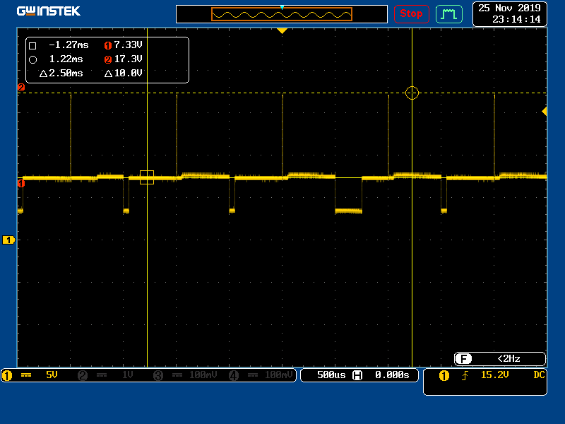

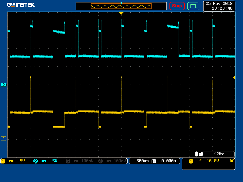

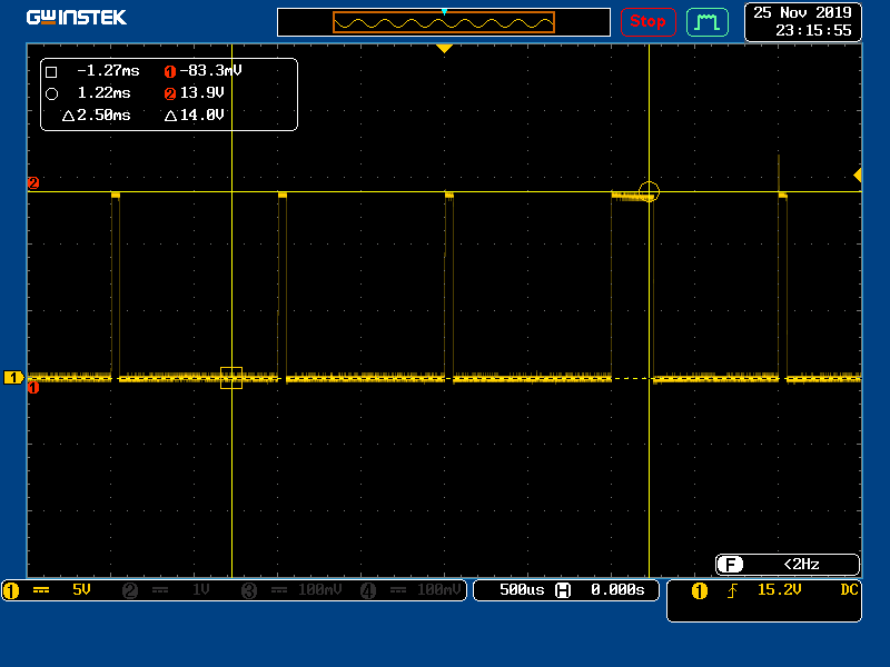

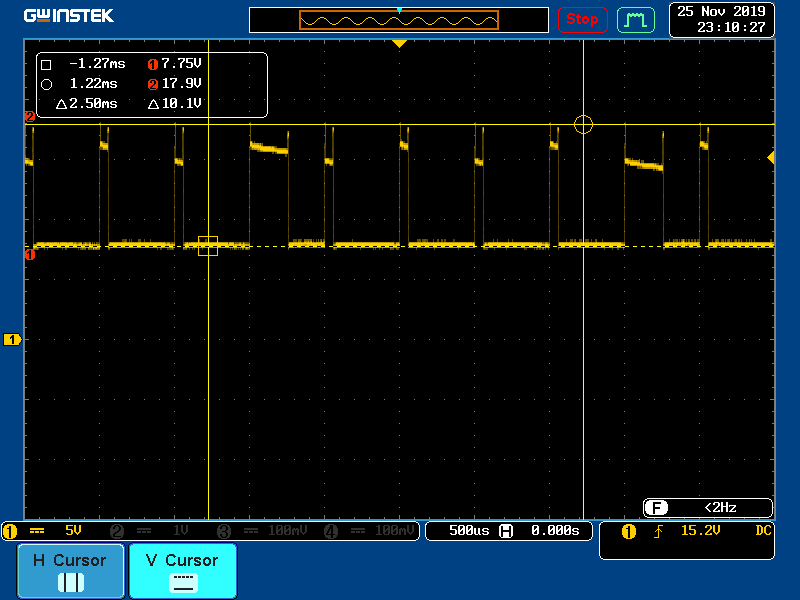

                      @KingJL, here are some screen shots of M1,M2, M6 gates.
Name:	M6_M1_Gate timing.PNG

                        As I suspected, M6 is wrong... I fouled up an swaped the inputs to the EL7202,s for the M6_G and M7_G. I have a fix r4eady for the Vivado project that will fix rhis. It involved switching the ports around in the FPGA constraints file. Will put up the link to it in another post.
                        • New Vivado project archive.
                          There is an error in the schematic for the New Bipolar Boost TX and Front End that results in the DAMP signal sent to the DAMP MOSFET's being inverted. But the problem can be fixed by swapping the DAMP_s and DAMP_e signals set by the FPGA to the TX/RX board. The swap is accomplished by editing the constraints file to reflect the swap of signals.
                          This problem is now fixed in the new project archive, Vivado Bipolar_PI _Nextion(11-24-2019).zip
                          I need to revisit the schematics and change the Labels on the nets goint to the EL7202's for M6 and M7. It really does not physically change anything on the PCB layout... it is just changing signal names.

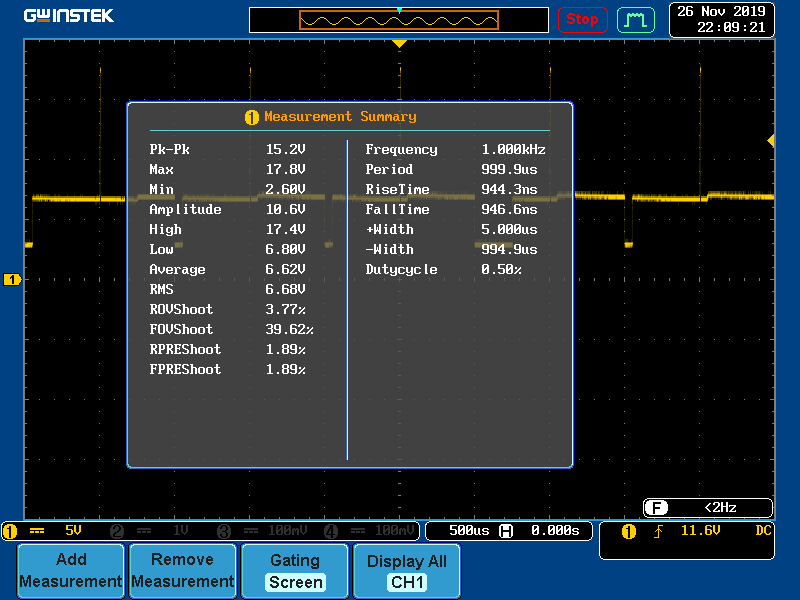

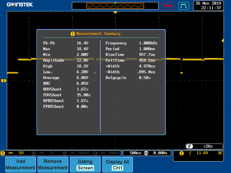

                                I was wondering why, if I wound a transformer with same primary turns, same gauge wires and just increased the amount secondary turns with near identical gauge wires, would I measure only 5v Pk-Pk pulses.
                                Well, the answer is the inductance was decreased by using super-glue to hold the windings. Rewound a couple more without using super glue to hold the windings in place and all was good again.
                                Even completely drying the superglue did not help. Won't be doing that again. When not cured I can see the problem but not dried.
                                Normally I use a nail-polish type glue that I use on trim pots but I was in a hurry to finish the 4 transformers and thought I'd be smart and dowse them in superglue...not a great idea.
                                The 2 new ones I did rewind, were 4 turns primary 22g magnet wire, 16 turns of teflon coated 28g wire for the secondary on one and 18 turns on the second transformer.
                                See attached for waveforms.
Name:	M1_Gate_16 turns 28g.PNG
                                I think I will wind another 4 units with 19 turns on the secondary and test again, there is room for 20 turns comfortably but as JL has stated, we do not want to test the limits of Vgs
