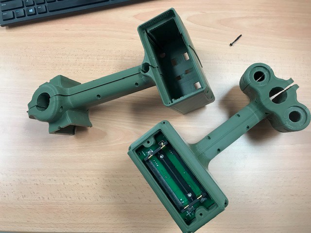

    The 3d printer has been busy this last week with 2 main enclosures and sub parts completed.
    Still some clean up to do on the parts but all screws, PCB and sundry components fit together well.
    There is a slight difference between the first and second printed enclosures (bottom right).
    Originally, I had allowed for a 1.5 mm soft form gasket to be placed between both halves of the main enclosure but decided it was better to remove this as the enclosure will rarely need to come apart.
    The other changes were related to the top screw holes, shaft clamp area, connector bays and internal sub-enclosure mounting ribs. There was not much material above the top assembly holes and I wanted to strengthen that area , therefore I added another 2 mm on the top of the enclosure and put a slight draft on the front and rear side.
    The gasket area is taken care of by printing one with same profile as the enclosure joint edge and using that as the infill, it fits well. It is required for first print only.
    A fine bead of silicone sealant between the 2 halves during assembly is enough to keep dust out.
    The gap between bottom shaft mount clamp area was reduced to 3mm.
    Next, a single 6mm hole was added to the rear of each connector bay to facilitate fitment of a 3.5 mm audio jack. If not used A Heyco type plug can be fitted.
    Final change was to trim the internal side ribs where the sub-enclosure slides into as it was too tight, so I relaxed the tolerance.
    As a final measure, the whole assemble can be sprayed with polyurethane clear paint to protect the PLA and give a nice finish but for prototypes, this particular material will be fine.
    As I had already started the print, I was not going to waste it so the above changes are on the second unit only.

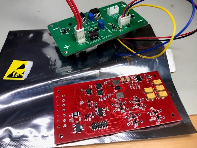

                  • Finally got to sit down and load the TX board up to the stage where I could test the supply lines with 99% of parts installed.
Name:	TX Board.jpg
                    No surprises JL, looks great. Maybe a tweek of the 13.8v output which is sitting at 13.6 but not a problem.
                    The reference is fully adjustable up from 1.25 to to 20v.
                    The 5v line is adjustable with a good range but I must check the full extents again as I forgot to take notes on that one.
                    No shorts or loading down on supplies, all looks good on the DSO.
                    I will spend some more time tomorrow looking more closely with the scope and do some current tests and power up down sequences but looks good JL.
                        The 13.8V isn't critical... 13.6V should be fine.

                        I don't know if I mentioned previously, but the design was baselined with a 500uH / 1.5 ohm mono coil, 5 Volt supply adjusted to 1 A coil current (measured at R9). I felt that we could experiment with coils up to about 750uH / 2.0 ohm. I also plan on creating a 500uH(24awgTX)/500uH(32awgRX) double D. I know some people prefer a positive ratio RX vs TX of the doubleD windings, but I prefer a balance RX/TX for better noise/gnd capacitance cancellation. I already have a 500uH 1.5 ohm (24awgTX) concentric ( I don't readily recall what I wound the RX at... will measure). I also planned on tweaking the gain (via FB resistor R21) of U10 ( OPA828 ). The 500K as in the design, I feel is quite optimistic... will probably end up around 150K to 220K to maintain short TC response.
                          Thanks JL, I thought the 13.6v would be ok, I measured again this morning with my bench top meter and it's actually 13.69v , so pretty close to the mark anyway and as you say, not critical.
                          On the coils, thanks for the information, I have a few different coils but with a max of 450uH RX and 320uH TX concentrics. I planned on building some more to suit this project so it is good to have the baseline info.
                          If you can let me know what size coil you test with , I'll build one to match so we can compare notes when it gets to that stage.
                          It will be interesting to see what gain is arrived at for the OPA828, a balancing act for sure.
                          In my designs I use a firmware controlled analog switch to select one of 3 resistors in series with a high stability panel mount pot to vary the gain. I find it allows for more flexibility with coils and detector stability on different soils.
                          The gain pot has an 'O' ring between panel and knob which greatly reduces accidental movement of the gain position.
                          On another note, I have a hand drawn layout of the proposed internal power supply to main board wiring which I'll put into CAD and post. Will do in Kicad so you can amend as required.
