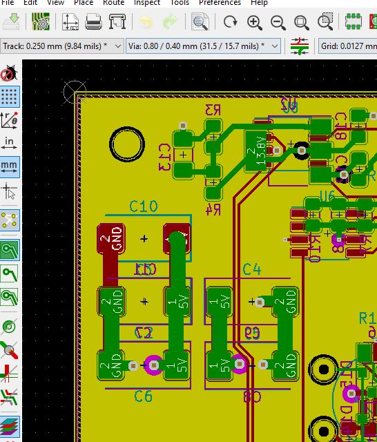

                  New versions
                  I made some changes to accommodate supplying needed bias to the THAT1512 inputs and to remove the R19 path to supply REF to the positive THAT1512 input. All files, schematic, board, BOM, and gerbers have been updated.
                    Thank you, I had a quick look over and noticed what appears to be a missing foot print.
                    I'll have another look over later and report if I find anything else
                    cheers
                    Mdtoday
                      Originally posted by Mdtoday View Post
                      ... I had a quick look over and noticed what appears to be a missing foot print...
                      Not missing... even more hideous... somehow, I had flipped it to the wrong side of the board. So, it ended up with C3 & C19 perfectly overlapping each other.
                      Please continue checking!!
                      Corrected files:
                      • #41
                        Corrected files:
                        Oops...yeah, it's one of those things isn't it, I'll take another look on Ver.6 and report back.
                        Cheers
                        Mdtoday

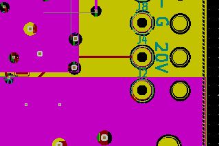

                            • #44
                              Hi JL,
                              I had another look over PCB and it looks like the 20v line is going to its plane via a small track and via?
                              Cheers
                              Mdtoday
                              • #45
                                Gave some more clearance between COIL+ & COIL-. Increased the track width of the 20V input to 0.508mm (there is very little load on the 20V line, but I increased it anyway). A note about clearance: I have the tolerances set to those allowed by JLCPCB. If you use another board shop you may want to revisit the PCB tolerances.
