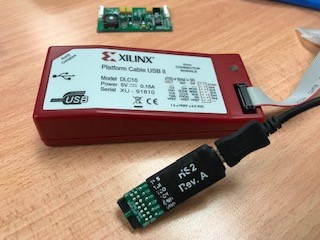

        I have just ordered the Diligent 410-328-35T Development board and should see that in a week. $89 US turned out to be $156 AU with delivery but that is still good value for a development platform with the features this one has.
        I generally have used these JTAG units Click image for larger version
ID:	354109 but this board saves that hassle.
        Oh, I noticed on the interface adaptor board, 3D viewer shows the PMOD connectors mirrored, they don't appear to be keyed so its not an issue but just noticed it.
