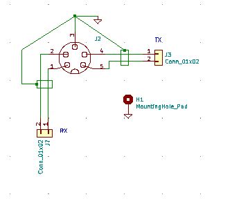

    While doing this layout, I did realise a problem with the Probe/coil connector PCB.
    It is fine for Mono coil use but requires a track cut between the 2 RX pins on the 5 pin connector for use with DD or concentric.
    The zero ohm links were meant to cater for this but I messed up. Still it's an easy fix, just annoying that I missed it.
    I am not happy with the Coil connector board for use with isolated RX/TX coils and will re-do the layout as the fix for the current board is more of a hack.
    As stated earlier, its still fine for mono coils. The pin out is a standard ML mono connection.
    I will post the corrections and Kicad files in due course.
    JL, I'm thinking we could just go with a 6 pin plug, same style as the 5 pin and use 3 each for TX and RX. That would be TX shield, TX+,TX-, RX shield, Rx+, RX-.
    Alternatively, stay with the 5 pin and run separate shields for TX/RX and joint at the coil connector like this Click image for larger version
Name:	Coil connector PCB.JPG
    What are your thoughts on this?

            Alternatively, stay with the 5 pin and run separate shields for TX/RX and joint at the coil connector like this [ATTACH]48248[/ATTACH]
            After considerable thought, I like "Alternatively, stay with the 5 pin and run separate shields for TX/RX and joint at the coil connector like this Coil connector PCB.JPG".
            If I can find a source, I would like to try Belden 2222 for IB coil cable. The conductor to conductor capacitance seems reasonable at 18 pF/ft.
              Yes, I agree, stay with the 5 pin, I will make the changes.
              I will also speak with one of my suppliers and see if we can get some Belden 2222.

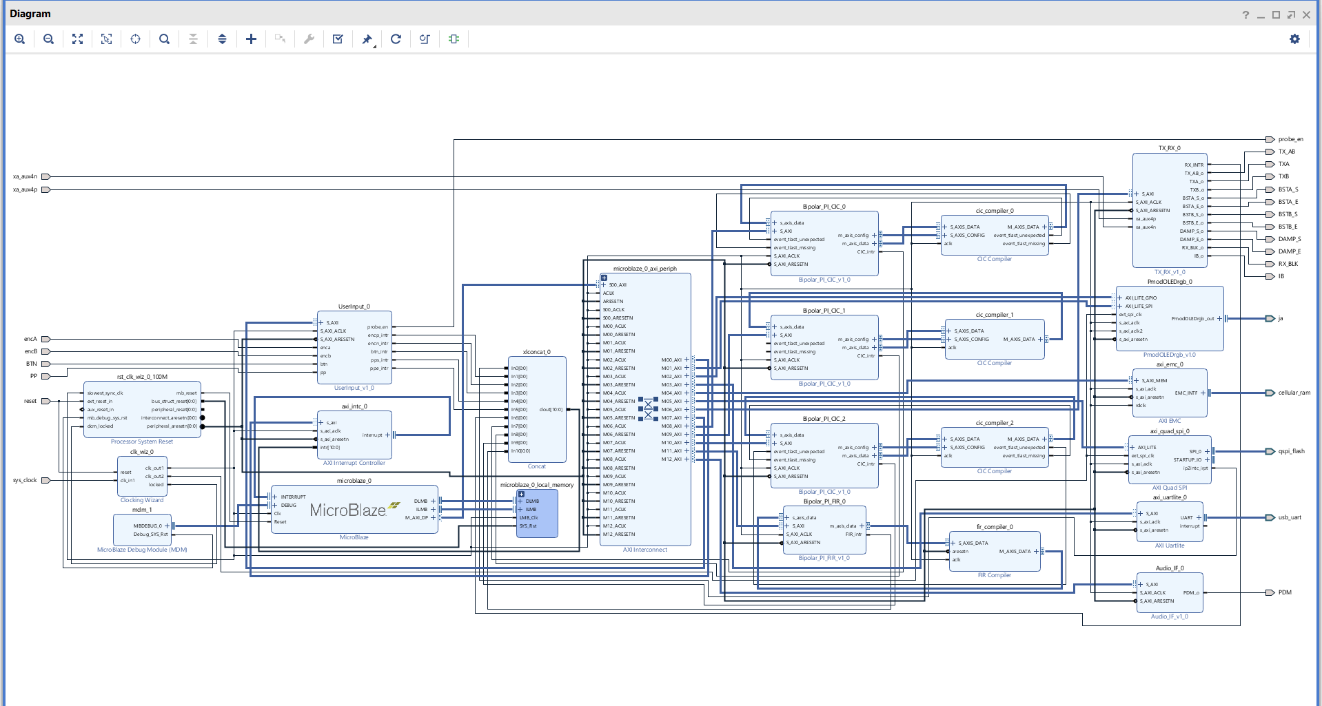

                      • RX Xadc Implementation Change
                        While working with the menu's I made a discovery... the values reported by the RX XADC were all positive in reference to ground. What we want is + and - revolving around the midpoint (0.5V at the FPGA pin). With no connection, the reported value should be a large negative number, but were actually around 0. I was under the assumption that by declaring the input channel as bi-polar, that the conversion process would be + and - around the reference midpoint. I WAS WRONG... the bi-polar declaration just changed the way that the input channel was configured to be measured... not the conversion. To correct this, the XADC IP was re-configured with the bipolar setting of the channel set to OFF. Also adjusted the output of the RX data to the midpoint by subtracting 2048 from the 12-bit data.
                        Now when the RX pre-amp output reference is correctly set to ~1/2 of the 20V pre-amp Vcc, the output value of the RX data should be ~0. By calculating the divider network supplying RX signal to the Cmod-A7 (16k ohm), a pre-amp output of 9.66V should be ~ zero RX digital voltage from the RX FPGA module.
                        I plan on implementing a couple of displays for the "Maintenance" menu to assist in manually tuning the RX reference and the damp delay. One display will display the decimal value for the filtered Sample 1 with TX turned off. This will facilitate adjustment of the RX reference value. The goal will be to adjust as close as possible to 0. The other planned display will display whether S0 is positive or negative with TX turned on. This will facilitate manual tuning of the damp delay. Here you would manually increase the damp delay until S0 is negative and then decrease the delay until it flips to positive.
                        The menu system is not yet functional as I am rewriting it to be completely interrupt responsive. But if an operational TX-RX board set is connected, the current debug messages will display the received values from the RX and filter modules.
                        The current project archive is Vivado_BiPolar(11-8-2019).zip .
                        The change log:
                        Change Log.txt
                        The current FPGA design:
Name:	Bipolar PI Design.png

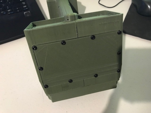

                          Currently, I am just working on the internal wiring length drawing and hookup diagram and also printed a version of the enclosure that has a top hatch like this Click image for larger version
Name:	KingJL Enclosure lid_V1.jpg
ID:	355555 just for ease of access and as an aid to get the wiring lengths right.
                          I'll be post up a drawing and photos once completed.
