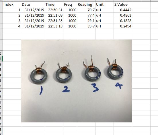

        • Got back to some testing tonight thanks to KingJL's timely package of toroid cores, much appreciated JL!
          I thought I was on a winning streak winding the primaries but as can be seen with attached snapshot....not to be.
          2 cores were close to the mark of 69uH with 4 3/4 turns, 2 were over half that value.
          I tested against my standard inductors and meter is fine on all Frequencies and modes. DER-5000 used to measure. Wire gauge 0.63mm
          There is another package of cores due in soon so Ill check some of those.
          It's kind of odd to have that variation on these cores.
          I will check the 2 low value units to make sure they are not cracked.
          • Originally posted by Mdtoday View Post
            ... 2 cores were close to the mark of 69uH with 4 3/4 turns, 2 were over half that value...
            strange indeed... almost as if 1 (39uH) or 2 (29uH) turn(s) missing!

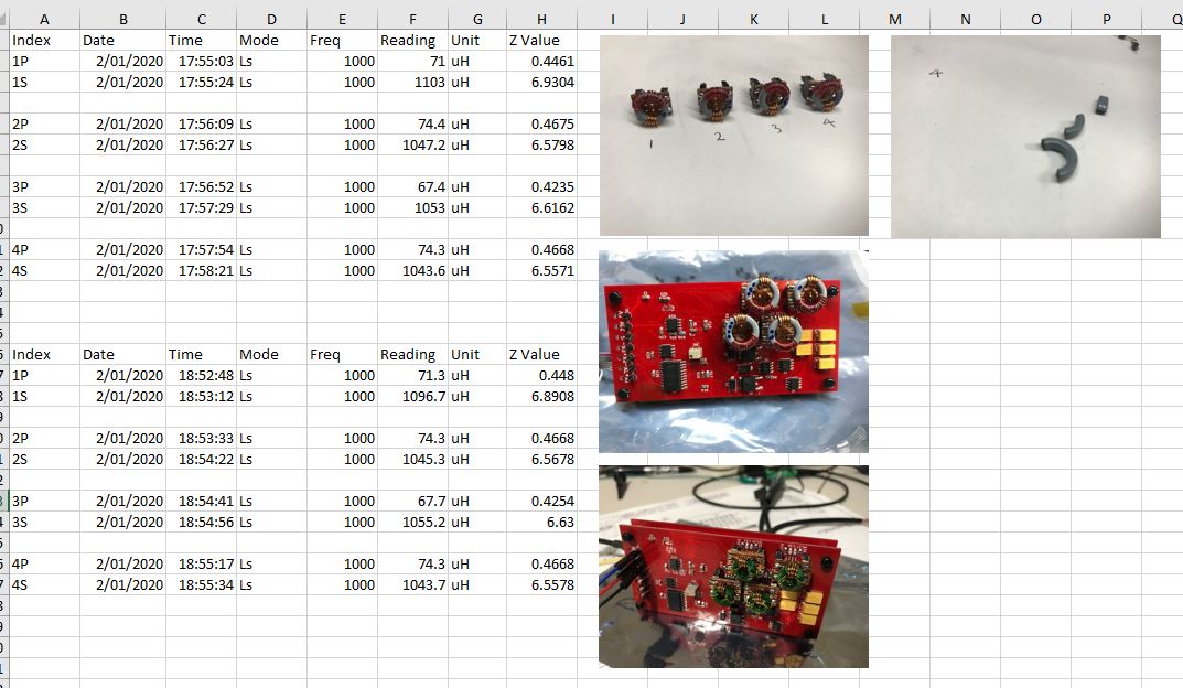

              Received some more of the same cores today (ZW-41303-TC) and did some more winding.. Also found the reason for one (probably two) of the low primary readings from previous test...broken ferrite.
              It was a hairline fracture and did not take much finger pressure to break it. I am surprised I even got to wind the primary without breaking it..
              So a word of caution to those who are using these (and other) ferrite cores, drop them onto a hard surface, they are very likely to be damaged...
              Wound 2 replacements and the attached shows the results...much better.
              Wound another 4 with just the primaries and all measured 74~75uH.
              I mounted the new cores onto the little plug-in carrier boards ready for the next test.....firing the board up and checking the pulse transformer outputs..
              The attached also shows the size difference between the original (bottom pic) and the ZW cores. They fit nicely.

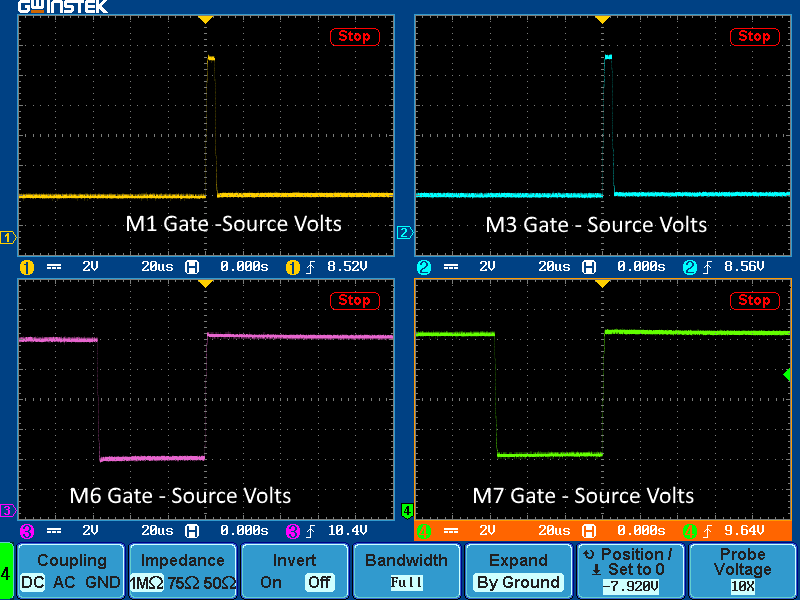

                  I just finished some testing and only getting 9v G-S, so I will have to look at my turns ratio again but one thing is certain, the stability on these cores is much better than originals
                  Here is the test output, please note the damp signals are inverted, I had probes on M6 /M7 (CH3& CH4) on source, however, we can see the amplitude which is all this first test was about.
                    Actually the damp signals look correct albeit a little low.
                      ... and only getting 9v G-S, so I will have to look at my turns ratio again...

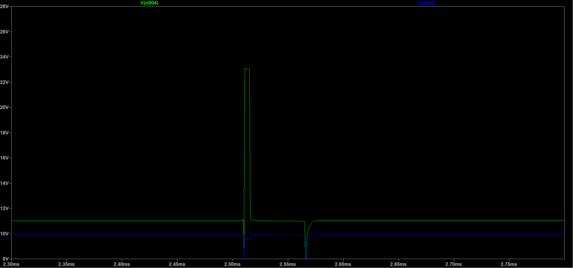

                      Actually, I think the amplitude may be fine. Remember, the amplitude we are concerned about is between gate and source not gate and GND. To get the true measure put the gate on channel A and the source on channel B and you may see something like the following attachment:
                      Here green trace is gate and blue trace is source for M1 (coil disconnected). As you see the amplitude of the green trace seems to only increase by 11V, but when compared with the blue trace the increase at the leading edge is 15.7V until the Vth of the MOSFET is reached and then is 13.5V.
                      I would guess that the output from your pulse transformer gate drive is satisfactory.

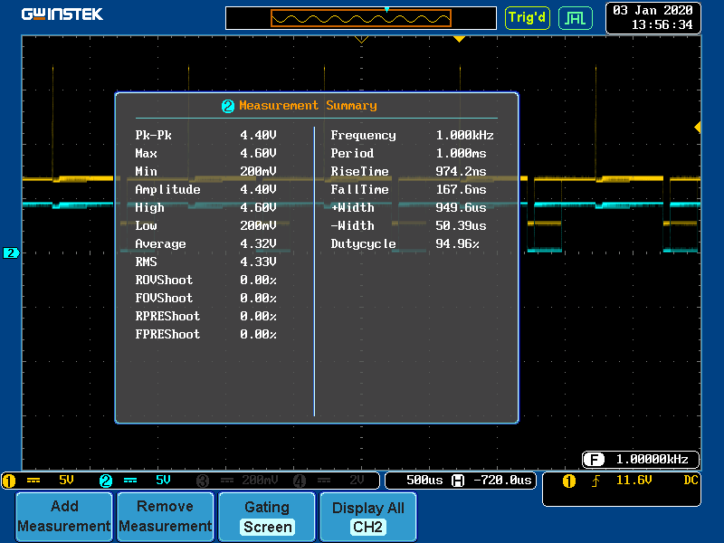

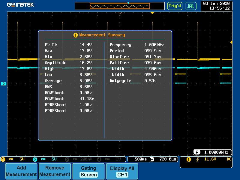

                              Here is the result of test above, Yellow trace = gate, blue trace= source. Baseline 0v is centre at blue flag 2
ID:	356154 Click image for larger version
                              I will now change the 2.2Meg resistors to 10Meg and re-test
                                [ATTACH]48994[/ATTACH] [ATTACH]48995[/ATTACH]
                                If I am reading correctly source is at 4v (during boost time) and gate is at 17 which give a gate drive of ~13 volts. What really concerns me is the difference of ~2.5 volts between gate and source during the off time... that is very close to the min threshold voltage of 3V.
