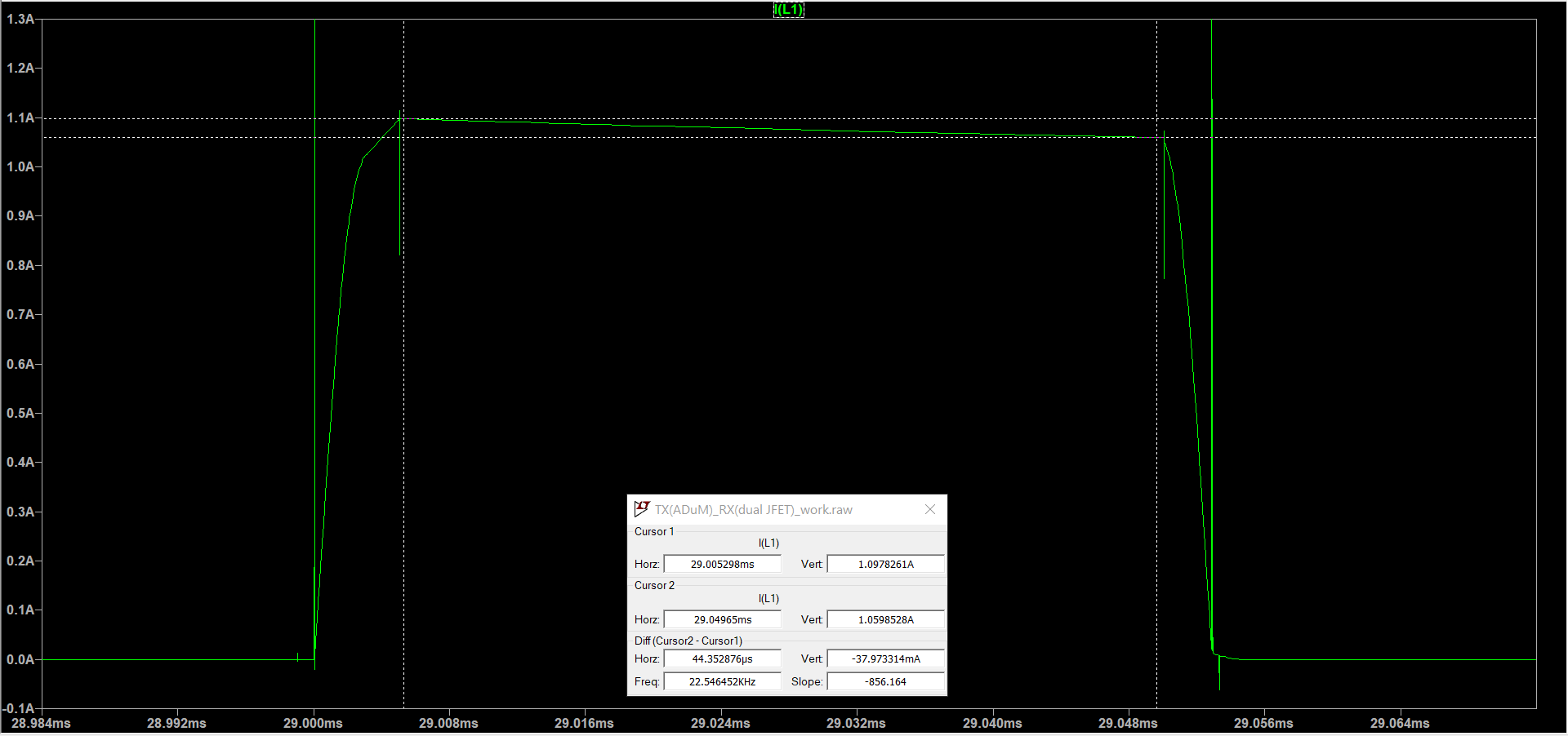

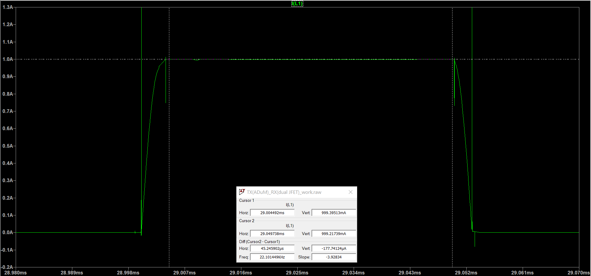

              • Operation with correct timing
                For me also will be easier to try and use PIC32MZ at first attempt maybe just for a proof of concept testing.
                Timings are accurate-ish but I can't get them lower than 2.5uS precision so it's far from perfect.

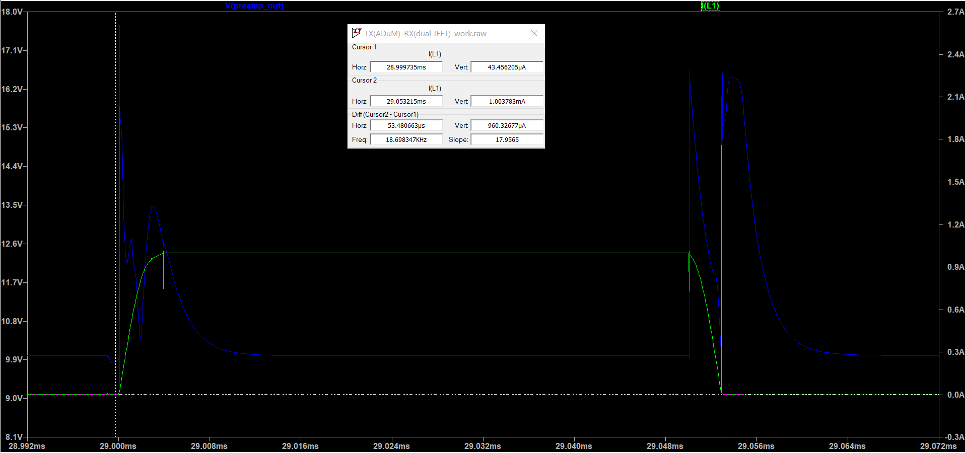

                For those interested in building this TX/pre-amp, I am posting these screen shots of different timings for the boost duration and the damp start timing to illustrate the effects of timing accuracy/granularity. My current design is using an FPGA running at 100 MHZ and has a timing granularity of 10 nsec. Clock jitter is < 10 psec. Any timing granularity greater than 10 nsec will have decreased performance. I put this forward not to advocate and preach the use of the FPGA, but to show the of timing accuracy and stability effects on the design. If you expend the effort and expense to build this circuit and use an alternate method to generate timing signals that cannot achieve this timing accuracy/granularity, you may be severely disappointed with the outcome. Again this is not to discourage experimentation,(which I actually encourage), but to make sure you are as informed as possible before you expend the $$ and time.
                The timing change effects will be posted in separate 3 posts ( due to the attachment limitations... a picture is worth 1000 words ): (1) This post will show the coil currents and pre-amp output results from correct timings for the boost and damp signals. (2) A post showing the results of a 10 nsec timing change. (3) A post showing the results of a 2.5 usec granularity.
                Coil Current (achieves constant current) with boost width set at 3.88 usec:
Name:	correct boost.png
                Coil current and pre-amp output with damp timing starting at 2.85 usec after TX off (coil current at start of damp = 1.003 mA):

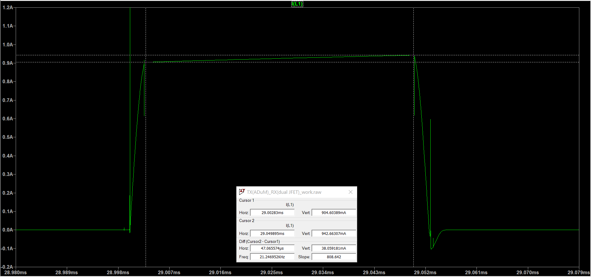

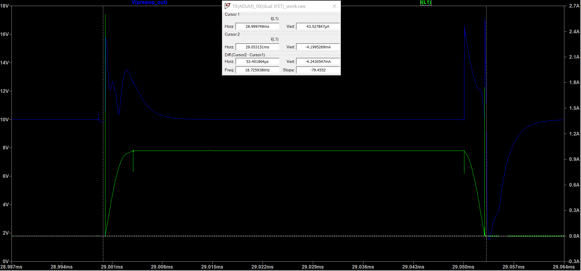

                • Timing effects with 10 nsec granularity
                  The timing change effects will be posted in separate 3 posts ( due to the attachment limitations... a picture is worth 1000 words ): ... (2) A post showing the results of a 10 nsec timing change...
                  A 10 nsec change to boost width has an effect of about 0.5 mA from optimal tha major effect at a granularity of 10 ns is the start of the damp.
                  Coil current and pre-amp out with damp set set to 2.84 usec (coil current at start of damp = 5.6 mA ... a change of 20 nsec brings the coil currebt at damp time to well over 10 mA ) :
Name:	damp 10ns early.png
                  Coil current and pre-amp out with damp set set to 2.86 usec (coil current at start of damp = -4.19 mA... note the pre-amp output swung sharply negative )
Name:	damp 10ns late.png

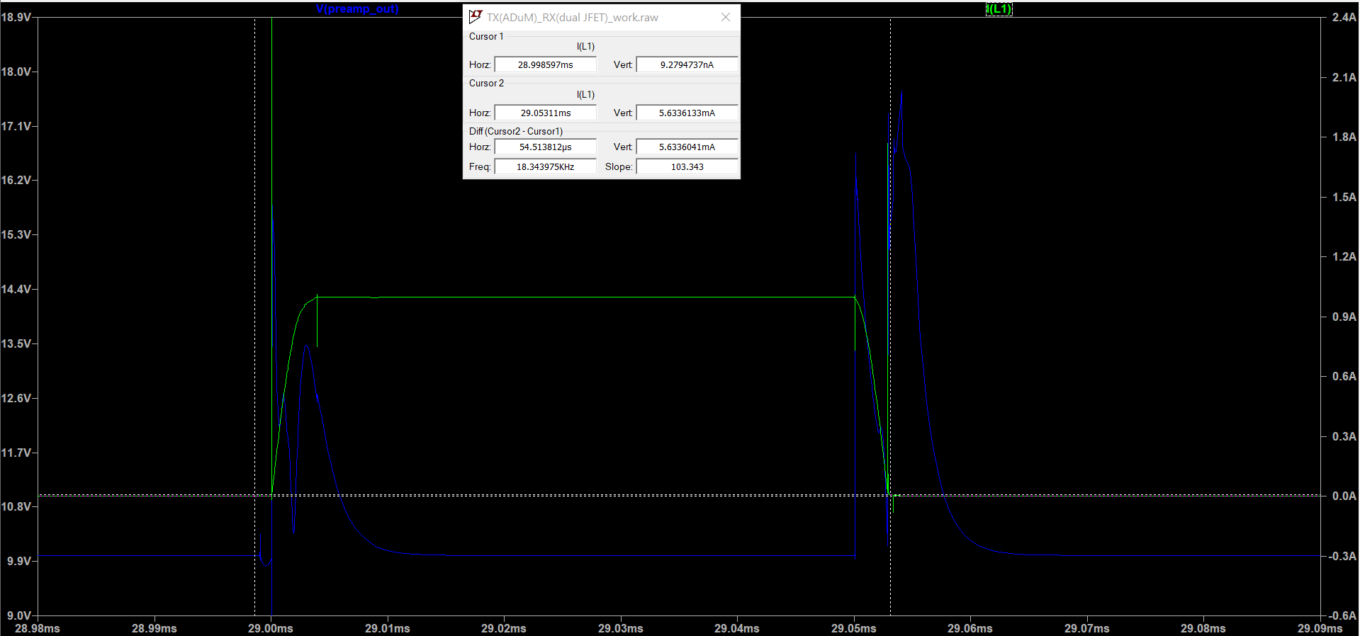

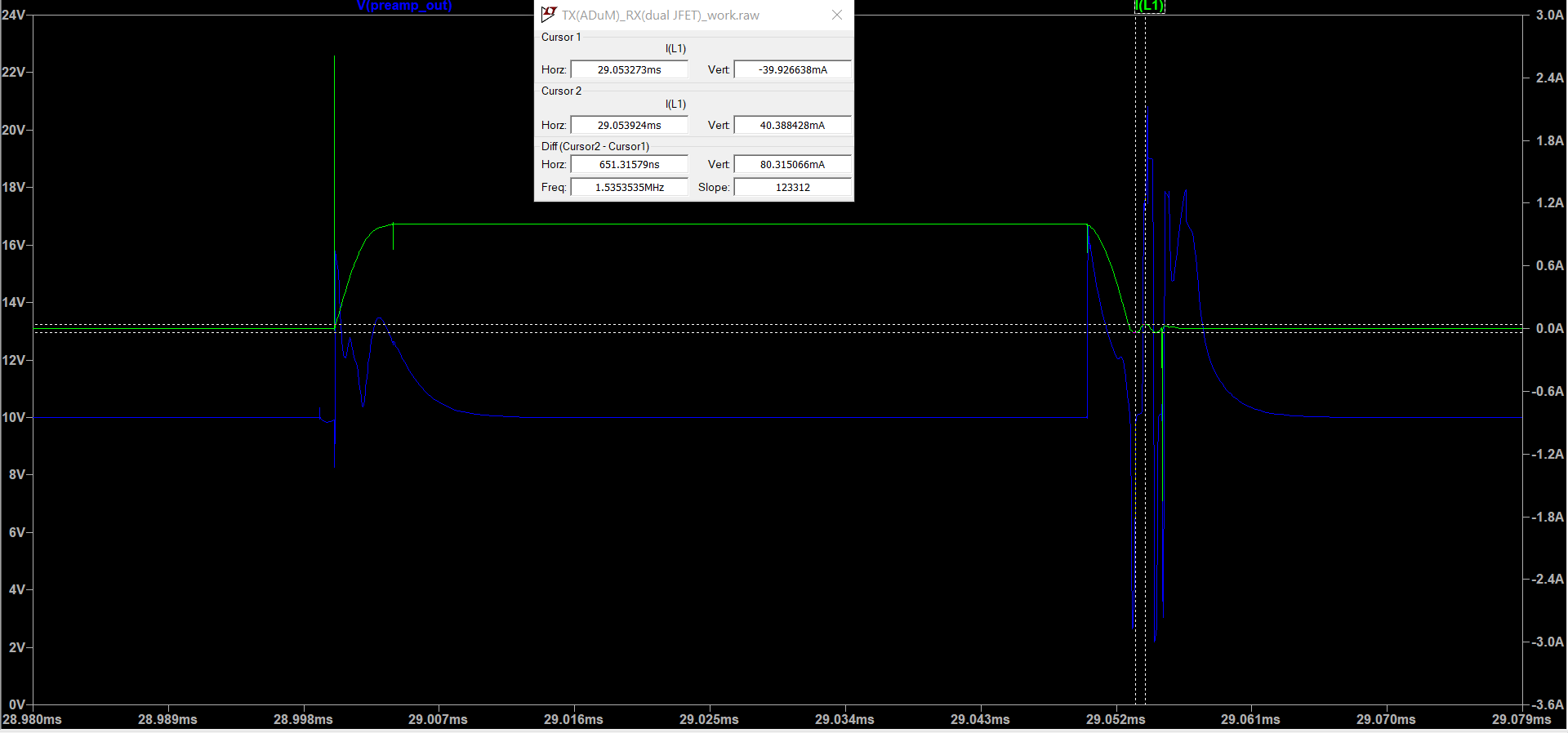

                    • Timing effects with 2.5 usec granularity
                      The timing change effects will be posted in separate 3 posts ( due to the attachment limitations... a picture is worth 1000 words )... (3) A post showing the results of a 2.5 usec granularity...
                      The effects using a granularity of 2.5 usec (even a granularity of 1 usec will have similar results).
                      Coil current with boost set to 2.5usec (damp timing left at optimal setting):
Name:	2-5usec boost.png
                      Coil current with boost set to 5usec (damp timing left at optimal setting):
Name:	5 usec boost.png
                      Coil current and pre-amp output with damp timing starting at 2.5 usec (boost timing left at optimal setting) after TX off (coil current at start of damp = 173 mA ... note extended pre-amp coil decay time... also note that coil current flatness is affected slightly):
Name:	damp 2-5usec.png
                      Coil current and pre-amp output with damp timing starting at 5 usec (boost timing left at optimal setting) after TX off (coil current oscilates from -39 to +40 mA until start of damp... note preamp output ):
Name:	damp 5 usec.png

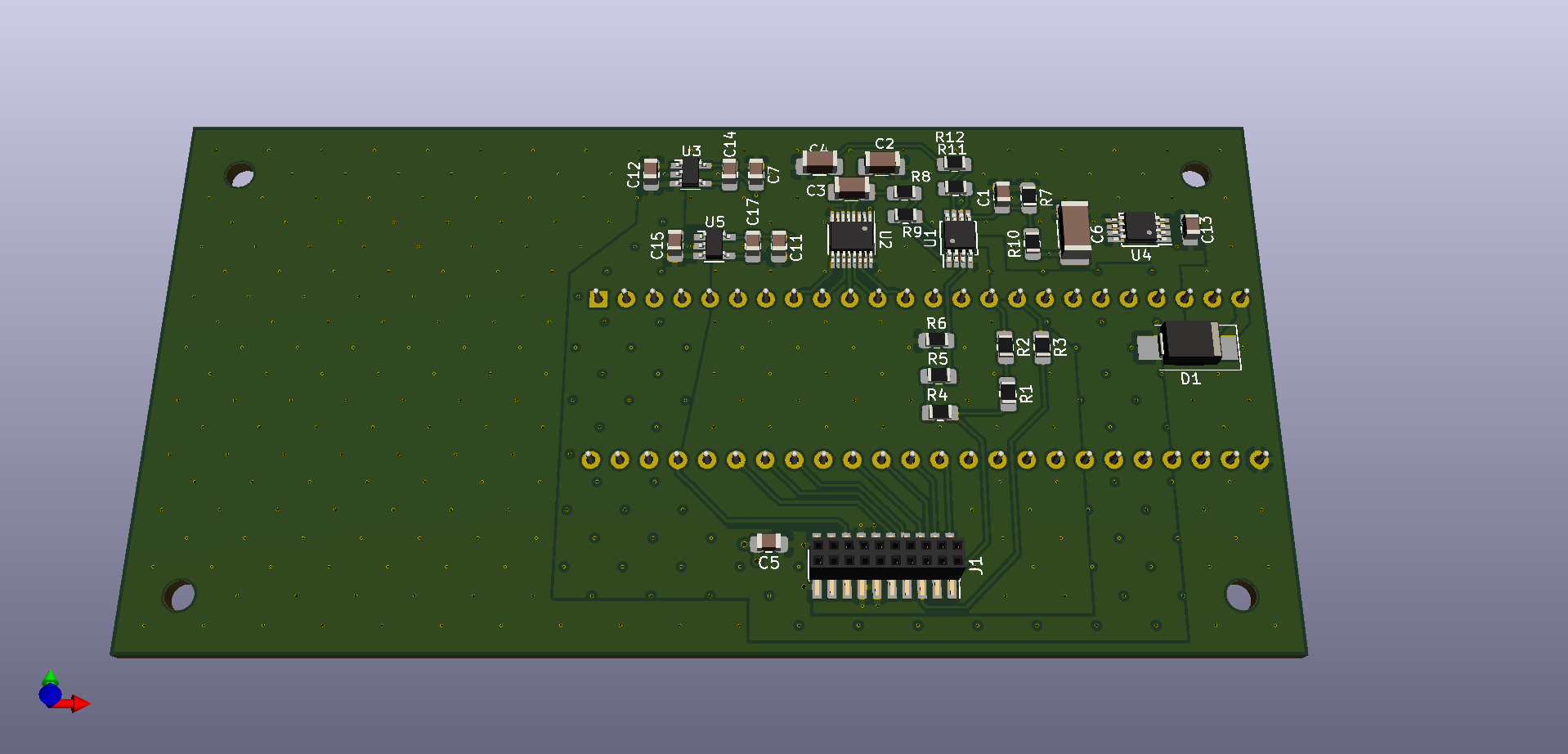

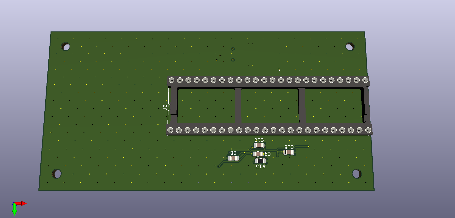

                        • New CMOD-A7_TXX/RX (ADuM driver Version) IF PCB
                          The new ADuM version of the TX/RX board required a new PCB to interface with the CMOD-A7 as the number of signal lines have changed. At the same time, I wanted to accommodate a future move to an LTC2378-20 ADC. Interfacing to a 20 bit ADC introduces some new challenges because of sensitivity to noise/interference. Interfacing with the LTC2378 introduces even more challenges because the LTC2378 and all support IC's are in MSOP packages. To reduce susceptibility to noise/interference and to insure short ground paths, a GND fill is applied to both the top and bottom boards and via stitching is applied with uniform spacing. Then the RX signal path to the ADC is "fenced" with gounding.

                          Top view:

                          Bottom view:

                          Over the next few weeks, the new I/F board schematic, PCB layout, and gerber files need to be vetted.verified. In support of that ongoing effort, I am posting the schematic, the kicad development file zip, the gerber files zip for the interface board, and the IF board BOM.

                            Excellent work JL! Looking really good. I will spend some time going over the circuits and layout during the next few days and report back.

                            • @JL, just checking schematic against manufacturer data sheets and I couldn't locate the data sheet for an LT6302C device, is this meant to be LT6203C ?
                              https://www.analog.com/media/en/tech...s/620234fd.pdf
                              • @JL, I ran a schematic DRC and came up with the following errors...which are not critical as connections on PCB are correct .
                                To remove the errors I did the following;
                                Add label RX to pin 1 of J1
                                Re-assign pins of U2 ...
                                Pin 8 = input
                                Pin 1 = input
                                Pin 11 = output
                                Re-assign pin 6 of U4 to input
                                Remove no connect symbol from J2 Pin 8
                                I only mention this for clarity as my first round checking so far, has found no actual PCB to Schematic connection problems
                                Looks good! I will go over it again a couple of times to be sure.
