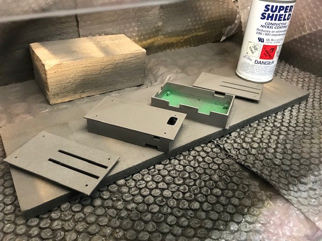

            • Next task was to spray the electronics enclosures with Super Shield nickel based product. It's its great gear but very toxic stuff to spray so a respirator, eye protection and a spray booth with appropriate extraction filter is a must.
              more later

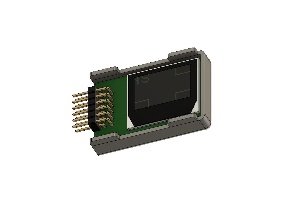

                  • More work on the front panel, this is the snap in OLED mounting bracket which fits into grooves on the front panel
Name:	OLED COVER v4.jpg

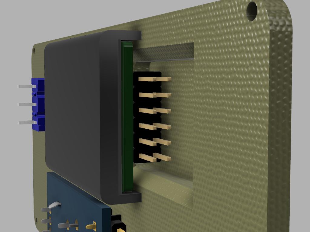

                    PMOD connector is fitted first then module snaps in to panel

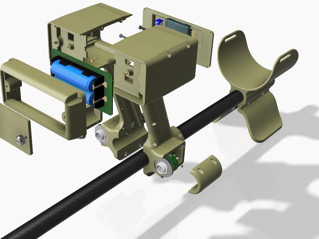

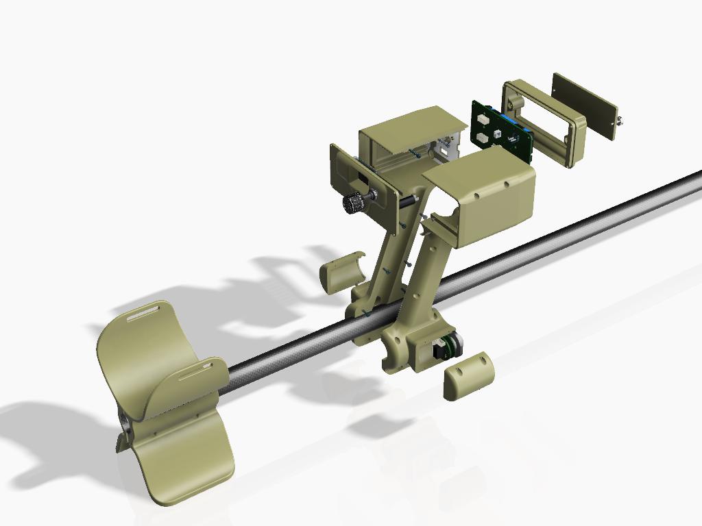

                    • Finally at the stage of 3D printing the updated enclosure parts.
                      Here is an exploded view of the parts to be printed
ID:	355209 Click image for larger version

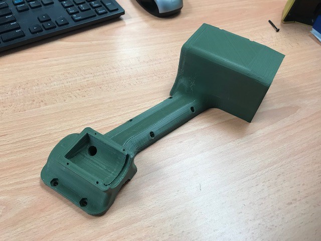

                      First part done, not yet cleaned up. For those interested, printed at 0.2mm layer height, 1.2mm shell and 70% infill. After tweaking future parts will be 0.16mm and 40% infill and 1.6mm shell.
                      This printed part weighs 138 grams.
