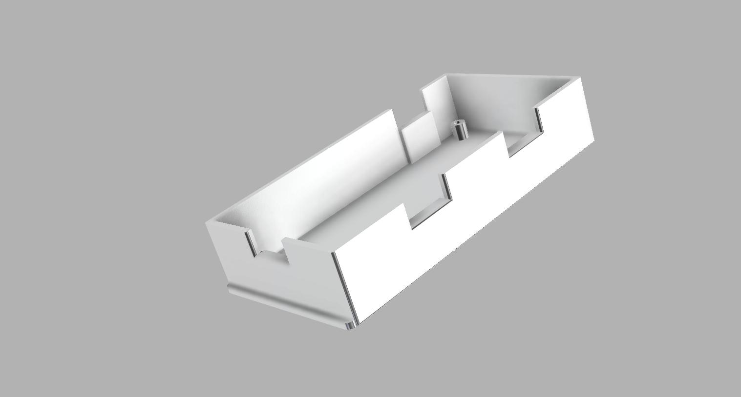

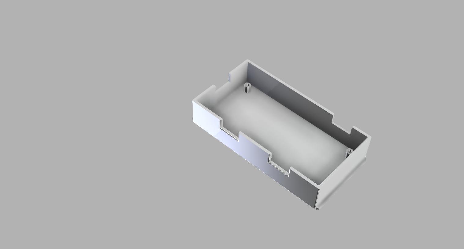

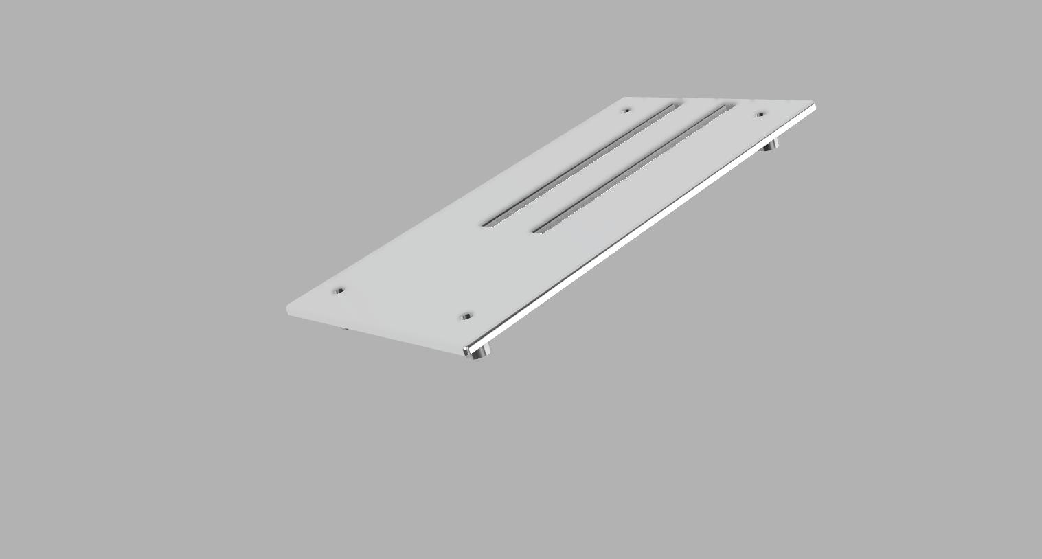

New Bipolar Boost TX and Front End

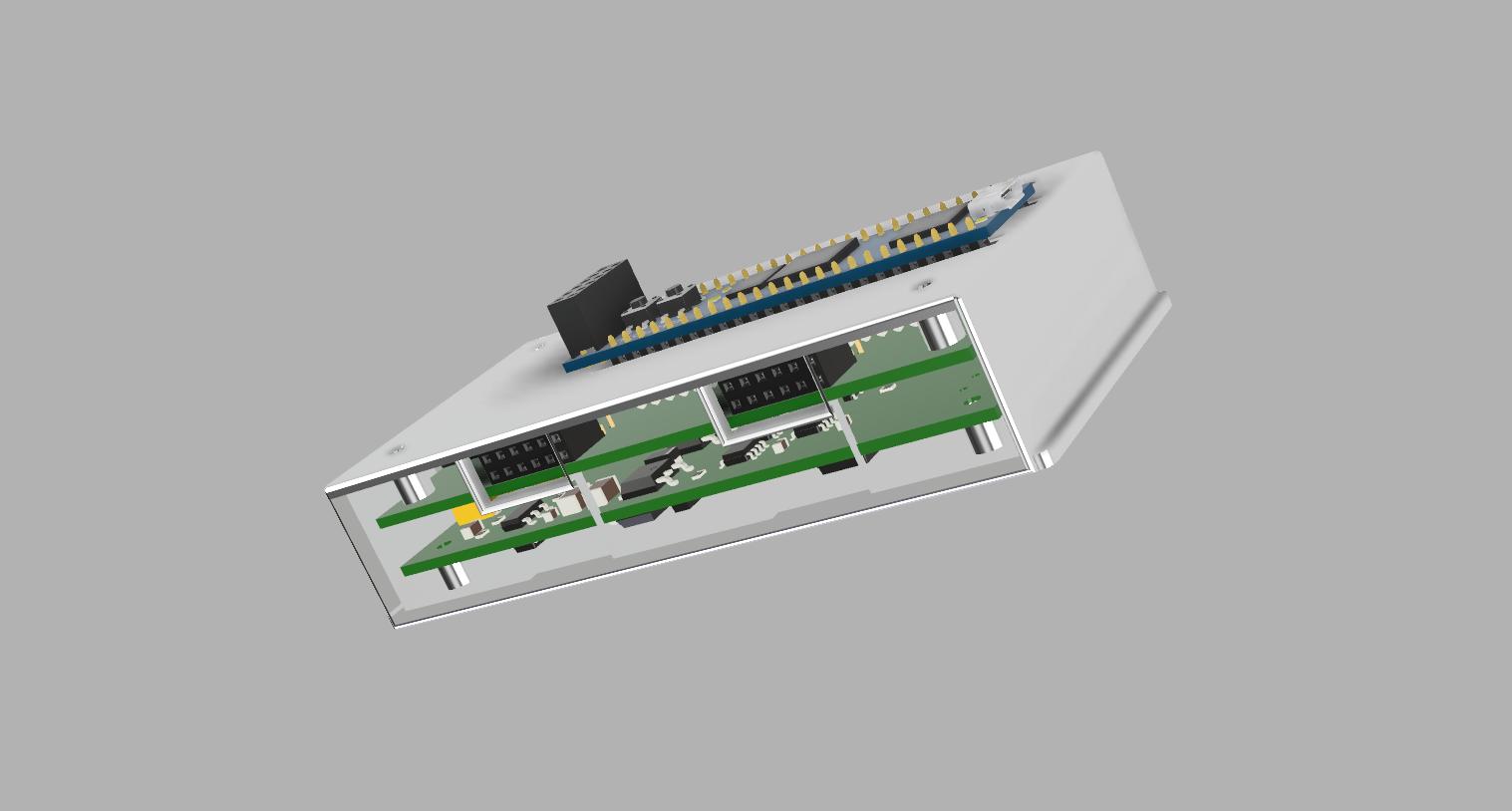

  • Added 6 mm pillars to lid and base, another 4 x 6 mm hex spacers will be required between IF and TX boards.
    Finished height of enclosure can be adjusted to suit the 4 inductors which I have yet to check, may require another 2 mm but its a easy adjustment
Name:	KingJL_Bipolar_TX_Sub_enclosure v20_lid.jpg
Name:	KingJL_Bipolar_TX_Sub_enclosure v20_base.jpg
Name:	KingJL_Bipolar_TX_Sub_enclosure v20_lidpcb.jpg

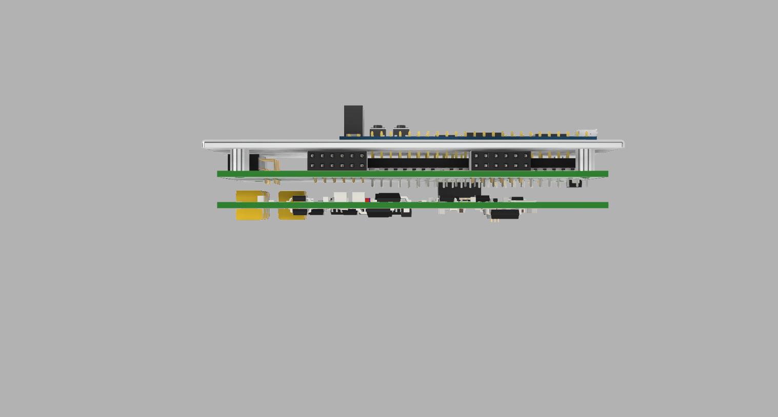

    Last picture shows cut-away view
Name:	KingJL_Bipolar_TX_Sub_enclosure v20_cut.jpg

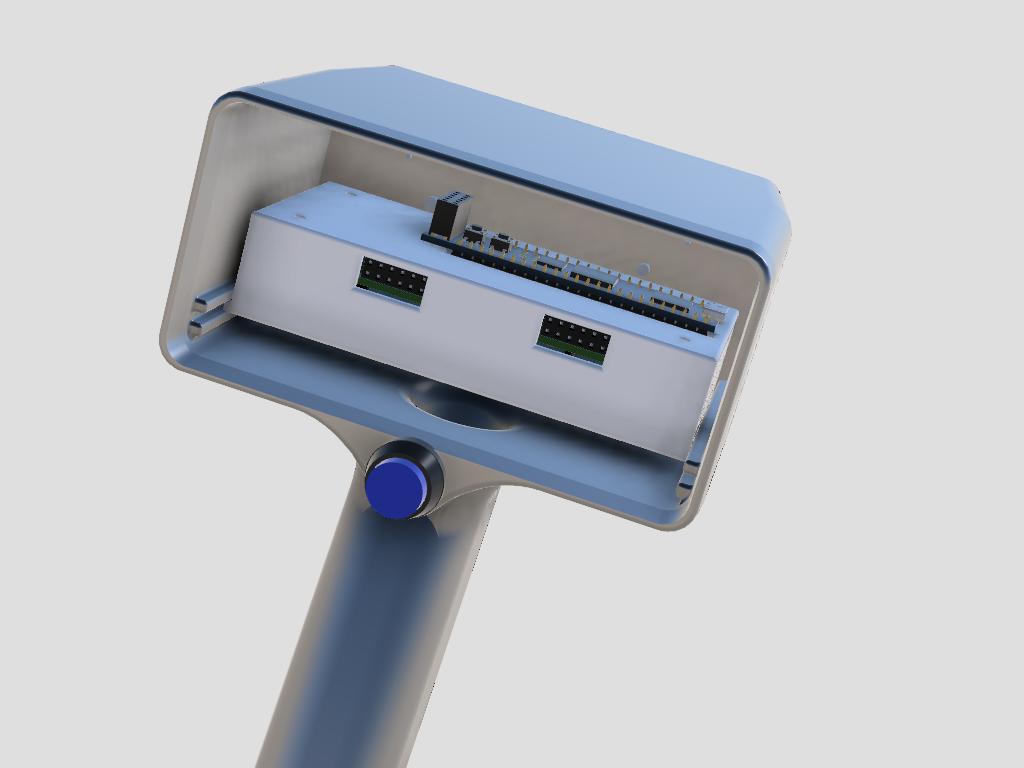

    • Originally posted by Mdtoday View Post
      JL, is this the sort of sub-enclosure you were thinking of?
      [ATTACH]47038[/ATTACH] [ATTACH]47039[/ATTACH] [ATTACH]47040[/ATTACH]
      3D printing/nickel sprayed on inside for shielding
      It is designed with small flanges which will slide into ribs on side wall of main enclosure.
      PCBs held in place with spacers and screws through bottom of sub-enclosure then into small pillars on lid.
      Not sure if you wanted A7 inside enclosure, this can be adjusted easily.
      Bits and pieces like supports for power supply boards can be added if required.
      cheers
      Mdtoday
      Looking good! I think I would prefer the nickel sprayed on the outside. That way I can use fabric emi tape to seal edges and easily attach grounding wire... but that is minor. It doesn't affect the sub-enclosure, but when I get the parts in, I will fabricate the probe switch sub board, to get an idea of the location issues.
        Thanks and yes, that's a good point about spraying the nickel on the outside.
        What I have to do is locate the holes for power and signal wires from TX board, they can be drilled but its better to add in if we can, when its gets close to that time just let me know preferences and I'll finish it off.
        Do you have a 3D printer JL ? If not I'll print some off and send when required.

          I like it... I like it! Last year I picked this kit up for my projects... in fact I am using them now to provide support the board assembly for testing. You might be able to use one of the 6mm spacers from the kit. I forgot to add them when I did the PCB layout, but I had intended to put 3 through hole pads (2 on the opposite edge from the connector and 1 on the connector edge but away from the connector) on both boards so that solid wire could be soldered between the boards, providing support for the two boards... again somewhat like the Vallon. I hate to keep referring to the Vallon, but they did a lot of things right!
              [ATTACH]47041[/ATTACH]
              [ATTACH]47042[/ATTACH]
              [ATTACH]47043[/ATTACH]
              [ATTACH]47044[/ATTACH]
              cheers
              Mdtoday
              Are the offsets under the Pmod openings needed? I think that they could interfere with getting good Pmod connection.
                That's a good kit, thanks for the heads up, great value.
                Yes, the Vallon is a well thought out detector, I rebuilt my unit so had the chance to check everything out as I went.
                The angle of the the main enclosure/arm I have been working on was based on the Vallon as I found it quite comfortable.
                  Not required, I allowed 1 mm clearance around the board edges and when I did the extrude then the opening cuts, it has picked up one of the construction lines in the drawing, I will fix that up tonight along with a few other bits and pieces.
                  Once I get the PMOD modules I will double check on fitment and clearance to be sure its all good.
                  Let me know if you spot anything else that looks odd or you would like to change

                    • JL, is the A7 module going to be plugged into a socket on the IF board?
                      I assumed it was and designed enclosure accordingly but thought I would get a sanity check on that one.
                      Also, I have removed those offsets in the side walls.
Name:	KingJL_Bipolar_TX_Sub_enclosure v23_offset_removed.jpg
                        Not really, I allowed 1 mm clearance around the board edges and when I did the extrude then the opening cuts, it has picked up one of the construction lines in the drawing, I will fix that up along with a few other bits and pieces.
                        I like the way it is turning out... I especially like the way it is working out with the A7 plugin. I populated the I/F board with the 48 pin IC socket and was not pleased with the gap between the socket and the A7 board, so I populated an I/F board with two 24 pin singe row header sockets. It gave protection to the 48 pins, but stands a little high by my standards. The sub-enclosure that you designed takes care of that problem and I can use the 48 pin IC socket as planned.
                        I plan on using 2 pin female, 100 mil pitch, connectors on each of the coil wire sets (TX and RX) and a 3 pin female (again 100 mil pitch) for the 5V, 20V, and GND. That way it will be easy to attach extensions if needed when having to lay the unit out for troubleshooting. A hole, to facilitate ref voltage adjustment, will be required on the bottom (or top depending on your perspective).
                          I assumed it was and designed enclosure accordingly but thought I would get a sanity check on that one...
                          Yes, you assumed correctly. Looking good!
                            Yes, it's looking good, thanks for the info on your plans for the wiring, I will add the hole for Ref adjustment pot and perhaps I'll leave the position of the wire exit hole until last but it looks like being on the rear almost in line with the TX PCB wire solder pad row as the enclosure will be a slide fit with maybe 1-2 mm gap between it and main enclosure wall.
                            I'll play around with both enclosure models and come up with best fit.

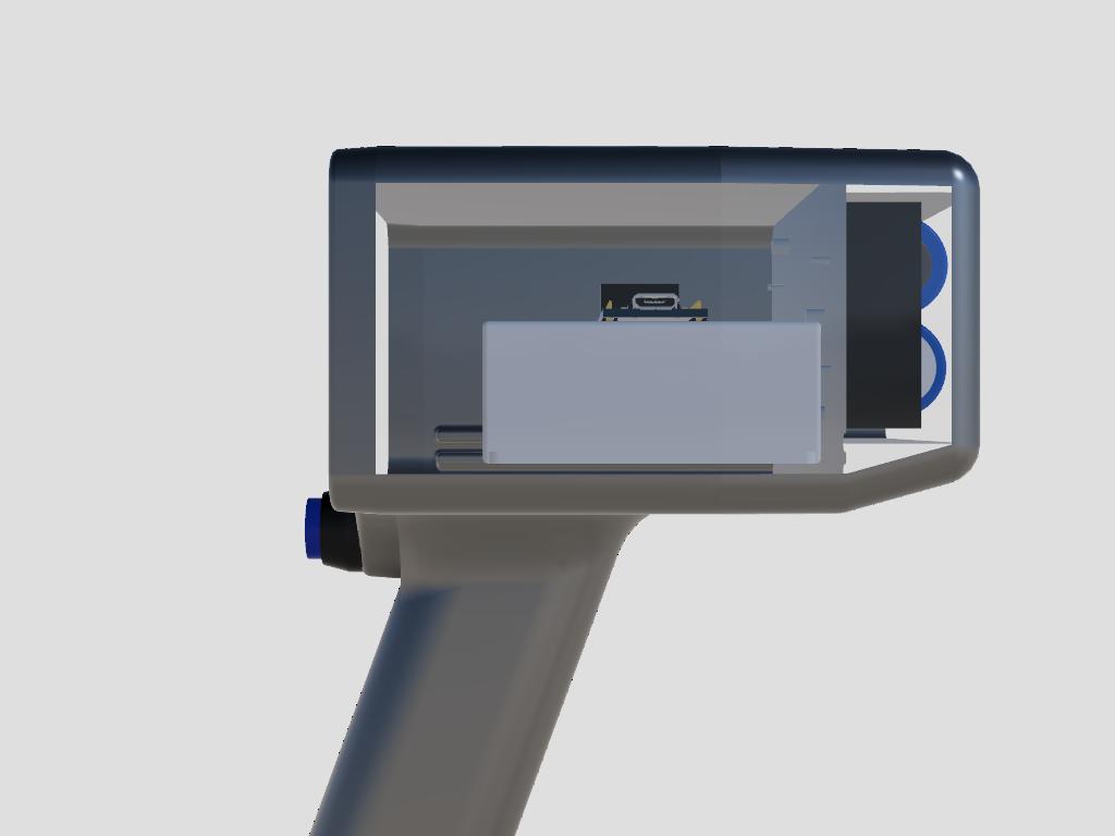

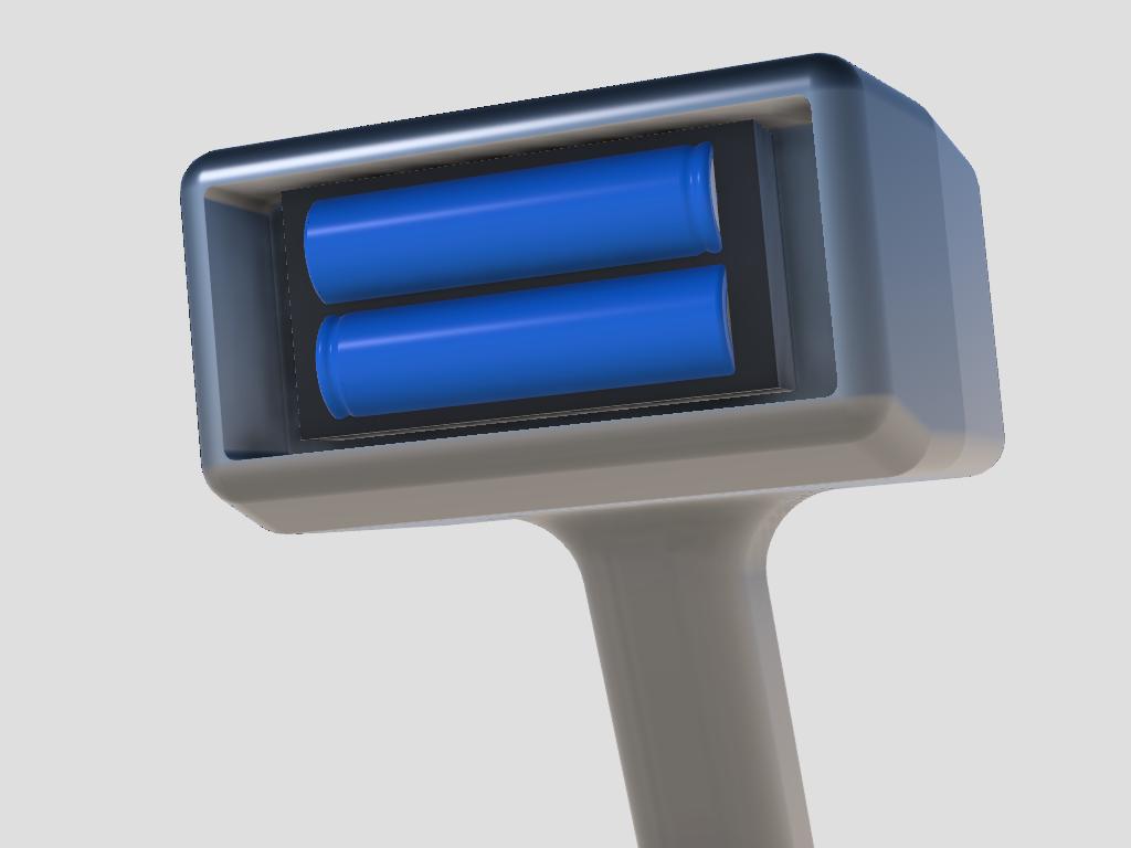

                            • I have been modifying the two enclosures to fit, now working on front and rear panels, adding pillars and ribs to secure front and rear panels.
                              The main enclosure size has been increased to 60mm H x 112mm W x 102mm D although this can now be easily changed as required.
                              Distance between back of front panel and the front of the sub enclosure is 17mm.
                              Battery bay wall is 3mm thick

                              Once that is done, I will fine tune them for 3D printing and post some measurements.

                                Looking great!! If there is any suggested changes to my direction... please voice them. I do not have a NIH complex!!
