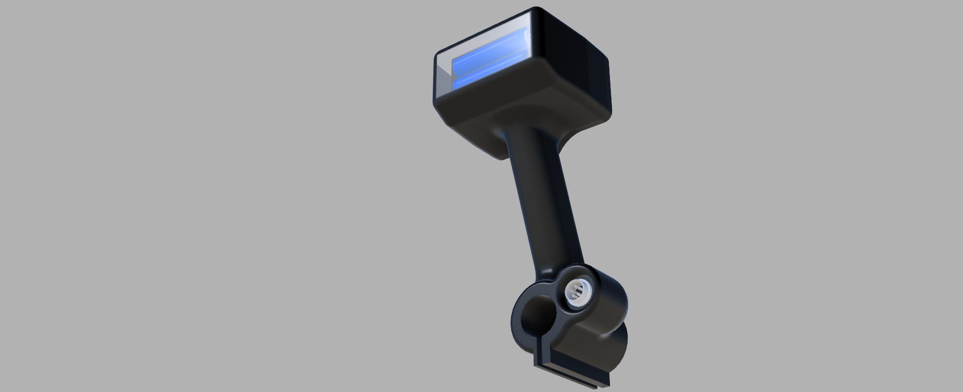

      The draft design I posted earlier was designed to carry the PCBs in the vertical plane and accommodates a rear accessed bay for 2 x 18650 batteries. So all electronics mounted in the head.
      Not shown on the drawing is the addition of the coil connector which is mounted rear facing at the base and on the side of the shaft clamp, a tear drop bump (I will post the updated models).
      The internal coil cable runs up through the handle and is soldered directly to the PCB, it is unusual but effective as the coil connector is right next to the shaft.
      There is another part to this enclosure design and that is the stand which will either be integral or a snap on, it is still to be decided.

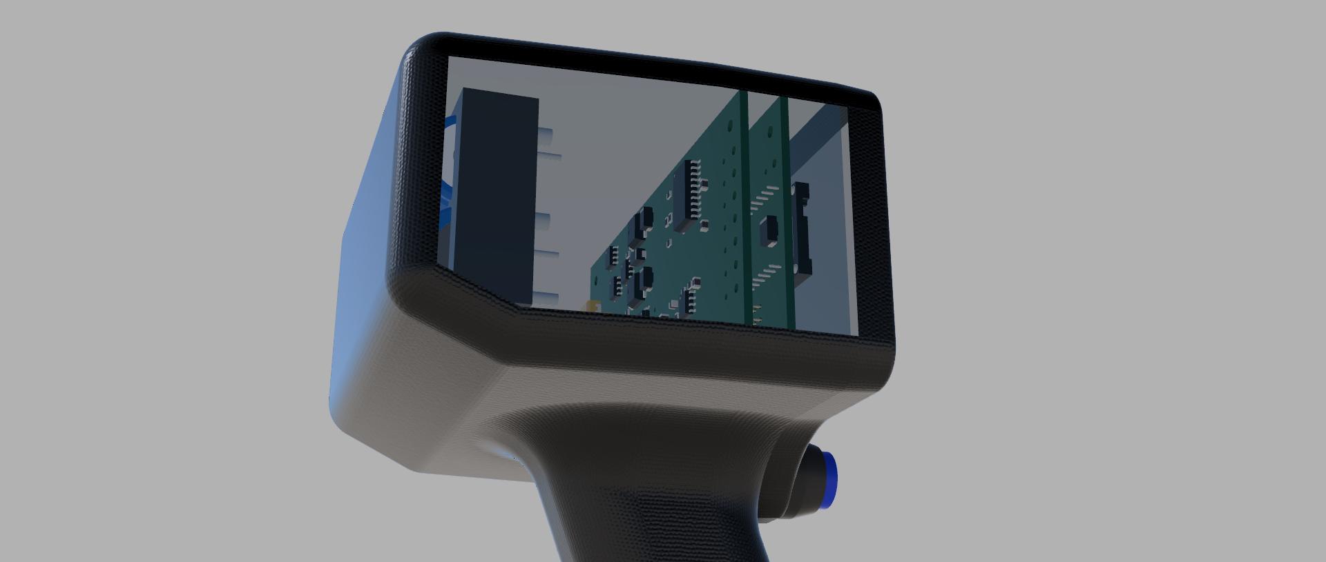

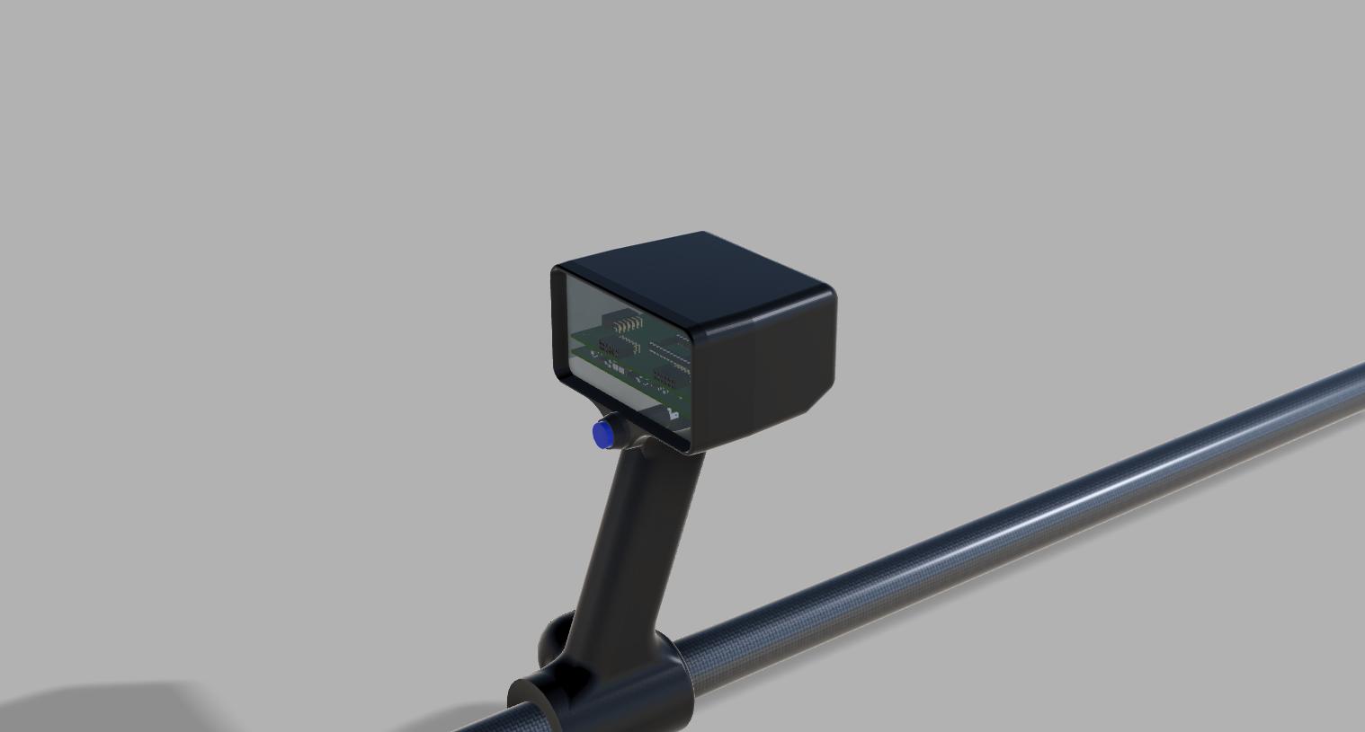

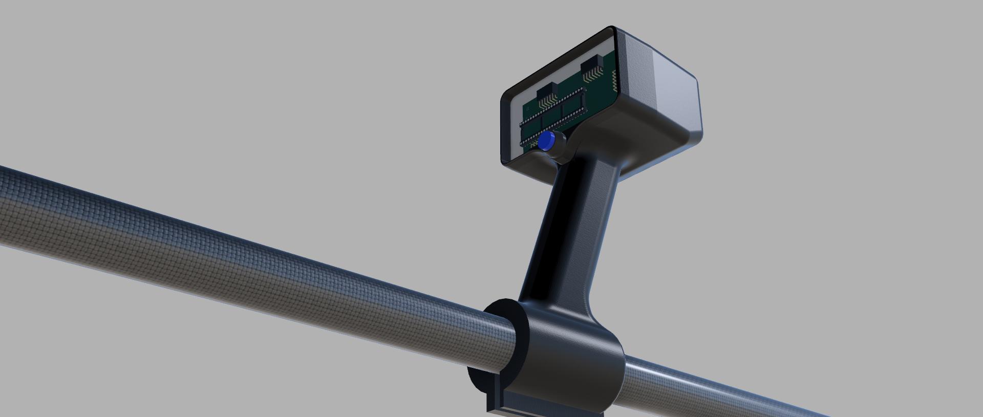

                I have been working on both enclosure designs using manufacturers 3D models and comparing with the real parts and they match quite well, this is the way I normally start enclosure designs. Also I set up parametric tables for the actual enclosure measurements and can change most things without having to redo the whole design, saves a lot of work.
                I'll finish off this attached design then revert back to the rectangular one and finish that off when the OLED module arrives in 2 or 3 days.
                The following pictures show the general idea with all of the mounting pillars and rear hatch.

                I have 3D printed a half sized version to confirm it actually prints without problems and its Ok, so next stage is to correctly position the PCB mounting pillars and add some ribs, then do a full sized test print.
                In the end I will have 2 versions for you to take a look at and decide on changes etc, I'll then either send STL files if you have a 3D printer or print a couple off and send if you would like them.

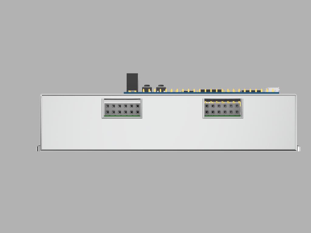

                    Here is a view of boards mounted horizontal Click image for larger version
ID:	354602 to give an idea of available space and where it will require adjustment to accommodate the shielded enclosure.

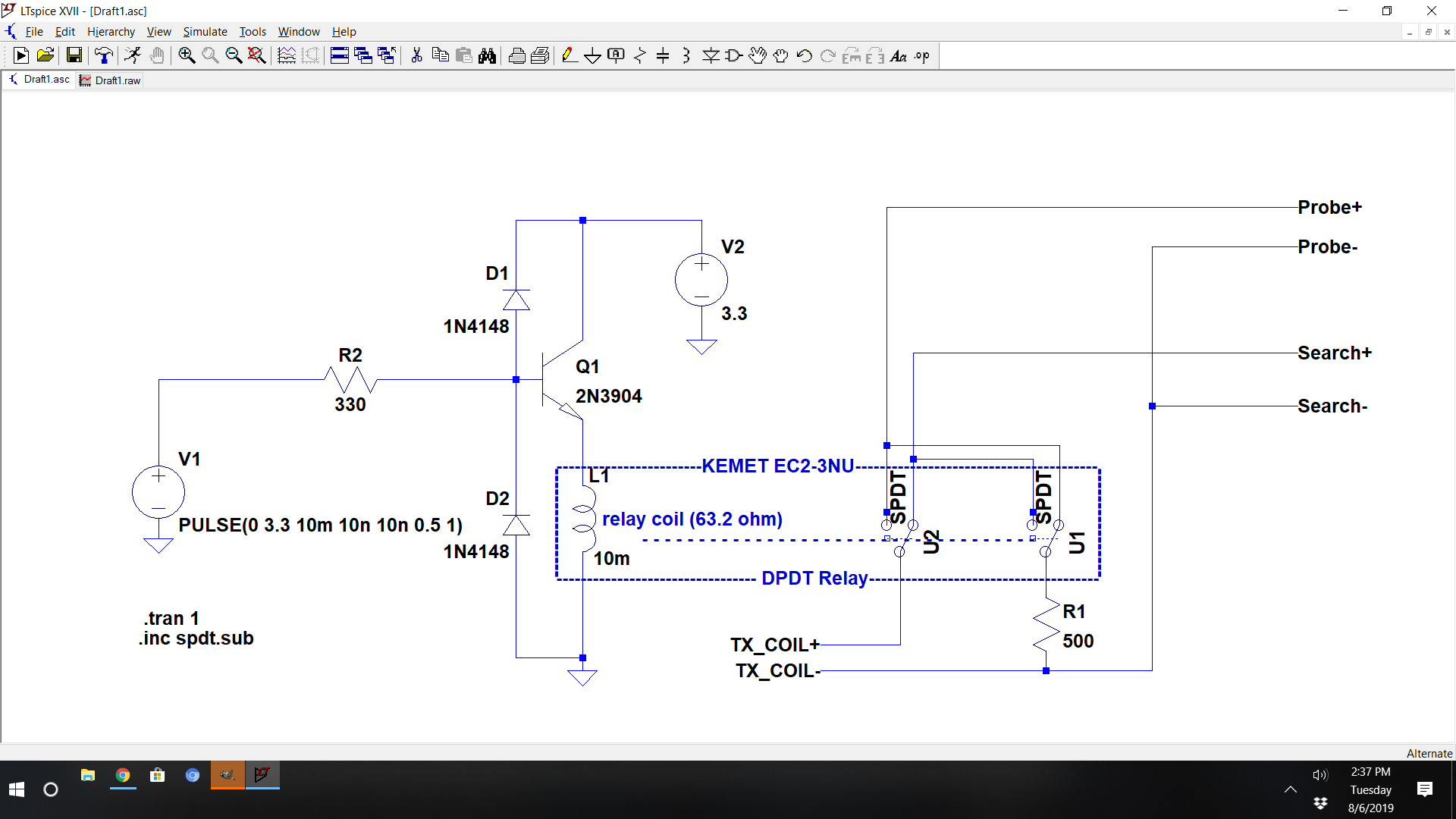

                        I have settled on the KEMET EC2-3NU. It is stocked by LCSC whereas the OMRON 3V version was not (and the OMRON cantact voltage rating was only 125V). The following circuit is the drive and connection configuration for the DPDT relay. It should provide adequate protection of the FPGA from transients in case of a relay malfunction. I have used this coil connection configuration in the Vallon with a DPDT manual 3 position switch.
Name:	Coil Switch.png
                          Looks good JL, nice neat little circuit, thanks for sharing.

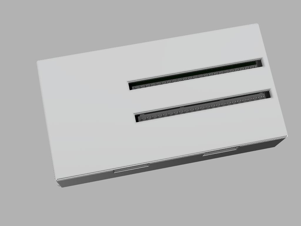

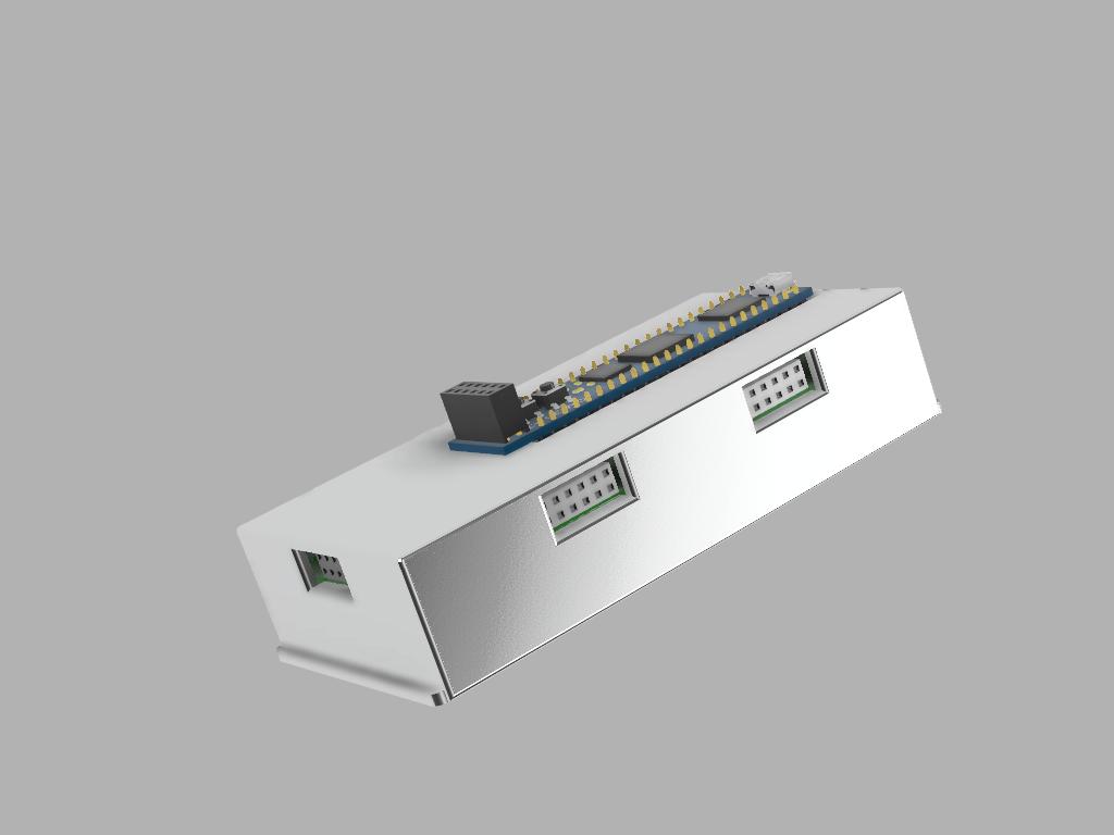

                              • JL, is this the sort of sub-enclosure you were thinking of?
ID:	354604 Click image for larger version
ID:	354605 Click image for larger version
                                3D printing/nickel sprayed on inside for shielding
                                It is designed with small flanges which will slide into ribs on side wall of main enclosure.
                                PCBs held in place with spacers and screws through bottom of sub-enclosure then into small pillars on lid.
                                Not sure if you wanted A7 inside enclosure, this can be adjusted easily.
                                Bits and pieces like supports for power supply boards can be added if required.
