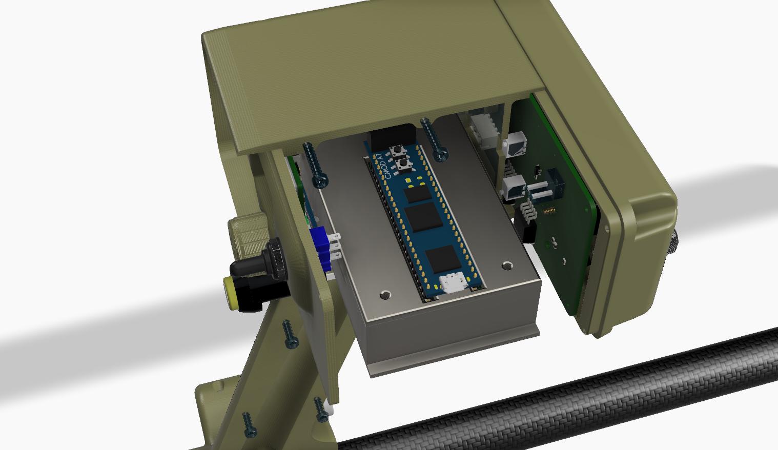

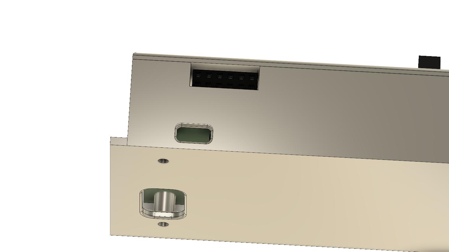

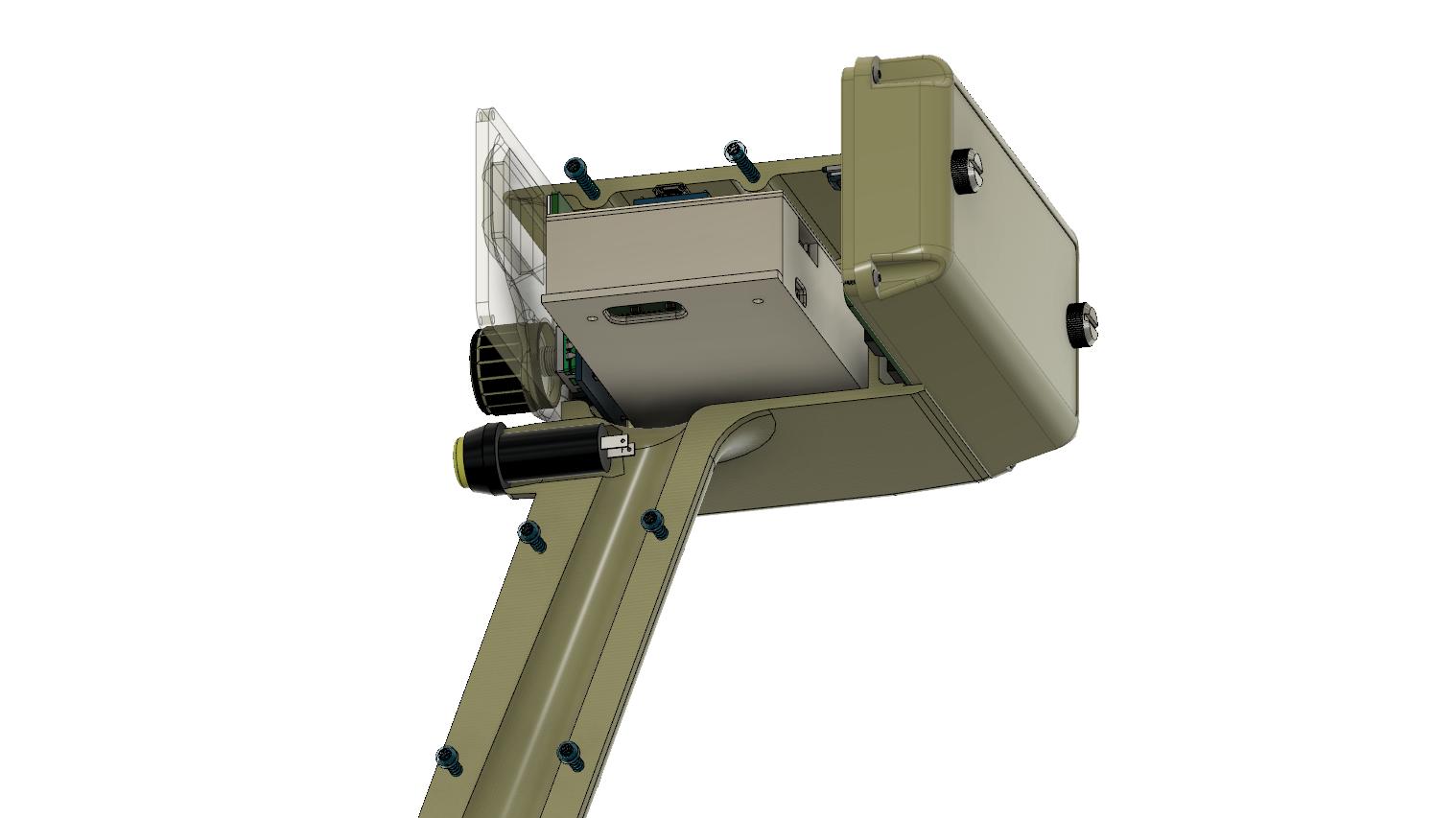

                  • Added cut-outs for TX/RX cable(s) on bottom side of electronics enclosure and one opening on the back side for power.
                    The TX /RX is routed directly down through the handle .
                    The +20, +5 and GND is routed to power supply on back panel.

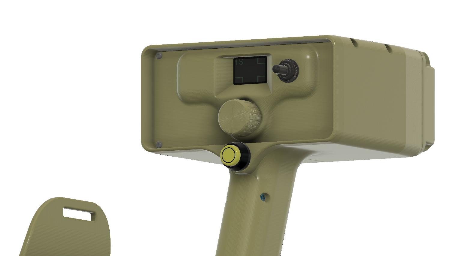

                    • Positioned and added hole on front panel for power toggle switch.
                      Up out the way with a clear routing path to the 2 pin connector on power module and in a position that won't get in the way of encoder usage
