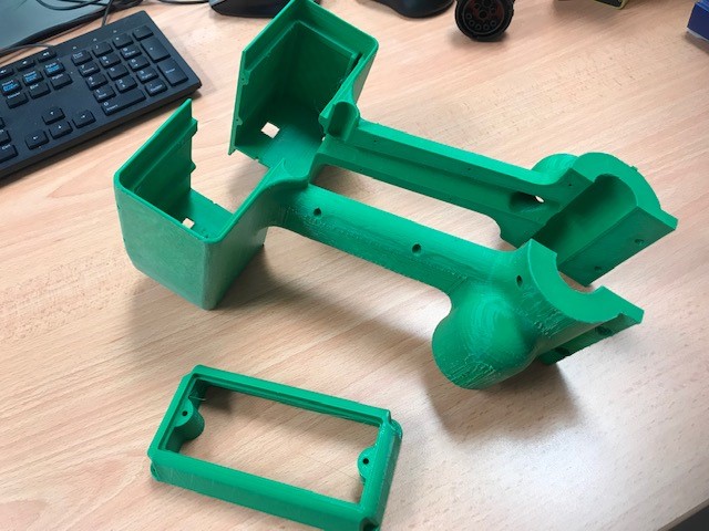

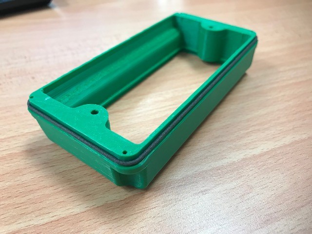

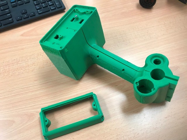

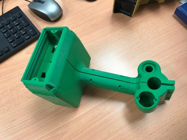

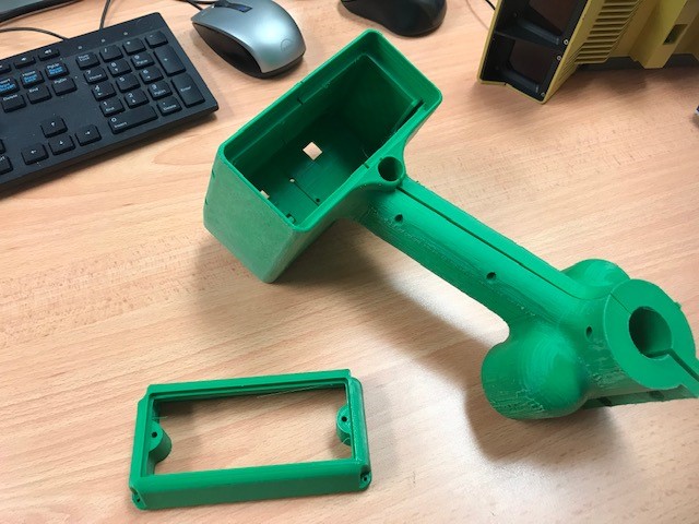

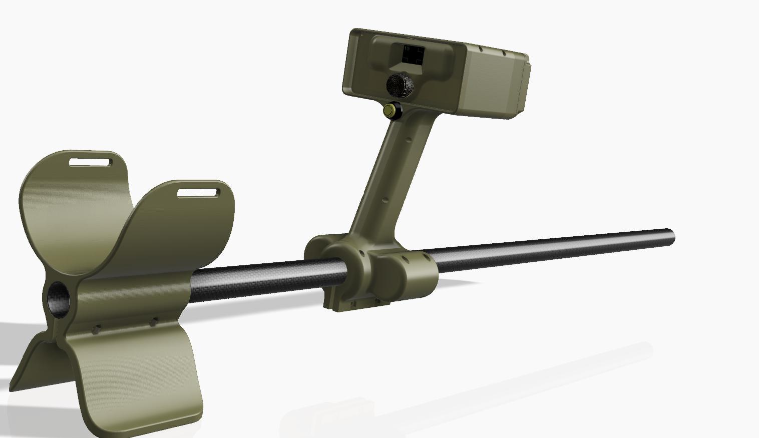

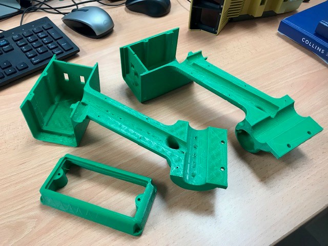

    Thanks JL, it was at the stage where I needed to take a break and physically see the overall design full size, so I can review placements.
    3D CAD is brilliant with close tolerances and is repeatable and reliable but a 3D printed part this size and shape can shrink in unexpected places, therefore I wanted to allow for that in the final run home and using the production filament.
    The green used on the draft prints wont be the final colour
    • First draft prints of the main enclosure.
      Left side was printed with .4mm outer shell so it's very rough, right side has .8mm shell much better but final prints will be 1.6mm shell.
      Already, I see some necessary changes but generally, I am happy with it. Print time was around 15 hours for each side.
      Mounting screw hole positions will be moved a little to give more material around them and a few other bits and pieces to tidy up.
      Coil and probe connector housing areas will be modified to one standard fit with a vertical split down the centre of each to form left and right "covers", more on that later.

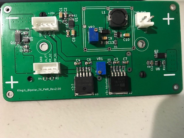

              • More progress on power supply board.
                All works fine, much quieter layout. Click image for larger version
                The only small issue is the output voltage connector pin assignments.
                I should have placed the GND alongside the 20v output instead of the 5v line, no big deal but would have been better option.
                Just have to be careful when testing.. I might add a transzorb on top side between 5v track and ground, this won't require a new board and will protect the 5v line from over-voltage

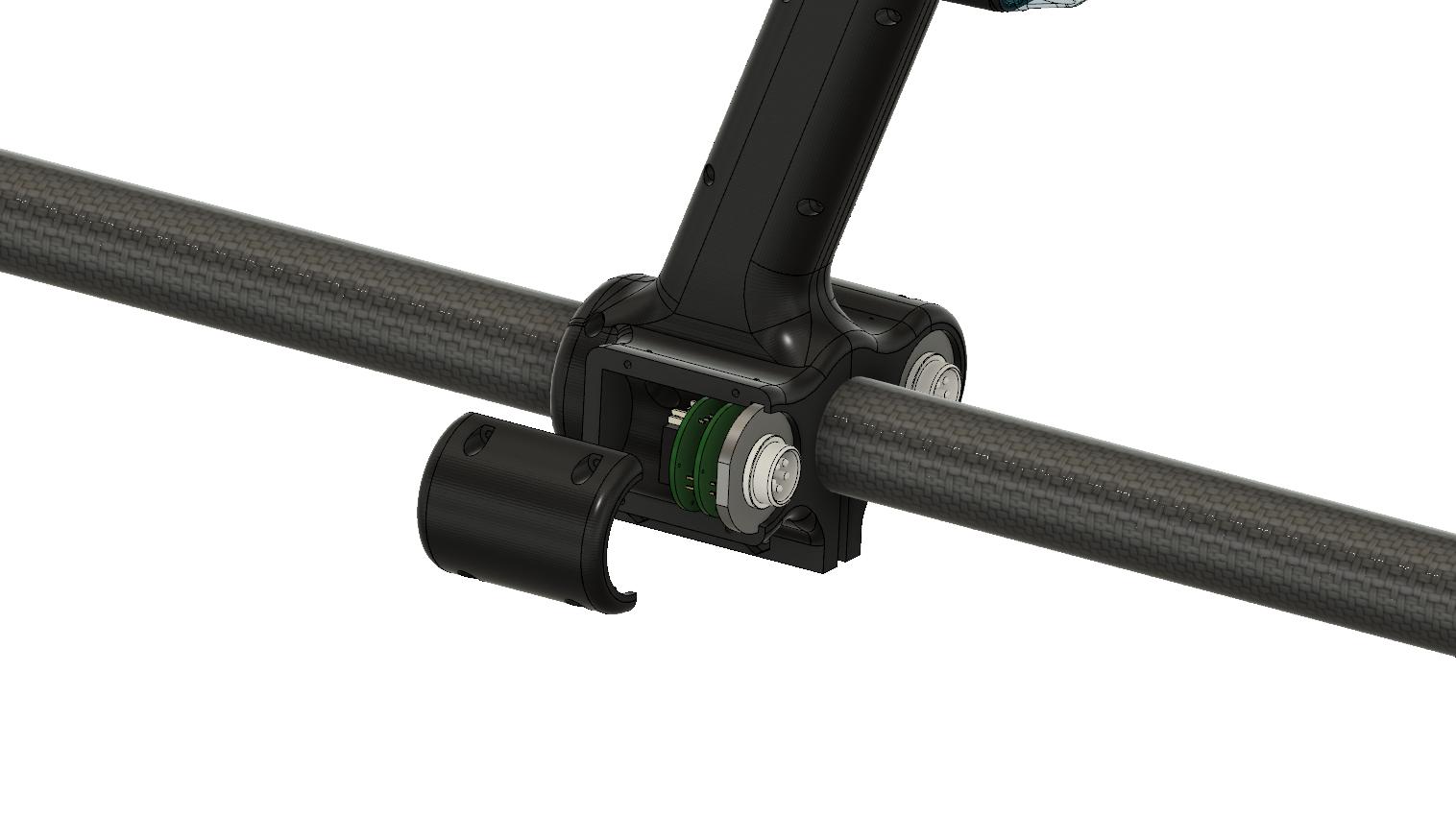

                • On to the Coil/Probe connector bay mods to main enclosure.
                  Screw on covers which will also enable easy add-on in place of the dome shaped cover if required
Name:	KingJL_Encl_Coil_ mod_200919 v11.jpg
                  This mod also enables better access and assembly and fixes another issue I noticed with the actual printed part...the push button position and handle length were designed to present a comfortable height for pressing with the thumb but when adding the original coil connector housings, they were positioned too high on the base which meant an uncomfortable bend of the thumb and a loosened grip on the detector....not a good thing.
                  I lowered the connector housings by 15 mm which fixed the issue.
                  It may be a small thing but it's at a stage when we can get it right and when one swings a detector for hours on end, comfort is high on the agenda.

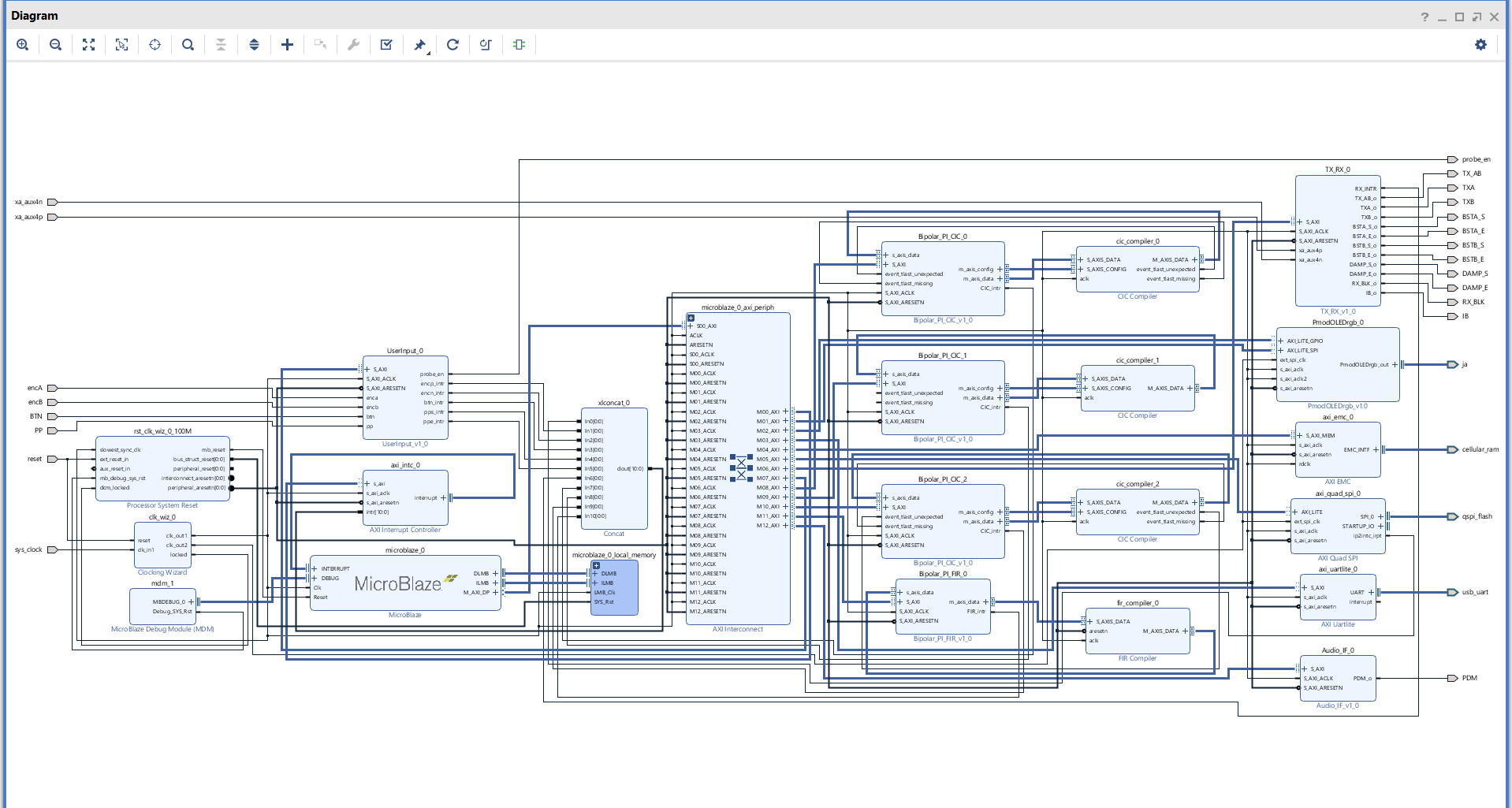

                      Well, back home and added the last FPGA hardware definition module... the audio interface. The Audio_IF module produces a 1 MHz based Pulse Density Modulated (PDM) signal whose filtered output audio frequency is controlled by the value of a Frequency Control Word (PCW). The FCW value is determined by the formula FCW = F/CLK*(2**ACCUM_LEN) where F = desired audio frequency, CLK = 100 MHz, and ACCUM_LEN = 29. I have included a spreadsheet (FCW Calculator.xlsm), that will calculate the FCW for a given audio frequency, in the Audio_IF sub directory of the project archive. Originally, I was using the 100 MHz clock to cock the PDM output, but decided to reduce the clock to 1 MHz as 100 MHz was above the practical limits for driving the VCMOS33 outputs of the FPGA. Using 1 MHz the unwanted spectrum of the PDM output should still be easily filtered out using a simple RC low-pass filter with a cutoff frequency of ~ 13 KHz.
                      The current Bipolar_PI block desgn:
Name:	Bipolar PI Design.png
                      The current change log:
                      Change Log.txt
                      The current project archive is Vivado_Bipolar_PI(9-26-2019).zip
                      Except for correcting any errors in the hardware design, the focus from this point forward will be the software to control and process the outputs of the Bipolar PI hardware definition. The initial software development will be the Bipolar initializing sequence (TX/RX parameters, pre-amp offset calibration, damp start timing, S1, S2 and S3 no-target (TX coil decay) determination, S1, S2, and S3 ground (coil decay + ground signal) determination, S1 vs. ground ratio and S2 vs. ground ratio calculation). A lot of this has already been done while developing the verification code for the various FPGA hardware modules. Next will be the completion of the menu system, making all menus interrupt driven (only in the menu processing code in response to an interrupt so as to not interfere with normal signal processing when in the menu system). And finally the code to effect the RX target signal processing.

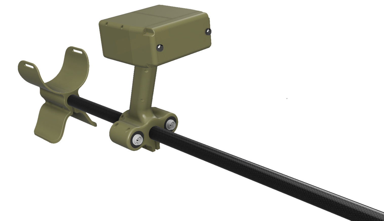

                        On the enclosure, I designed an arm rest just in case.. Click image for larger version
ID:	355107 Click image for larger version
ID:	355108 there is a lot of strength in this one and weighs in at 110 grams.
                        also the colour of the parts is very close to what I use but let me know your preference.

                          On the enclosure, I designed an arm rest just in case.. [ATTACH]47638[/ATTACH] [ATTACH]47639[/ATTACH] there is a lot of strength in this one and weighs in at 110 grams.
                          I cannot open the attachments... I get the following message ..."Invalid Attachment specified. If you followed a valid link, please notify the administrator".
                            Links are working now. Arm rest looks great!
