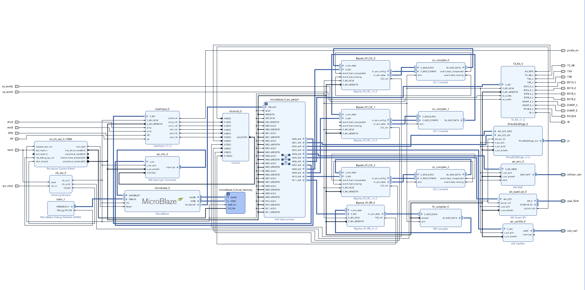

          Implemented and integrated the FIR finishing filter peripheral. The FIR filter is implemented as a 1 channel FIR with 2 parallel paths for S1 and S2. Changed the debug printouts within the main() while(1) loop to print the notification of the interrupts and the corresponding filter output values for the filter interrupts.
          Only one hardware peripheral definition left to design/integrate... the audio peripheral.
          The current Bipolar PI design:
Name:	Bipolar PI Design.png

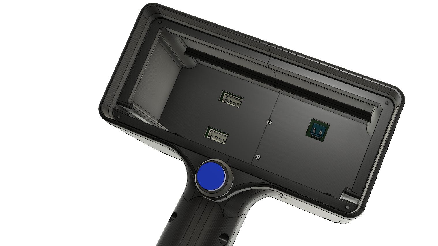

                          • While waiting for Power boards to arrive, I have returned to the enclosure design and modified the mountings to suit the new board.
                            There is now access to adjustment pots and the 3 connectors (power outputs, power switch and probe)
                            Once the positions are verified with all the actual parts / board/ assemblies to be fitted, I will then de-construct the enclosure design, reduce the design weight and slice into all the printable sections.
                            The main enclosure can be printed in 2 halves at the same time but the print time is too extreme for me. I like to keep each print run time to no more than 24 hours so I can keep an eye on things and maintain the printer in between runs.

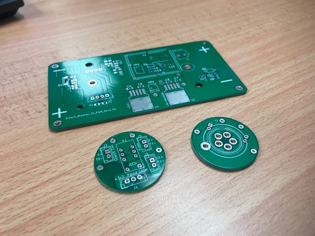

                            • Progress on the hardware.
                              Rev 2.00 Power and Probe switch boards arrived this morning, so I will load them later today and test.

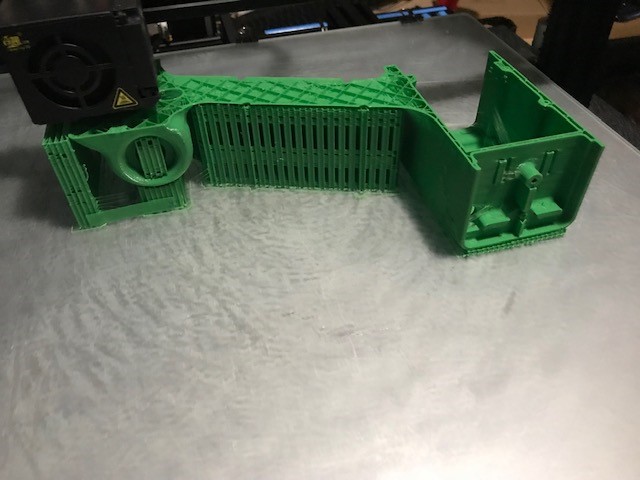

                              Started the first full size draft print of the main enclosure Click image for larger version
ID:	354954 11hrs into a 15hr print.
                              I'll start the other side tonight
