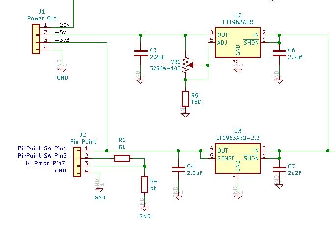

        Since we no longer require the 3.3V supply to the interface board, can the 3.3V supply on the the PS/battery board be reconfigured to supply the 5V for the Nextion display?

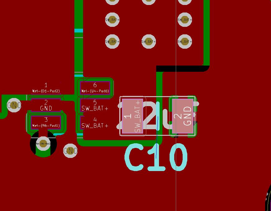

        In your original testing of the PS, what was the actual current limit for the 20V? What would be your thoughts on disabling the boost regulator during the first 80 usec of the RX period. I am thinking we can do away with our S3 sample and accomplish everything we need with S0 (2 us after damp & RX unblock), S1 (15 usec after TX off), and S2 (30 usec after S1 or in this case 45 usec).

          Yes, the 3.3v reg can be replaced with a 5v version for the Nextion supply, great idea.
          The original 20v PS testing load was 150mA which is the max output limit for the post regulator.
          I had included an extra footprint to allow for another output capacitor on the 20v switch mode supply and we should be able to carefully lift pin 4 (enable) of the MT3608 for testing as isolating pin 4 by cutting tracks would be difficult as it is on a large fill zone.

          Like the idea of disabling the boost though, I think it will work.
            Do you want to follow through and test that feasibility or do you want me to do it?

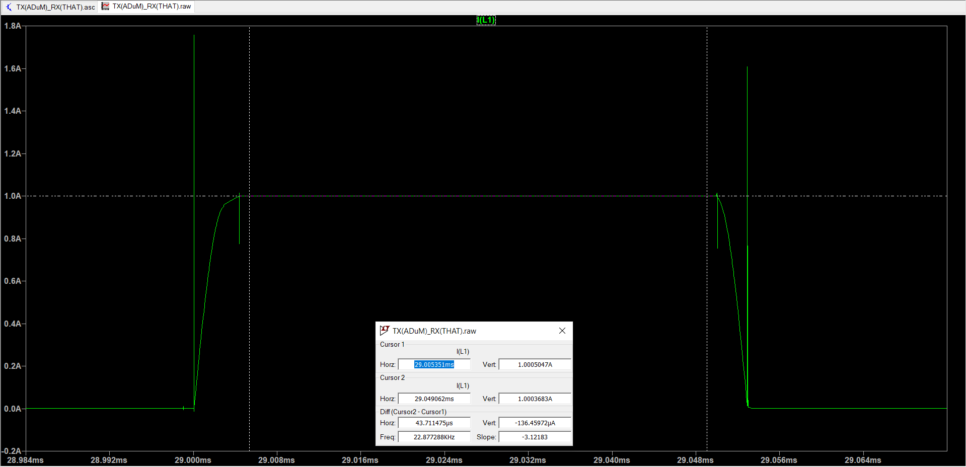

              Now the leading edge TX current can be fine tuned by the kw ( boost width) timing parameter and the max TX current can be tweaked with the +5V ( Vcc parameter). Max TX current course tuning is by R14 in the sim (R6, R7, R8, R10 in the actual circuit). This will easily translate into the actual hardware setting/parameters.
              For example, the TX(ADuM)_RX(THAT) simulation as was delivered in the last zip and : R14=1.55, Vcc=5.026, kw=4.32u, dw=2.87u, and the ".option Gmin=1e-010" commented (using the Control Panel Spice default of 1e-012) results in the following waveform taken at around the 29 ms mark.

              I don't think that for practical purposes, you can get much more flatter/balance than that!
                    yes, looks great

                      • On replacing the 3v reg with 5v, I thought that family of LDO devices had a 5v version....they don't but I think I have found a replacement for the current PS board.
                        We can always up-rev the board once everything is tested and settled.
                        Just noticed too, that we need to change values of the PP input voltage divider resistors as they are tied to 3v3 rail at connector, maybe a zener to replace R4?...or just change R value
                          I am not sure we need to quite do that any longer... as we are using the Nextion gpio pin interface for PP now. I think you have interfaced a PP push button switch to the Nextion gpio in other projects... we can do it the same way!

                              I have also identified a few linear 5v regs we can use, they have an error flag output on pin 5 in place of sense input so we can leave it floating or snip off the lead for testing on current pcb. Microchip/TI have similar.
                              http://ww1.microchip.com/downloads/e...S20005685B.pdf
                              Next rev board we can use sot-223 lower current devices
