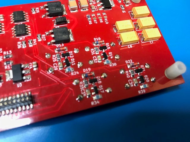

        I did some checking also... it appears that if the zener of the driver circuit (D13 for theBoost_A_G) is reversed, it will cause this condition also.
        In fact, it very closely follows your condition!
        Wow, yes it does look very much like it... Checked the board again just now and they are mounted the right way.
Name:	Zener orientation.jpg
        Checked zener action and the markings are correct.
        I will grab a blank board an do a continuity check on it.
        • Originally posted by Mdtoday View Post
          ... I will grab a blank board an do a continuity check on it.
          Yes, if somehow there is a short around the zener, the output changes to your condition. In fact if there is a short across the whole diode circuit, it will match your condition.
            It all looks good JL.
            I'm wondering if the BAT54s I have is not capable of driving enough current to charge the 3.3nf cap?
              With a 15V 1.5 usec pusle, the max pulse current is < 100 ma in ideal conditions (charging a 3.3n)... well under the max of 300 ma for repeitive pulse current. I don't know what it is, but something is amiss in the diode array of D11, D12, D13.
              • @Mdtoday, are the other three drive circuits acting the same?
                  Yes, all doing the same JL, which leads me to think maybe BAT54S I have loaded are suspect...I purchased Nexperia and ON semi from memory so should be fine.
                    Yes, well under the specs.

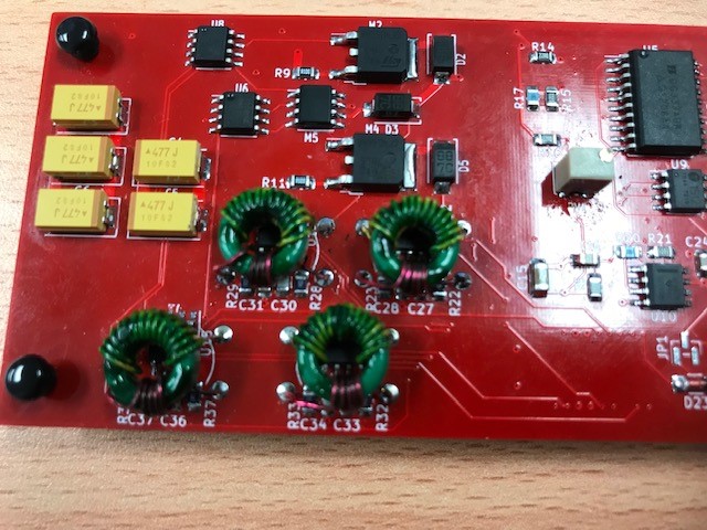

                    • @Mdtodat, Can you send me a pic of the top side of board for the Boost_A drive circuit... want to see the pulse xformer connections.
                        @JL, here is a photo, if there is not enough detail I will re-take.
Name:	Pulse transformers_1.jpg
                          [ATTACH]48467[/ATTACH]

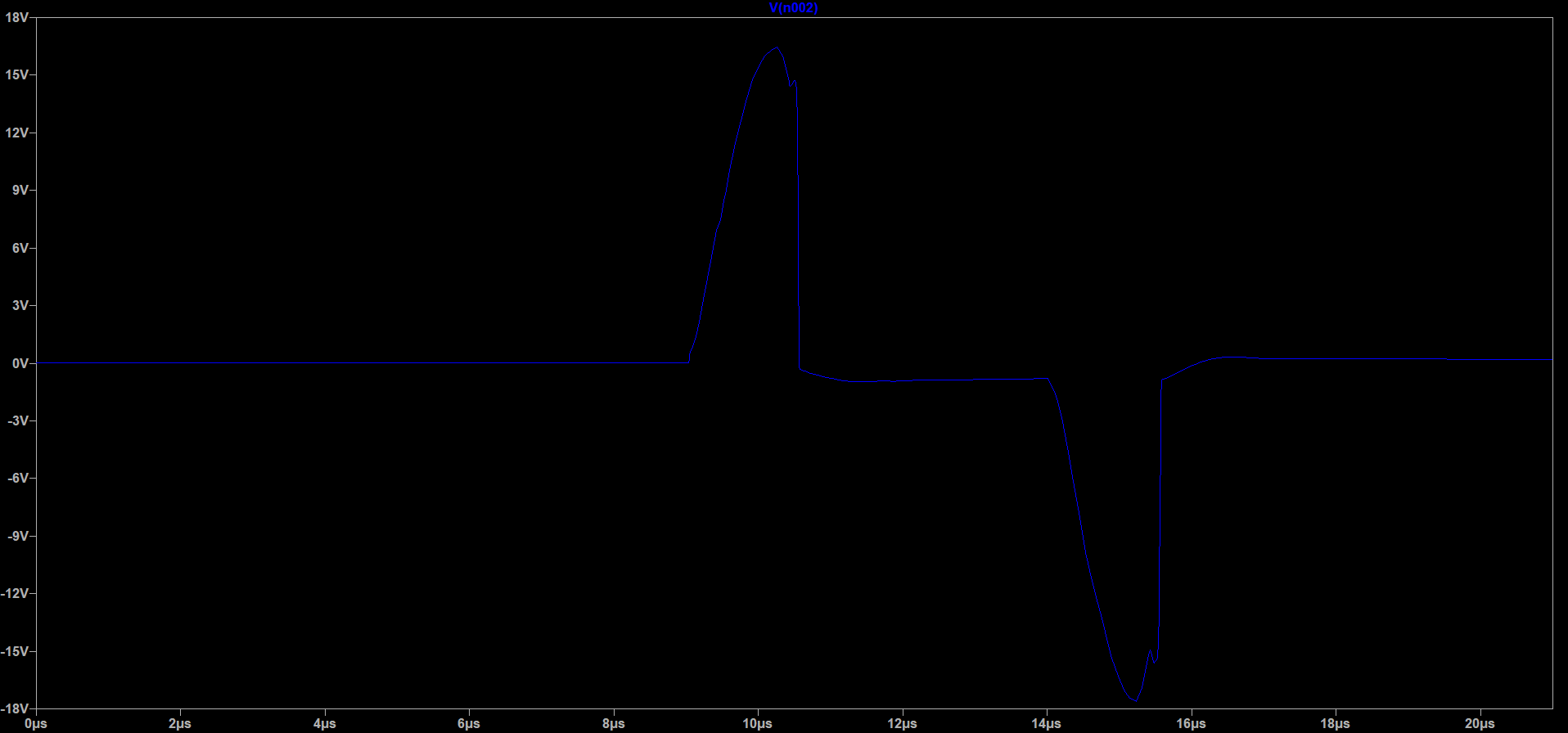

                          The pic is great... everything looks good.... Lets make sure we have a problem... The waveform pic of Boost_A_G was sampled on the Gate side of the circuit, correct? The reason i ask is if it was sampled on the secondary side of the diode array it would look like this:
Name:	Mosfet Driver4.png
                          Look familiar?
                            Look familiar?
                            Yes, that looks very familiar, trust me to pick the wrong side!
                            Thanks JL, apologies for that

                              No problem... I am somewhat relieved! Can you get a scope pick of the signal at say R27? Then we could see the actual gate drive pulse... need to insure that everything looks good and that we are back on track.
                                Ok, will set up for that shortly and post.
