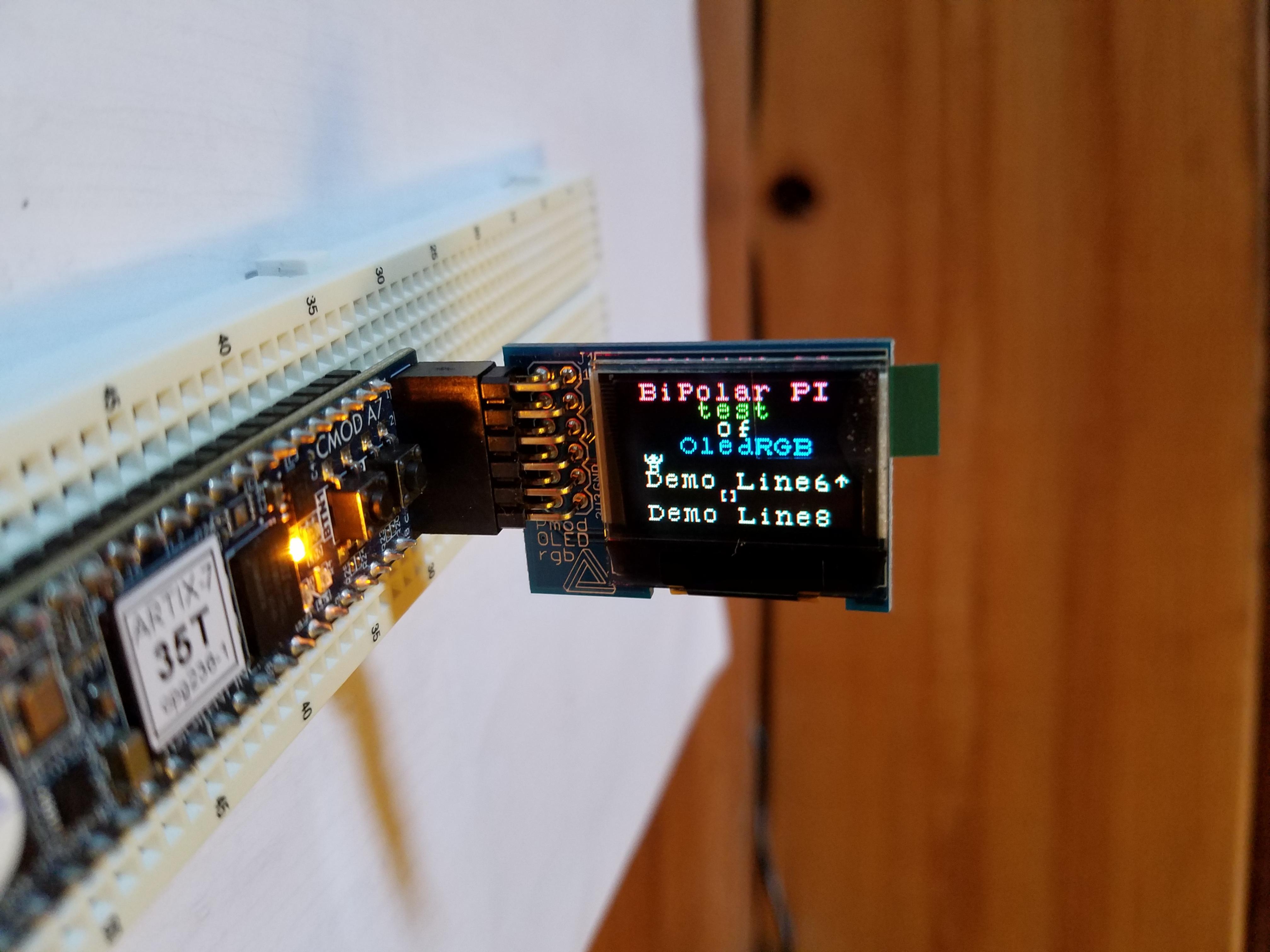

                  • RGB Graphic Display Added to microblaze embedded system
                    Successfully integrated the Diligent OLEDrgb Pmod to the system design.
                    Bipolar_PI(4).pdf
                    So far just coded a C test module to exercise the display and to verify SPI communication from the embedded processor to the actual display peripheral.

                    For the test, I integrated the Pmod module to the existing Pmod connector (JA on the CMOD-A7). In the future I will change the Pmod connector to one of the new ones that are on the interface board for the Bipolar PI project.
                    I will post a link to the updated project archive sometime in the next few days after I re-arrange the location of the library folder for the custom IP's (OLEDrgb being one of them). Currently this IP library is out side of the "Bipolar_PI" project and would cause errors for anyone just dropping and using the project archive. I want to integrate the custom IP library within the directory structure of the project.

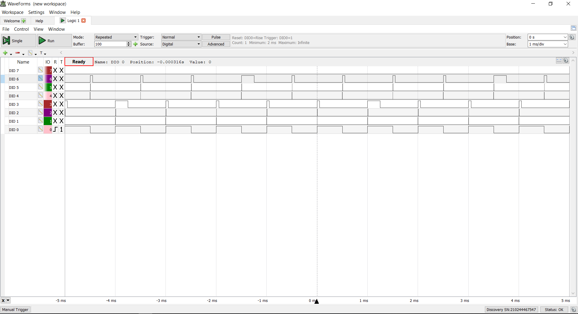

                      • Logic Analyzer Waveforms
                        A few posts back, I said I would hook the PMOD-A7 up to the logic analyzer and post a screenshot of the output. Well, today I finally got around to it.
Name:	Bipolar PI Logic out.png
                        DIO 0 is TX_A_B switch, CMOD-A7 pin 35; DIO 1 is Boost-A_s, CMOD-A7 pin 41; DIO 2 is Boost-A_e, CMOD-A7 pin 44; DIO 3 is TXA, CMOD-A7 pin 42; DIO 4 is Boost-B_s, CMOD-A7 pin 43; DIO 5 is Boost-B_e, CMOD-A7 pin 46; DIO 6 is TXB, CMOD-A7 pin 39.
                        All previous timing waveforms posted were from the FPGA programming IDE simulator... these are the real thing... the actual output from the CMOD-A7 FPGA board. All timings were spot on as measured by the logic analyzer: PRT 500 usec, PW 50 usec, MPP-PW 250 usec, boost A/B s&e signals were 1.5 usec. All this while the embedded processor is merrily dealing with OLED displays, user inputs, etc.

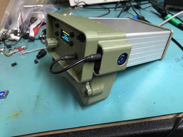

                            Yes, will take the OLED position into account for sure, I currently use them on one of my designs and it is recessed into the panel and with a raised rim around it.
                            I use the same type of BT on my detectors too, although only v4.2 but still low latency and economical and great when out in the goldfields, you can still hear surrounding noises.
                            Having used nice KOSS headphones in the past which block out most of the external sound, and startled resting kangaroos jumping up out of the bush, not hearing them and only spotting them at the last second yes, I prefer to hear whats going on around me, keep the heart rate down.
                              [ATTACH=CONFIG]46925[/ATTACH]
                              Great work and this shows the beauty of using FPGA.
