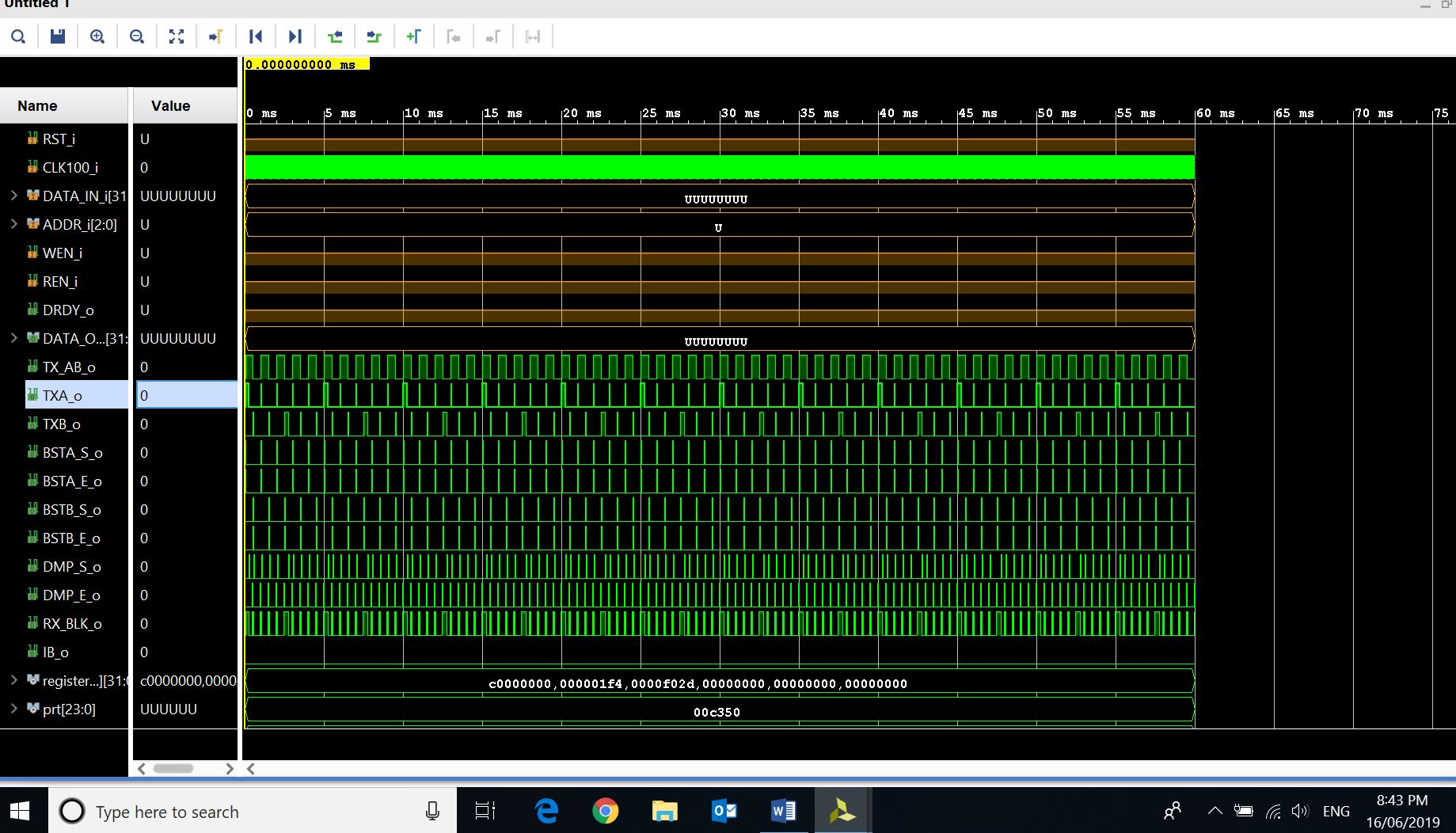

  • The simulation ran fine KingJL, nice work and thanks for sharing
    cheers

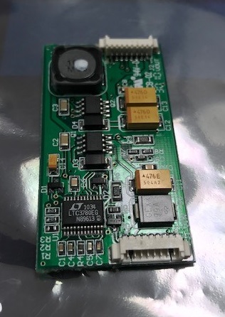

        I will be using this boardClick image for larger version
ID:	354342 I designed some time ago, its good from 4-36v @ 4A protected, I have quite a few of them built , so will make up a rig for testing using a couple of them.

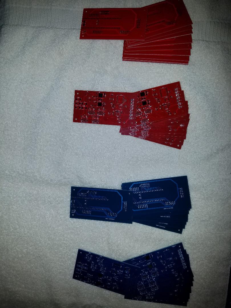

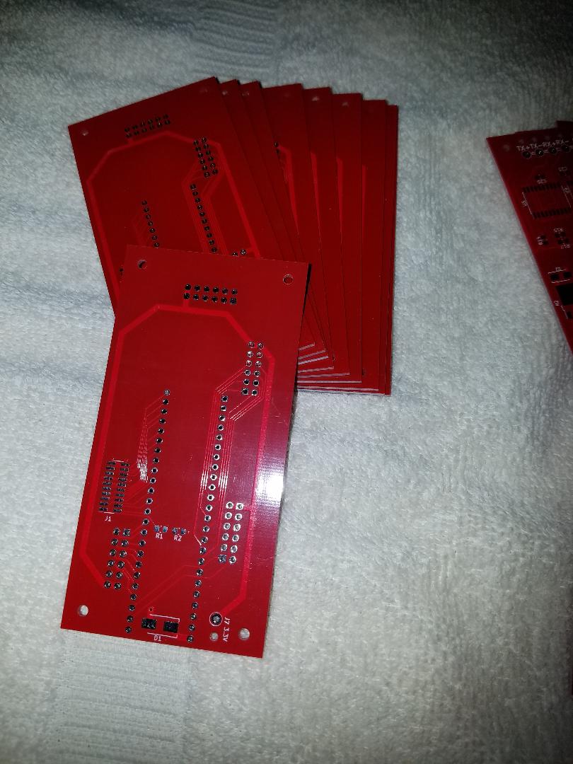

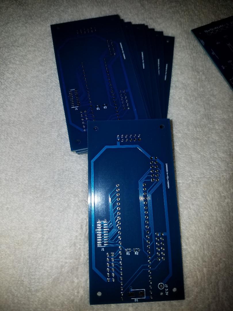

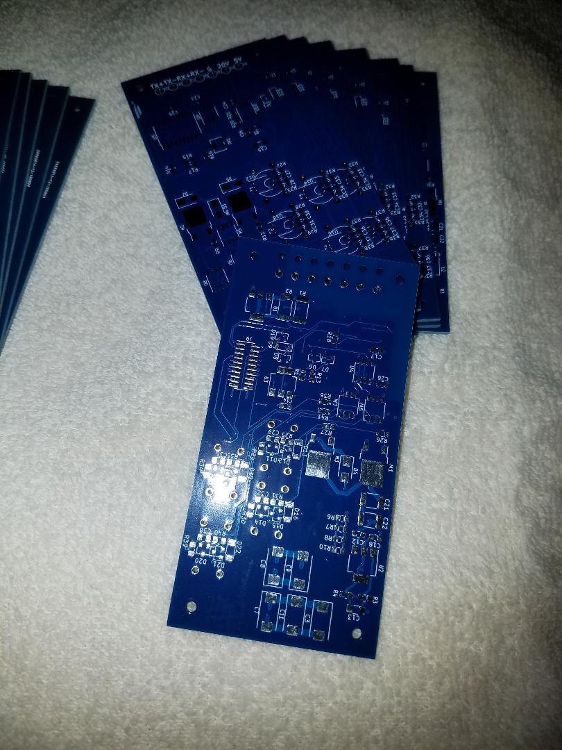

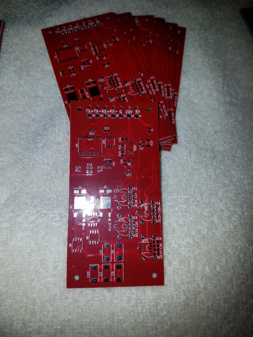

        • Originally posted by Mdtoday View Post
          ... You should see a delivery very soon...
          I guess so!!!!
          A million "I thank you"s!'
          Almost done with restructuring of the VHDL. Have everything working... VHDL much less cluttered. The output of the CIC filter actually starts to appear after ~8 ms. It really shows up when running the simulator with the restructured code which show when RX data is available from the RX module. Will be posting the update later this evening.
            I guess so!!!!
            Great to see they arrived ok and you are very welcome, thanks for sharing your project.
            Excellent news on the VHDL, its sounding very promising.
            Went to order the power mosfet STB8NM60T4 last night and realised the package type is the larger D2PAK.
            I have ordered STB5NM60T4 which is the DPAK
            Oh and I short changed you on the boards, I have an extra 2 sets here I pulled out of the pack to have a look at under the scope but they didn't make it back in the bundle lol, oops!
            cheers
            Mdtoday

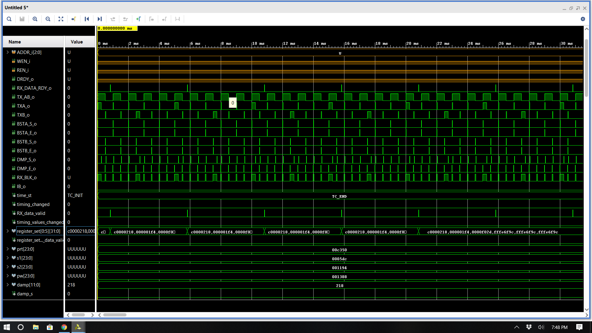

            • Major VHDL Restructure
              I have radically restructured the VHDL code. It now consists of 3 (later to be 5) modules, TX_RX, TX_Timing, and RX. The top module TX_RX manages the communications register, calculates the clock counts for PRT, PW, TX_Boost, DAMP, RX_blanking, etc for the TX_timing module and CIC decimation rate for the RX CIC filter. It also receives the RX data from the RX module, posts it in the communications register, and notifies the host that new RX data is available. The restructured VHDL is much more organized and easier to read and comprehend (at least in my opinion).
              The link to the new zip ( Vivado_Bipolar_TX(6-17-2019).zip ).
              A sim run of the restructured VHDL:
              You'll notice that the RX CIC filter starts showing the effects of input data at about 800 usec and keeps increasing until it reaches maximum value at about 20.5ms. The presence of output data is observed by the appearance of the "RX_DATA_RDY_o" signal. The value of the RX data for all three samples is in the last 3 entries of the "register_set" array.
                Nicely done JL, very clean, great job and a lot of work, thanks for sharing.

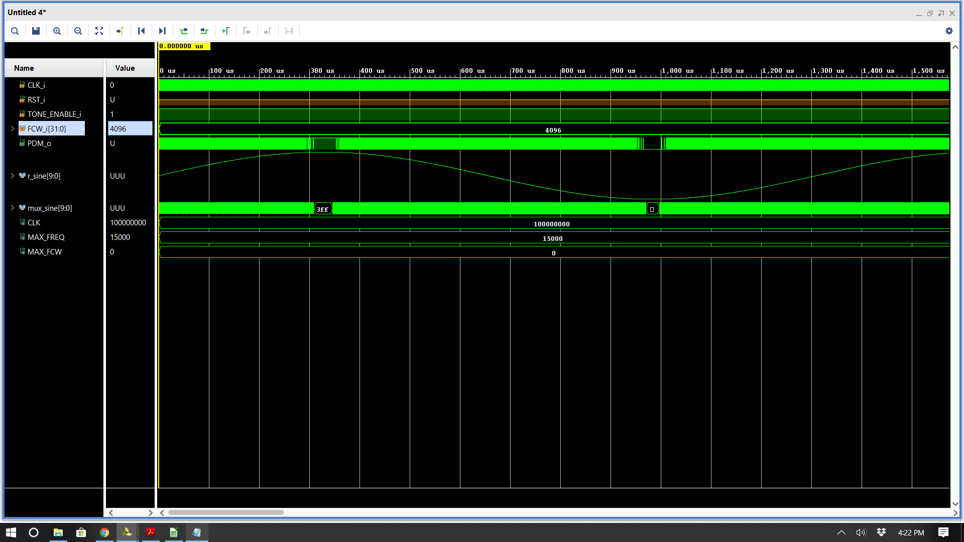

                        I also defined an audio module for use with the project when we get to the stage where it is needed. The audio module consists of a numerically controlled oscillator (NCO) with a sine lookup table that passes a 10 bit sinusoidal signal to a pulse density modulation (PDM) encoder. I have designed the audio module to provide a sinusoidal tone that is between 190Hz and 3050Hz controlled by a frequency control word that is normally the value of the processed target signal. The frequency out (F) is F = CLK * FCW / (2**accumulator size (bits)). As designed the CLK = 100MHz and accumulator size = 29 bits. To keep the oscillator frequency within design limits, any time the input FCW is greater than 2^14 we subtract 2^12 ... any time the FCW is less than 2^10 we add 2^12. Sounds strange but it works. The DPM is clocked at 100 MHz also so the output can easily function as a 1 bit dac by filtering with a low pass RC filter with a cutoff of ~ 3000Hz.
                        The Vivado simulator waveforms for the audio module (FCW = 4096): Click image for larger version
                        The Vivado project for the audio is in the ./Audio subdirectory (off of the Bipolar_TX directory) contained in the project zip.

                          The changes made to your code is looking very good, and the audio is going to be great, nice work.
