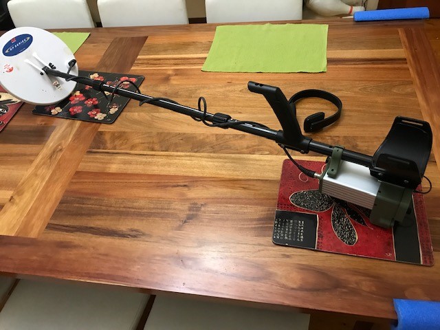

    I did do a design based on the Vallon some time ago, here is the head Click image for larger version
ID:	354532 and a photo of a detector I recently finished Click image for larger version
ID:	354533 . I'll have to wait til I get home to access the other drawings.
    I'm sure we will come up with a suitable enclosure.
    cheers

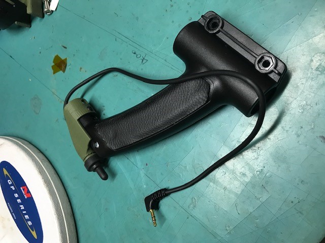

      This is what I did for the detector shown earlier. Click image for larger version
      The switch is a spring return centre off SPDT, I use it for GB and Pinpoint modes.
      cheers
      Mdtoday

        Hi Mdtoday,
        Very nice looking enclosure. That's creative using a Hammond extrusion with custom printed ends.
        Looking forword to JL and you testing the complete system
        Thanks for posting
          Hi Mdtoday,
          Thanks for posting
          Thanks Altra, originally I was going to mill the Hammond end plates but I wanted to add BT , battery holder and a stand and decided to 3D print rather than bolt on bits and pieces.
          I spray the inside of the printed parts with nickel shielding. The stand holds the 2 lithium batteries. BTW, I deliberately print at lower resolutions and slower speeds to get strength and texture.
          JL is doing a great job with this project and I am just following along and helping where I can.
          I will post STL files in due course for some enclosure ideas once I run them past JL.
          Cheers
          Mdtoday

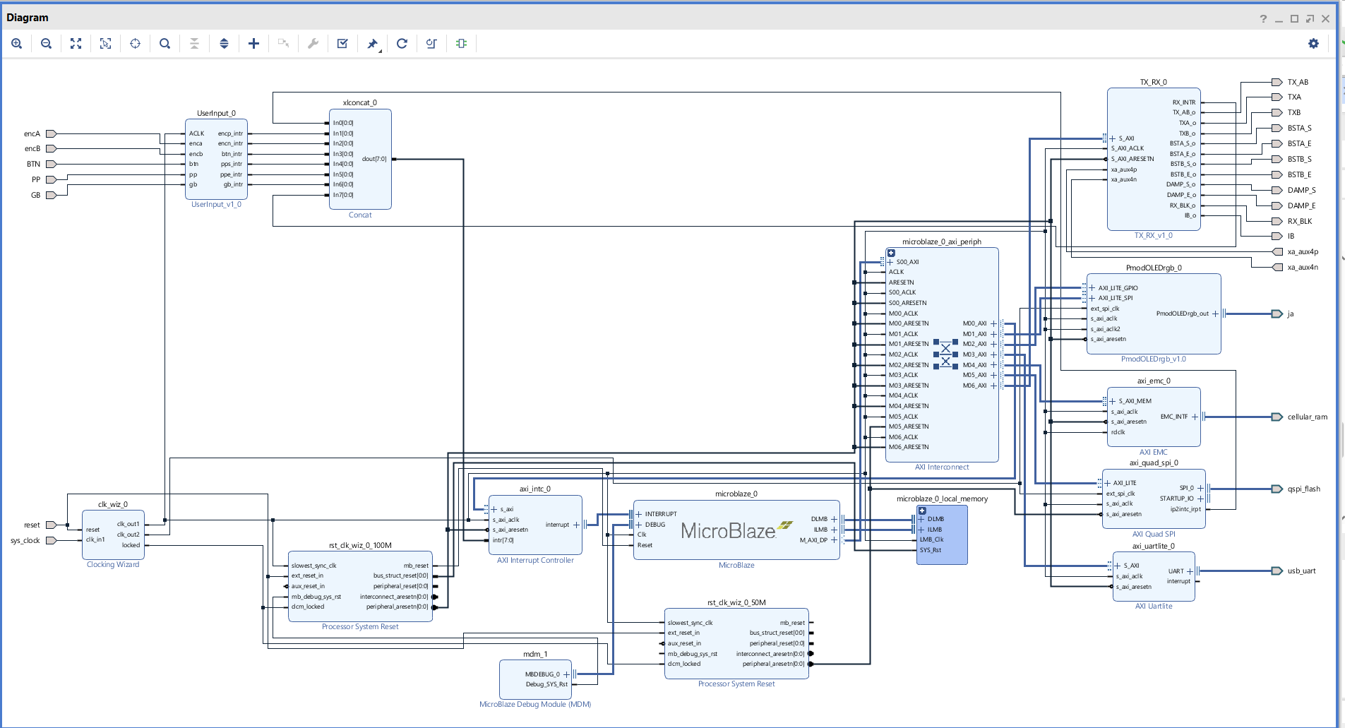

              Successfully integrated the Diligent OLEDrgb Pmod to the system design...
              I will post a link to the updated project archive sometime in the next few days after I re-arrange the location of the library folder for the custom IP's (OLEDrgb being one of them). Currently this IP library is out side of the "Bipolar_PI" project and would cause errors for anyone just dropping and using the project archive. I want to integrate the custom IP library within the directory structure of the project.
              Well... that was easier said than done. But I did it! I dropped the complete digilent ip repo into the Bipolar_PI directory structure to insure anyone can drop and run this project without having to drastically modify the environment.
              I also changed the microblaze environment. Local memory was increased to 64 kBytes, stack was increased to 2 kBytes, and heap was increased to 4 kBytes. This increase was merited by the fact that the OLEDrgb graphics test would cause a linker failure of stack or heap allocation. I also turned on some of the hardware features (barrel shifter, hardware multiplier, hardware divider, etc.) to minimize memory usage.
              During the testing of the OLEDrgb, I found that the RGB colors specified were not displaying correctly. Green was displaying as red, red was displaying as blue, and blue was displaying as green. That problem was traced to the digilent ip code. It seems the code was developed with the microblaze processor operating in Big endian mode. But if you are using AXI4, the microblaze compiler system is configured for little endian mode. So I modified the OLEDrgb code to do a byte swap of the rgb variable. Now what you ask for is what you get.
              The current code is only test code that tests the capability to store the parameters in flash rom, tests the capability to communicate with the TX_RX module and provide operating parameters, and tests the capability to display characters on the OLEDrgb Pmod. The TX_RX module is providing the timing signals that will be needed by the PCB boards.
              The current project is contained in Vivado_Bipolar_PI(7-25-2019).zip.

                • User Input!!!
                  Well, this has been a painful week (and a half). A week ago, Friday July 26, I started designing the user input hardware module that would interface the rotary encoder (with the encoder button switch), a pinpoint switch input, and a ground balance request switch) with the microblaze embedded microprocessor. Due to more than a couple of interacting issues it has resulted in about 60 hrs of headaches, one after another. But, finally today, it all came together. We now have a hardware definition module that will take the inputs described above and produces six interrupts to the microprocessor so that the software will not have to poll for these device inputs. The six interrupts are: encoder clockwise increments, counter clockwise increments, encoder button (select), pinpoint start, pinpoint end, and ground balance request. Interrupts also signal the embedded upc that a new received data set is available from the TX_RX module.
                  I have only one more hardware definition to integrate into the design... the PCM audio module. After that is integrated, we can start the software coding process to bring it all together. So far the TX_RX, OLEDrgb display, flash memory storage and retrieval of parameters, rotary encoder with push button select inputs, switch inputs for pinpoint and ground balance are all integrated and tested. The encoder inputs (A & B) and all switch inputs are properly de-bounced (one of the more severe headaches). The current design has the rotary encoder assigned to the J4 Pmod receptacle on the FPGA/Bipolar PI interface board.
                  The current Vivado block design:
                  The current Vivado project archive is Vivado_BiPolar_PI(8-3-2019).zip .

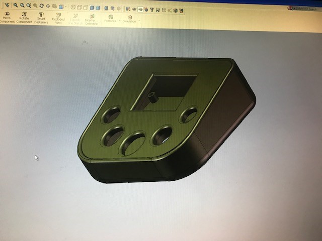

                      Recent work commitments reduced the time I had set aside to completely assemble my boards and finish off the draft of the enclosure designs but now that I am back home for the next few months (hopefully) I'll be able to get stuck into it.
                      Again, I know it's early to talk enclosure, however, after looking at the PMOD OLED display and interface, we may have to re-orientate / position 1 or 2 IF board connectors to make assembling into enclosure front panel a little easier.
                      For now, we could use a short ribbon or wire connector system, I need to do some more thinking on the enclosure and still waiting on delivery of the PMOD OLED and encoder modules to see how best to do this.
                      Perhaps another option is to redesign a new interface board with OLED and encoder mounted directly on it after all the testing and design work is completed..

                            Thanks for the info JL, yes sounds like cables are the way to go.
                            I have been working on 2 types of enclosure. The one attached KingJL_Bipolar_TX_Enclosure_V1.pdf is a draft version which can be 3D printed in 2 sections split vertically in the centre and held together with screws.
                            I'll do some more work on the other one now that I have your thoughts.
