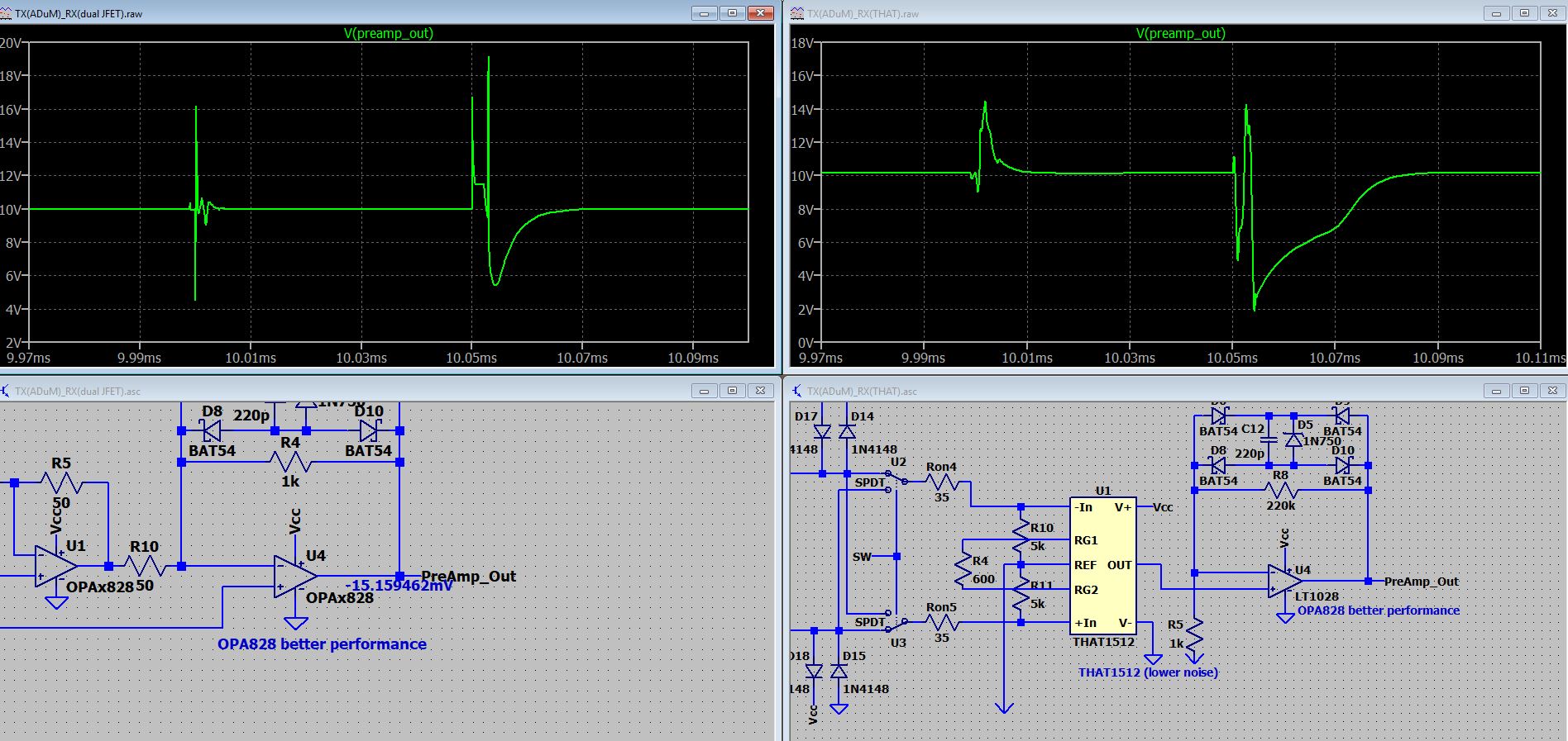

                  @JL all work fine now, thank you. Click image for larger version

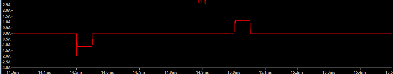

                      That is affected by the Dw parameter. I suggest setting the parameters as stated in post #576 (in both simulations). That should fix the problem... also do not consider the results before at least 8 ms as the boost build-up is not stable until then.
                        set the Dw parameter to 2.84u and it should switch positive (it actually switches positve at 2.85u).
                        The dual JFET version runs slower... this is due to the opa828 subcircuit. I have noticed that TI subcircuits really tax LtSpice... I think the TI models are more complex and computational intensive.
