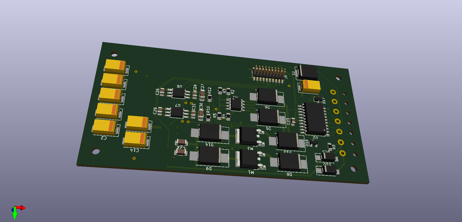

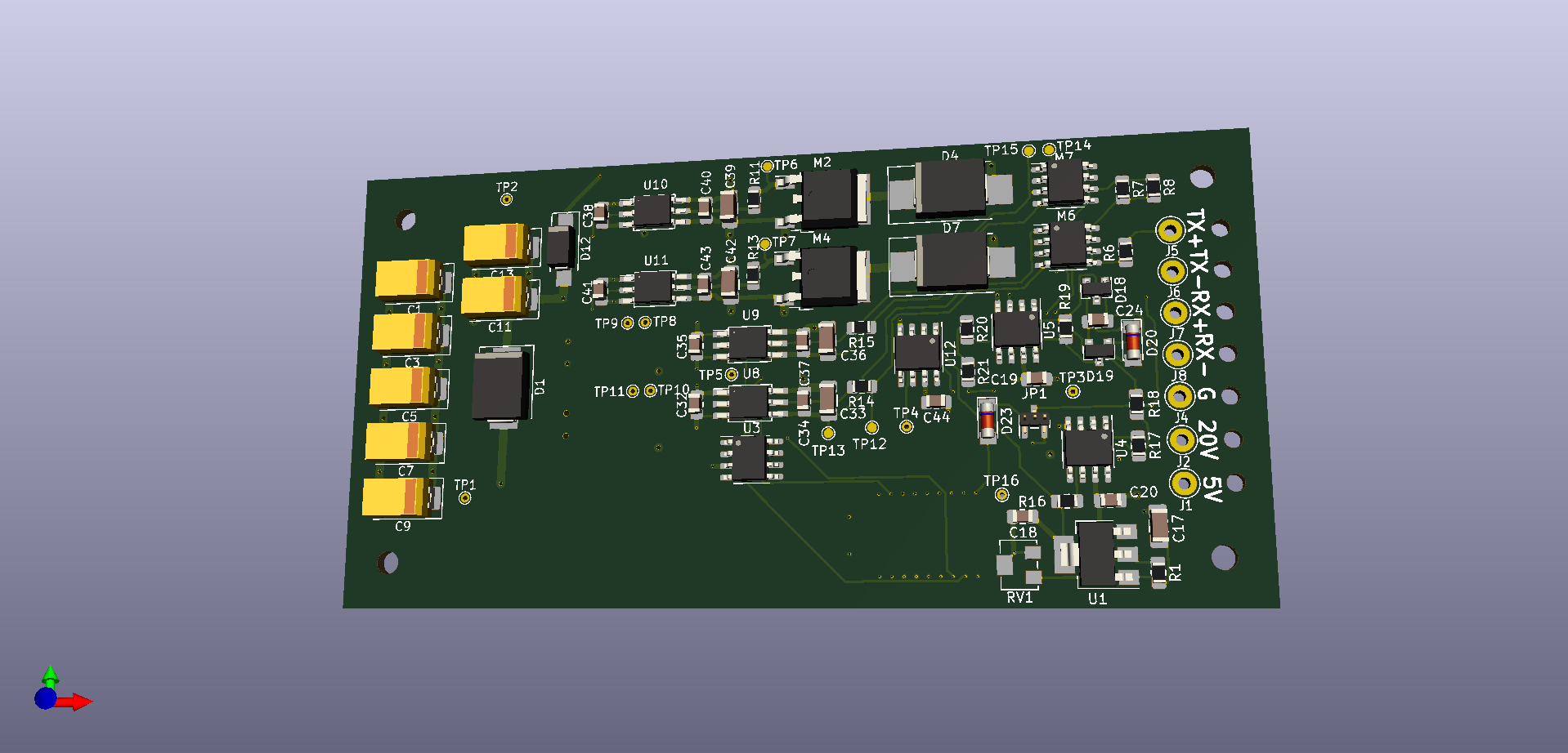

                            • TX with ADum4120 MOSFET driver
                              ... The PCB is still a work in progress, I need to tweak/relax the layout...
                              The schematic and board layout is completed. I added test points (all accessible from the top side of PCB) for 5V, 20V, Vdd, REF, M5A&B source, M1 gate & M1 sorce, M3 gate & M3 source, M2 gate, M4, gate, m6 gate & M6 source, M7 gate & M7 source, and pre-amp out. I added an output line to J9 for the signal at the source of M5A&B. The TX current from the end of TX boost until TX off can be measured (voltage drop across R2, R3, R4, and R5) at this point. If we use the old IF board, we have to cut the trace from from J1-5 to PIO40 to prevent damaging the CMOD-A7 (we need a new I/F board).
                              Board bottom view:
                              Kicad arcive and gerbers:
                              Kicad_TX_ADUM_drive(12-22-2019).zip
                              TX(ADuM)-Gerbers(12-22-2019).zip
                              @Mdtoday (and anyone else so inclined) would you put your eagle eye to the board layout when you get time. Again, none of this is time critical.
