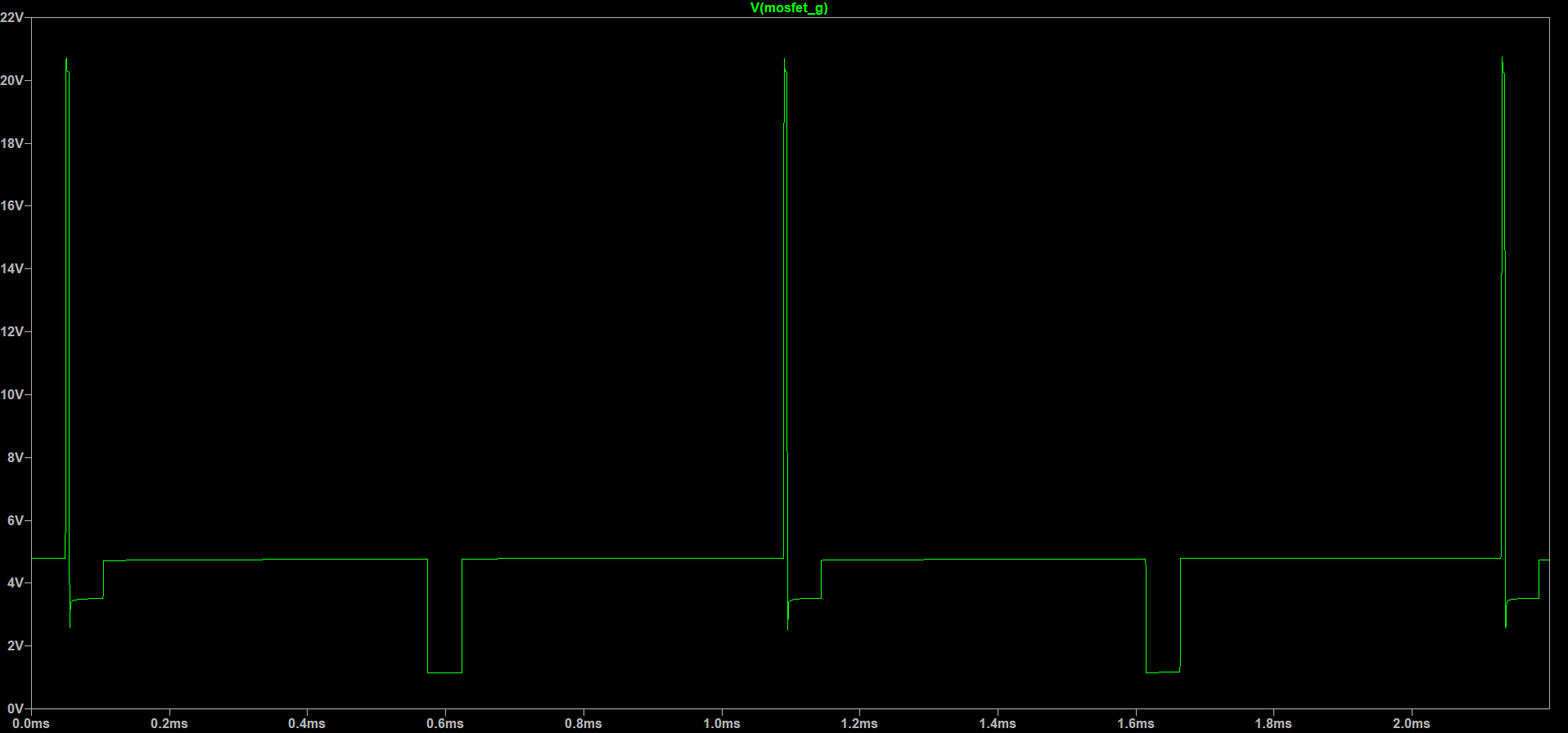

                  This is approximately what we are shooting for measured at either Boost_A_G to gnd or Boost_B_G to gnd. We are looking for a minimum peak of 15V... preferably 20V (gives a 10v -15V signal between gate and source).

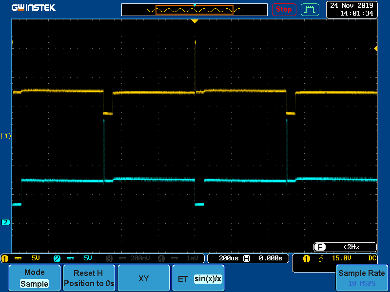

                    This is what we have. Yellow trace is Boost_B_G measured at gate of M1, Blue trace is Boost_A_G measured at gate of M3 to Gnd.

                    I can't find my differential probes at the moment, when I do, I will connect coil take some measurements

                      Things are looking much better (looks like 100% improvement over previous boost signal waveforms)... it looks like Boost_B_G is 9-10 V drive and Boost_A_G is ~11V drive. But it also looks like the total yellow trace is about 85% of the blue trace overall, like there is a missmatch of the channel inputs. If that is the case, then they both might be meeting the minimum 10V drive (actually 9V will work well enough to progress on with testing and we can improve that with new inductors when we get them ready). But I think the drive is now high enough to see what we get for TX.

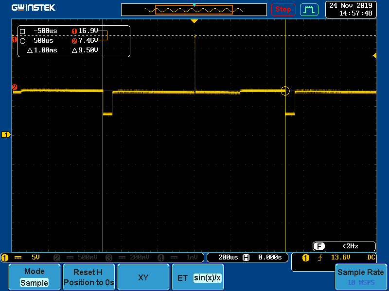

                              Here is the gate drive on M2 Click image for larger version

                                That looks perfect!!
