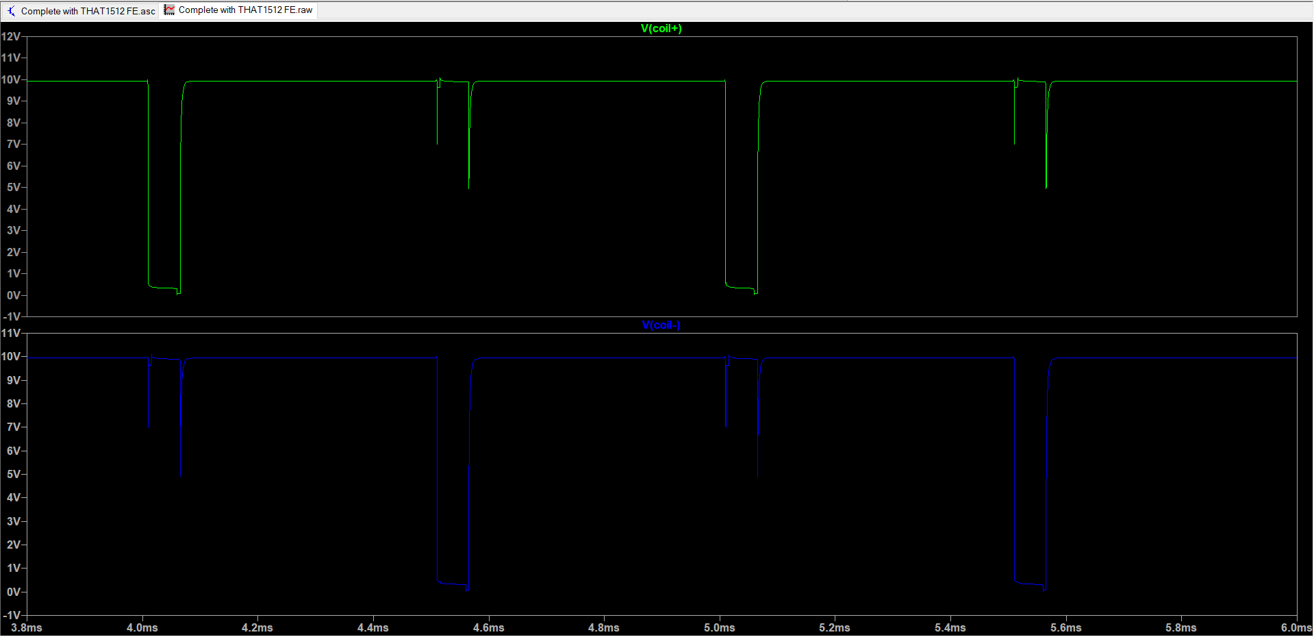

    Actually the purpose of U2D is more complicated than just blanking the RX. Yes it is effective at blanking the RX only in mono mode. but more importantly there is a very short (~1 usec or less) overlap where U2D is energized and the "DAMP" switchwes are energized. This extremely brief overlap has the effect of applying a very low resistance across the TX coil and quickly dissipates any residual charge in the TX circuit resulting in ZERO coil current (that is the theory anyway... in practice, the coil current usually is not zero, but is anywhere from a few micro-amps to 1 ma). This all works for both mono or IB mode. In IB mode, the need for RX blanking is less pronounced (asuming an IB is anywhere near properly balanced). In fact with the front end as designed, RX blanking is not needed at all as the frontend never goes into saturation regardless of input.
    Trying to understand why applying a very low resistance across the TX coil and quickly dissipates any residual charge in the TX circuit resulting in ZERO coil current low resistance dissipates current?
      Dissipates any residual charge... not necessarily CURRENT. As Carl and others have emphasised many times, the TX circuit is an RLC circuit, not just an RL circuit. The key is to apply this at the time of zero(or near zero) coil current... it effectively stops the oscillations (remember that the coil has no damp applied until this time). A reading of the Vallon patent gives a hint to this... and it works in practice.

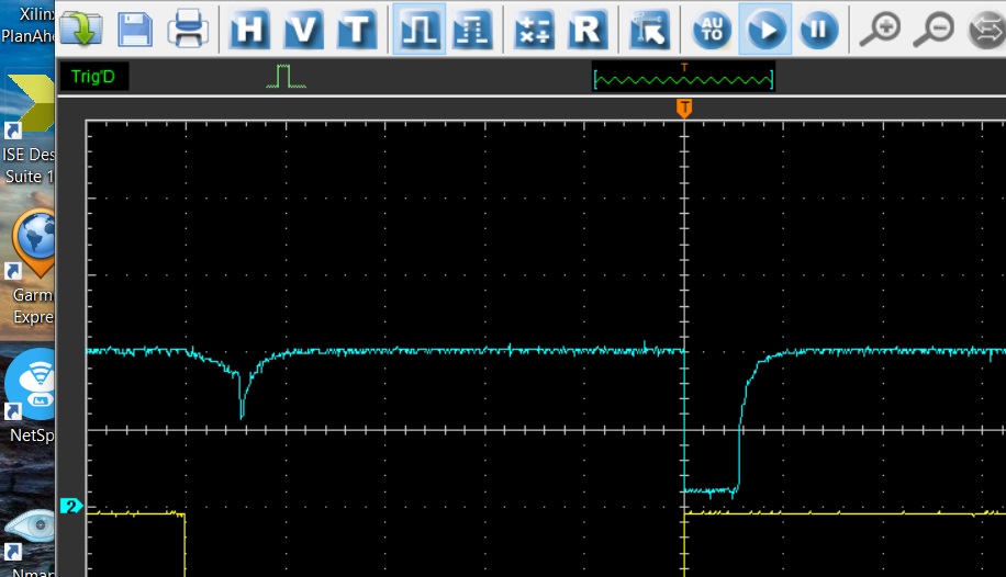

          A check of TX_COIL+ and TX_COIL- indicated an anomaly to what was expected. What was expected at these points, was that the level would be about the REF voltage (10V) going to <1V during the respective TX-A/B period (TX-A for TX_COIL+ and TX-B for TX_COIL-).

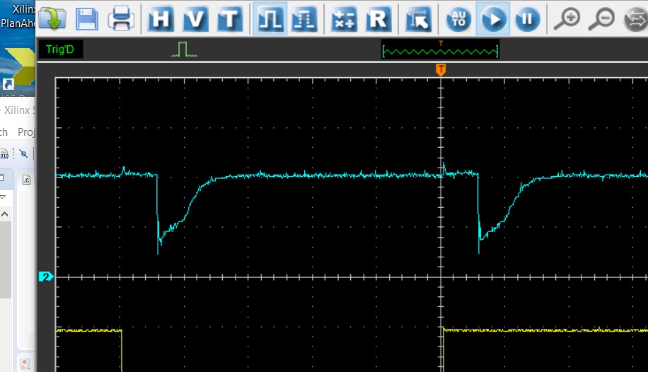

          What was actually observed was a signal that went to <1V during the respective TX time gradually increased up to ~9V and then went to ~3V during the alternate TX cycle. This was indicating that the damp switches (M6 & M7) were never turning off. A re-check of the 5V rail found that the 5V was actually 4.68V... extremely close to the EL7202 minimum voltage and was not providing sufficient drive to the Pulse Xformer drive circuit. The reason for the drop in the 5V rail was the inrush current limiter which exhibits a ~0.7V drop from input to output. Adjusting the 5V supply to achieve 5.46V after the current limiter allowed the damp circuit to perform correctly.
          The last issue was that I noticed, while analyzing the damp switch problem, that the pre-amp output to the mating connector seemed not to be unipolar as if U5 (DG333A) was not switching during alternate TX cycles. Come to find out, I had a DG333AL which requires a VL input on pin 15... the DG333A does not have this pin connected. I connected 5V via a jumper wire between pins U5 pin15 and JP1 pin 3 of U5 and the pre-amp output looked correct for operation with no coil. It "looked correct", but it wasn't! I was losing the actual signal through U5A and U5B... what is more, I had the TX_COIL signals riding a 5V to pins 4 and 7 but not on pins 3 and 8. Pins 3 and 8 had a 10V level. Further checking and severe head scratching determined that the junction of D23 and JP1 pin 1 needed a pull down resistor to insure a LOW signal to pins 1 and 8 of U5 as D23 was in effect "floating" the low signal to U5 pins 1 and 8. I placed a 1k resistor from the cathode of D23 and the GND via that was attached to C1. Now the signal from the preamp was unpolar and riding the 10V REF.
