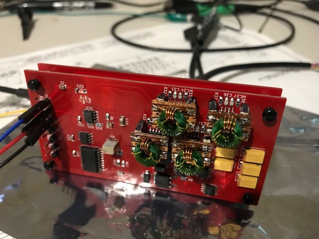

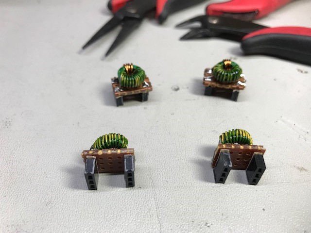

      I have removed all 1 ohm resistors on transformer driver outputs and replaced with 0R links, rewound primaries using .63mm diam (22g) wire. and made up some carrier modules with sockets to prevent board damage while we are in the testing phase.

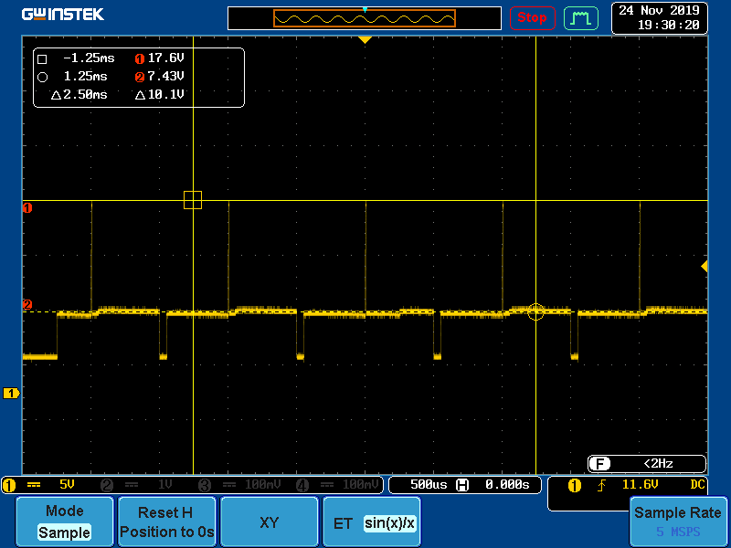

      There is close to 800mV pulse height improvement.
      As you have pointed out, I think we are at our limits on the current toroids.
      We still have 14v gate drive on M6_G and M7_G.
      • Originally posted by Mdtoday View Post
        ... and made up some carrier modules with sockets to prevent board damage while we are in the testing phase...
        [ATTACH]48494[/ATTACH]
        [ATTACH]48495[/ATTACH]
        I really like those sockets for testing!!!
        [ATTACH]48493[/ATTACH]...
        I think that got us over a minimum threshold for testing.
          I really like those sockets for testing!!!I think that got us over a minimum threshold for testing.????
          The waveform on M6 M7 stayed the same so I didn?t post new shot. I will perhaps wind another transformer with more secondary windings on one if these cores . It looks like I could squeeze 17 on there...tight but worth a try

            I see no shot of M6 & M7... other shots were M2 & M4... right? M6 & M7 are the damp MOSFETs.

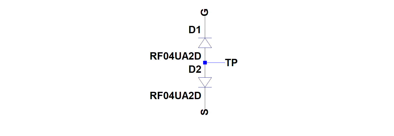

            • Test Point
              In the next version of the TX board, I think I will include an isolated test point to be able to check the MOSFET gate drive and route the pad for the test point to the top side.
Name:	MOSFET gate drive TP.png

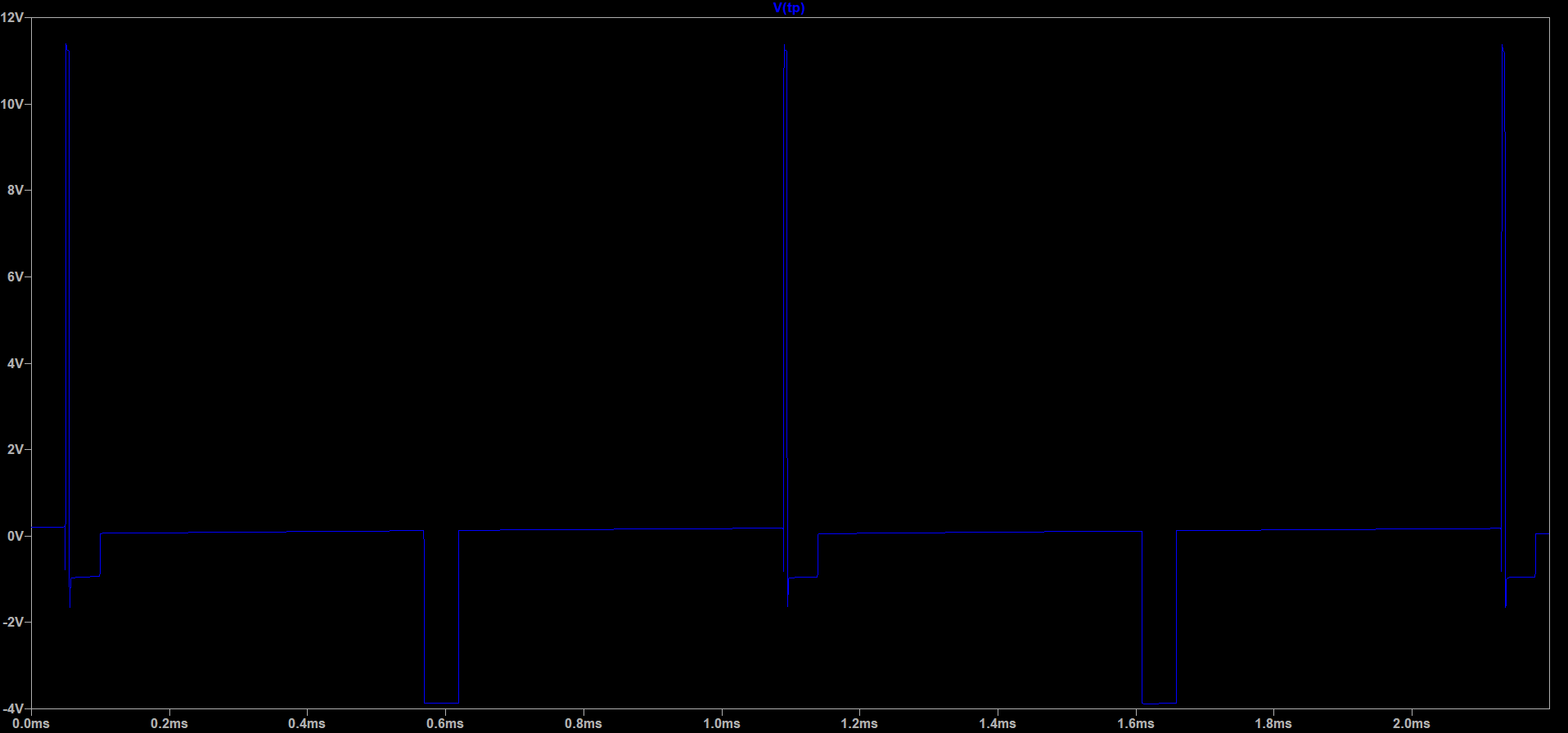

              It does not show the actual voltage of the drive pulse, but the ratio can be determined. It is at a 0V reference and testing with it will not change the electrical charactaristics of the circuit under test (like dissapating any capacitively stored voltage).
Name:	MOSFET TP waveform.png

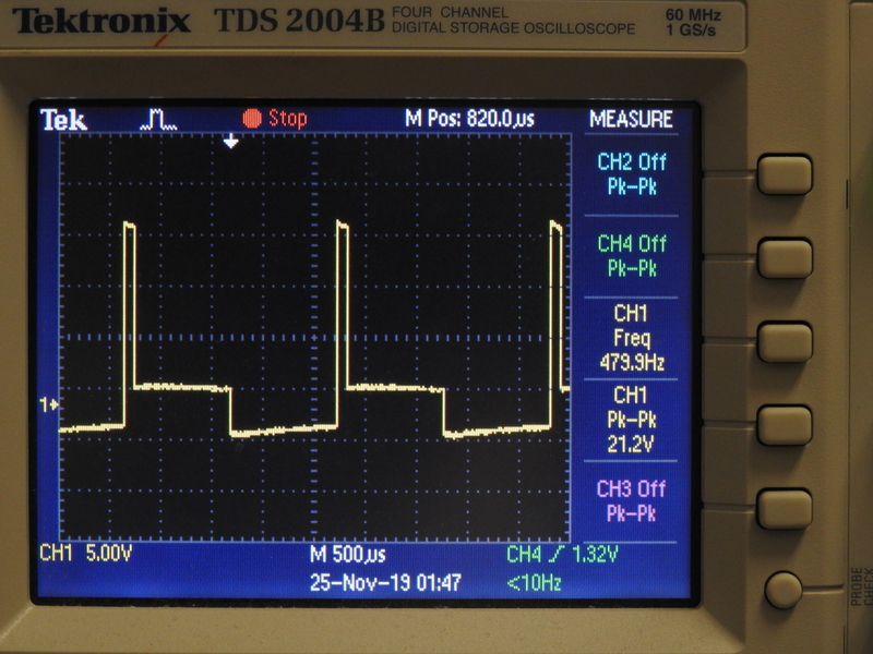

                    I had the same problems with the Chinese toroids. I ended up revisiting the Vallon design and they are using over 20 turns on the secondary. So my current design is using 6 turns #24 on the primary and 23 turns of #30 for the secondary. My primary has a 1 ohm in series. The secondary wire gauge didn't seem to matter. I am getting over 20 volts of gate drive which is more than enough. Good idea sourcing a spec'ed toriod. Too much going on in these circuits to wonder if your Chinese parts are the problem. Can't wait until you start the signal processing stage.
                    Attached photo - no coil, gate voltage 21 volts for 100uS.
                      Which are driven by the other 2 pulse transformer circuits.
                          Sorry, yes, you are correct, I will measure again and post those.
                            [ATTACH=CONFIG]48496[/ATTACH]
                            [ATTACH=CONFIG]48497[/ATTACH]
                            I really like this idea, it will be very handy.
                                If there were screen shots of M6_G and M7_G then we have a problem... extremely easily corrected but still a problem. The M6 & M7 gates shold be 0 during the TX time and go high shortly after TX turns off and stay high until slightly before TX (A or B) turns on again. In other words it will be high for ~398 usec and low for ~60 usec.
                                As I recheck the schematic, I see that I took DAMP_S to pin 4 of U14 and U15... I think this is wrong... my rationale was wrong. If this is a fact, then I can correct it by changing the constraint file for the Cmod-A7. All I will have to do then is regenerate the project and post it.
