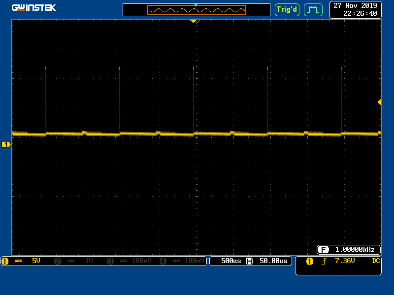

    As I suspected, M6 is wrong... I fouled up an swaped the inputs to the EL7202,s for the M6_G and M7_G. I have a fix r4eady for the Vivado project that will fix rhis. It involved switching the ports around in the FPGA constraints file. Will put up the link to it in another post.

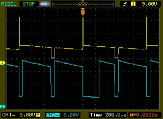

    Here is the timing as per latest Vivado project changes, I will post more later today, only have my handheld scope with me atm.
Name:	M1_M6_Gate drive_timing2.bmp

      The timing and polarity of signals are now correct. I am concered by the amount of M6_G droop. Because of Probe or something else?
      Amplitude (initial) is OK. If it isn't something bleeding off the signal, we may need to try to improve the droop. I believe in the vallon, the equivalent resistor as R25, R31, R35 & R40 was 13 Meg vs our 2.2Meg and the capacitors C29, 32, C35, C38 were 5n6 vs our 2n2.
      If you have some 5n6 and say maybe 10 meg we could try and see if it improves... I would try the M6 and M7 drivers 1rst and if all is well update the M1 & M3 drivers later.
        The probes I used are my toolbox ones, I did a quick check and they look ok with the dso reference but they are not my goto probes.
        I will repeat the tests again later today back at good dso/probes and will replace those components, I have those values

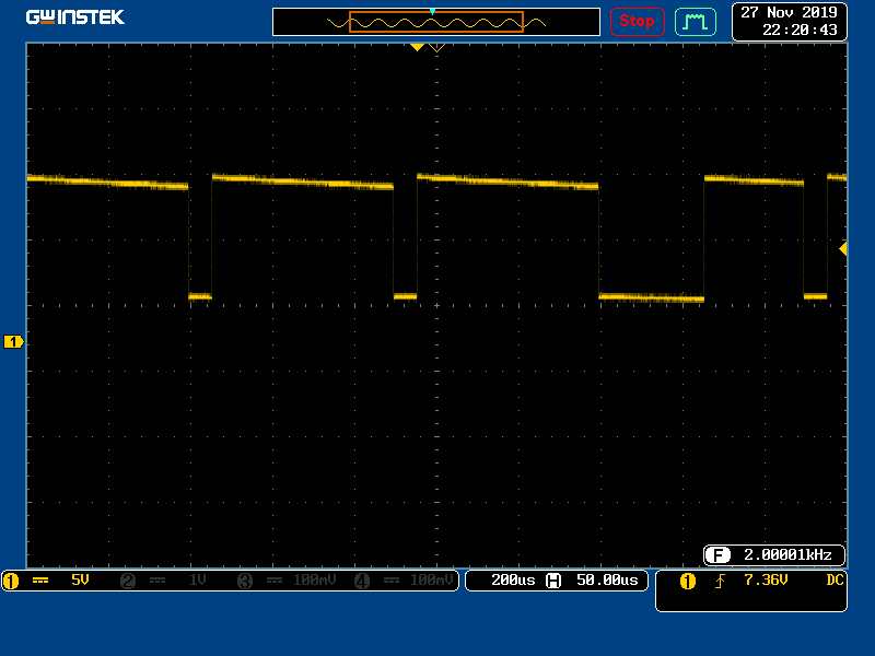

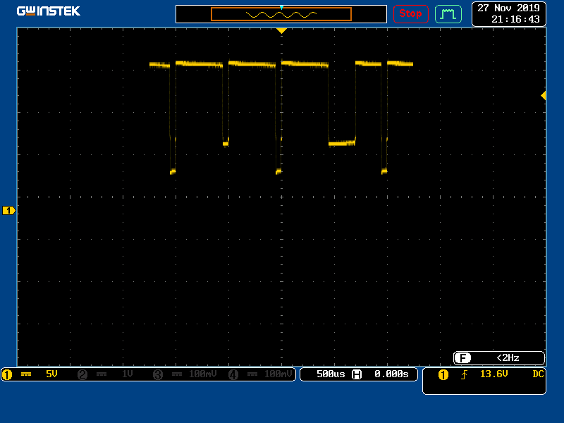

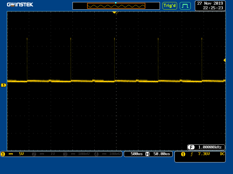

              I have taken more measurements tonight on my bench DSO/probe set. The apparent droop displayed in post 511, is a probe issue.
              All measurements across G/S.The droop on average is 1v
              Note that T1,T2 (Boost) have 16 and 18 turn secondaries respectively, while T3,T4 secondaries were the original 14 turns.
Name:	M6_Gate to Source.PNG
Name:	M7_Gate to Source.PNG

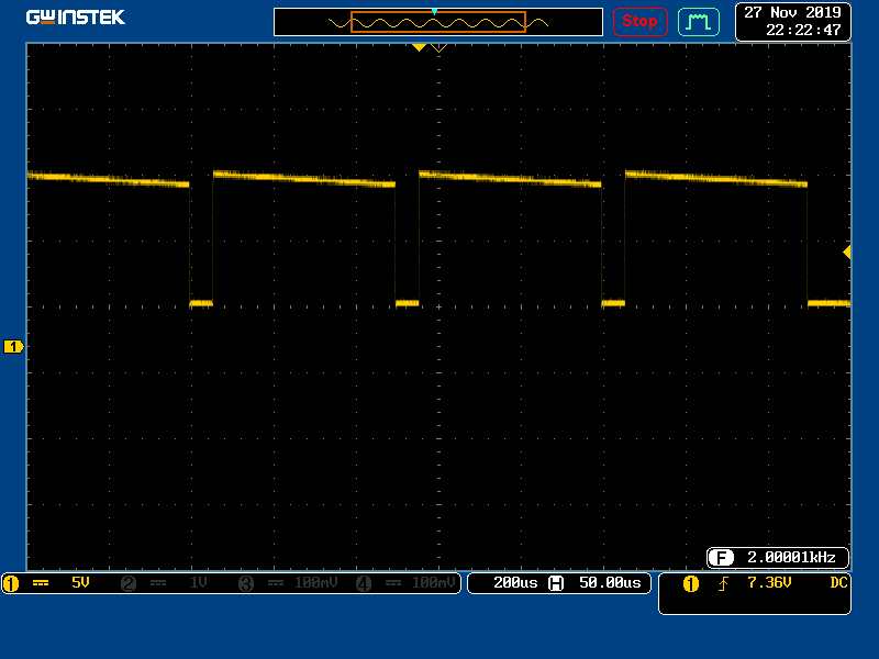

              Last image was of the waveform on M6 with R35=10M / C35 = 4n7 the droop improved by approx 0.5v but the voltage swing was reduced quite a bit.
              I re-installed the 2.2Meg /3.3nF combination for the 4 tests above.

              • Originally posted by Mdtoday View Post
                [ATTACH]48526[/ATTACH]
                I think the apparent "reduced" voltage swing was because only M6 was modified. Was the M6_10M_4n7 taken across GS or G gnd. The voltage swing actually increased for the M6 side (13v vs 10V). The other swing was reduced from 10 to about 8. I think that is because the base signal is being fed through the damp resistor during the alternate TX (A/B) cycle time.
                  Yes, this would make sense, I will repeat the test with both modified.
                  The measurement was taken across GS
                  I have been meaning to capture all 4 points at once to get a good visual on whats going on. I will do this later today.

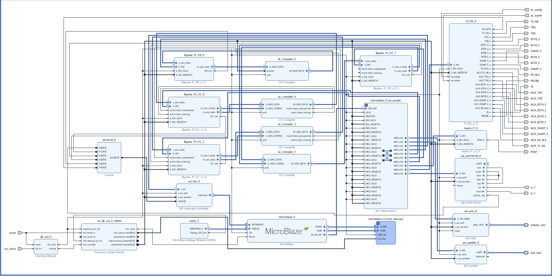

                          The surrent block design:
Name:	Bipolar PI with Nextion IF Design.png

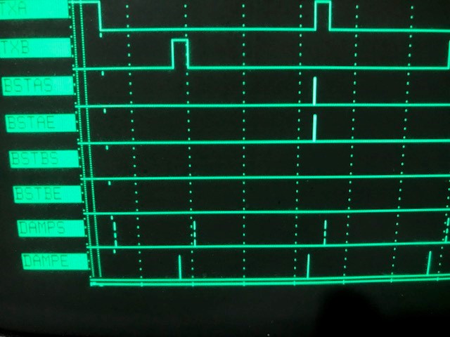

                              @KingJL, I have been busy with restoring my computers and some test gear from power surge damage from blown line transformer.
                              As Murphy's law would have it, I normally have surge protection on all my work benches but I had set up a temporary area for these latest tests as I pulled out my ancient but trusty HP1630D which takes up a lot of bench space and used an unprotected power block.
                              Funny thing, The HP survived, 2 computers and some test gear did not.
                              Now back on deck and had a bit of time to test the latest Vivado project with Aux outputs.
                              Lucky for me I had the A7 and TX project safely tucked away on another bench and not connected
                              Two signals are missing
                              J3-7 = AUX_BSTB_S,
                              J3-8 = AUX_BSTB_E
                              All others look good. I will post better screenshots once I have a replacement GPIB interface card (casualty of the power surge)
                              Checked signals back at the A7 but both Aux_BoostB signals not there either.

                                I see the problem... regenerating project now... will post new project archive shortly.
