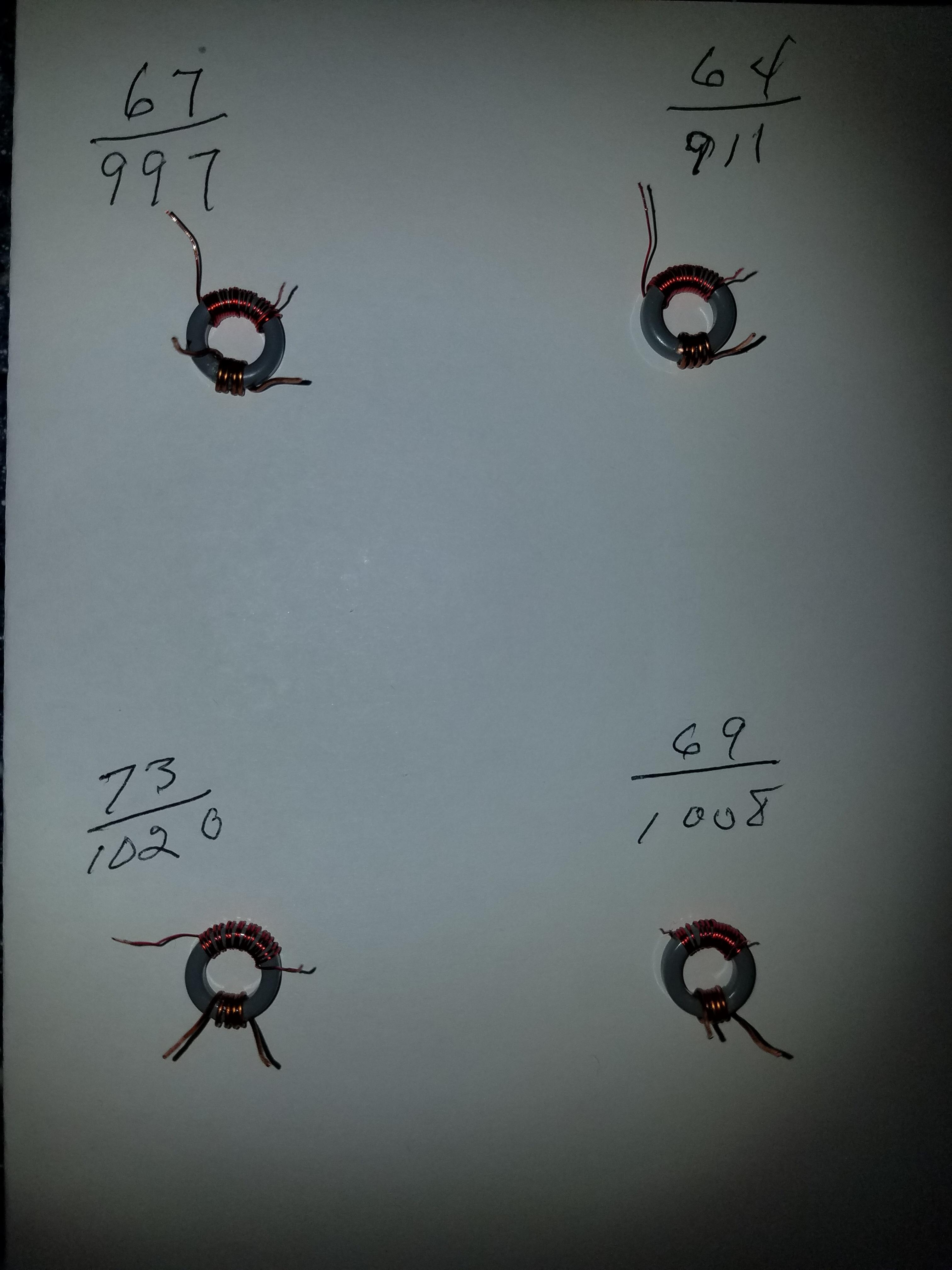

          ... When my order for AWG 28 arrives, I will wind the secondaries with 18 turns...
          The AWG 28 arrived. Wound the secondaries with 18 turns (primaries are 4 3/4 turns) and checked the secondary: primary inductance. The results are 997uH:67uH, 911uH:64uH, 1020uH:73uH, 1008uH:69uH.

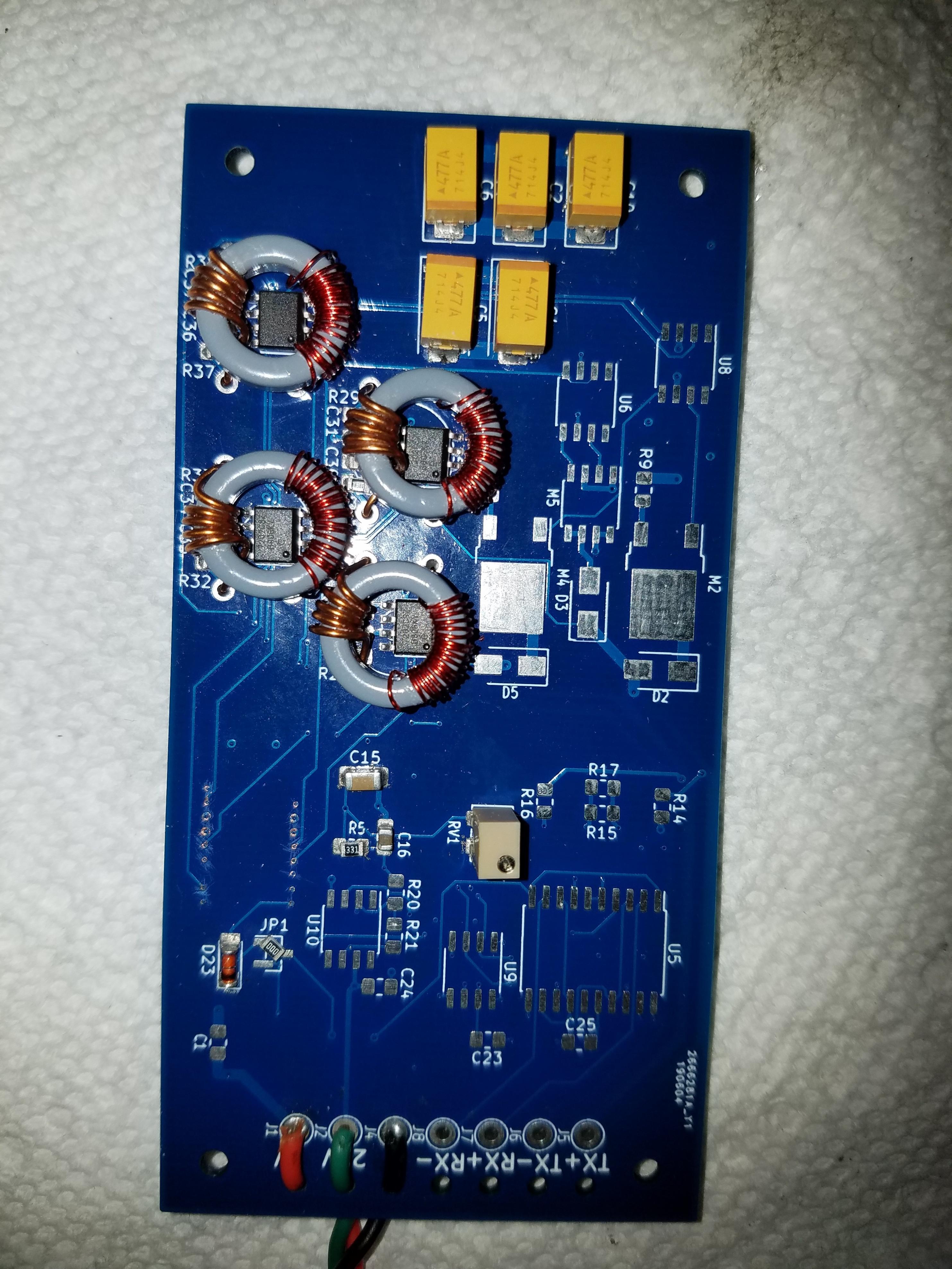

          Temporarily mounted the toroid transformer on the PCB to check the fit. We need to add insulation between the windings of the primary and the 2 resistors and 2 capacitors in the primary circuit on which the primary is resting.

          I am satisfied with the transformer parameters and the PCB fit.
            Excellent news and looking good. I used Kapton tape under the original mounting of the toroids

                I have populated the power distribution and MOSFET driver circuits. I had to wait for a re-order of BAT54S's as when I went to mount them I could not find them. Will power up later this week and check driver signals without any other circuit interaction. I suspect (as I have no idea of the transformer coupling coefficient, which with toroids should be very close to 1.0) that the toriods will work well with turns ratios ranging from 3.3:1 to 4:1. Below 3.3:1 the "off" condition voltage raises to a level (~1V) dangerously (for my satisfaction) close to the lower end of the threshold voltage range of the MOSFET. Due to the way that this driver circuit works, it is better to slightly overdrive the circuit as during the turn-off drive, it provides sufficient drive across the zener diode to ensure a 0V or slightly negative residual during the "off" condition, while the zener provides over voltage protection during the "on" condition.

                    Decided to hold off on mounting the toroids... I only want to do this once. I have ordered some Kapton tape ( thanks @Mdtoday for that suggestion) to insulate the winding from the components over which the toroids are mounted. The tape should arrive mid next week. Also things will slow down after next Tuesday for probably about 2 weeks as I go in for cataract surgery Tuesday, Dec 17.
