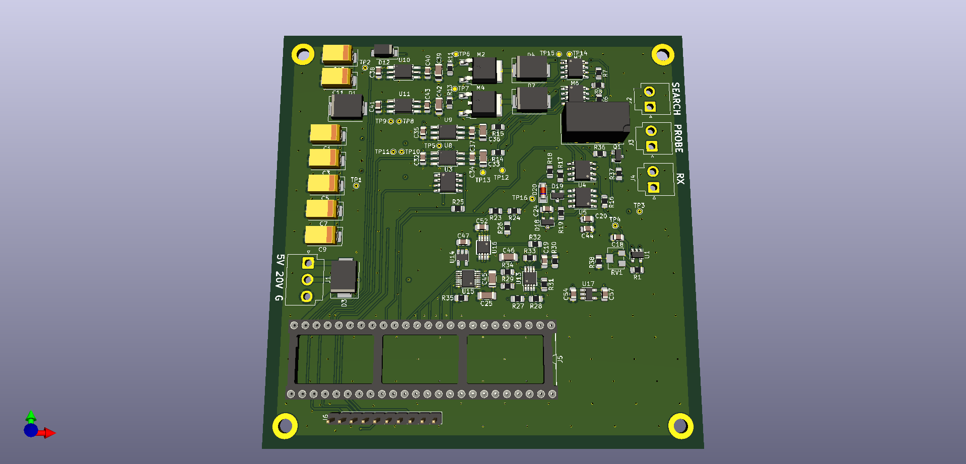

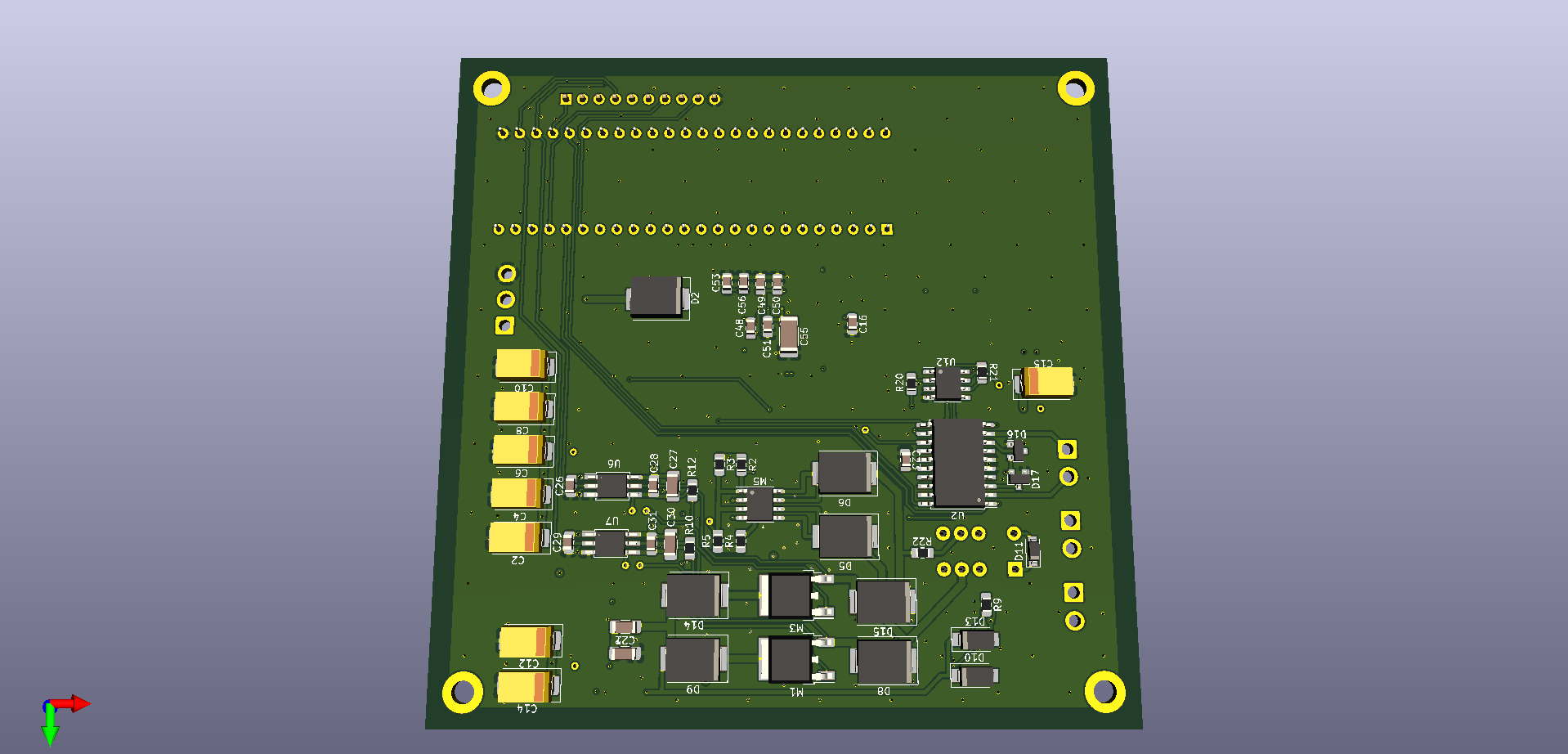

    The design of the Single Board Bipolar TX w/ADuM4120 MOSFET drivers has slightly changed. U1 has been changed from an LM317 to the smaller footprint AP2204K-ADJ; As per Mdtoday request, U16 and C55 have been moved physically closer to the REF pin of the LTC2378 ADC; orientation of Q1 was changed to reduce the possibilty of crosstalk affecting the gate; the orientation of various component REF disignations was changed to enhance readability.
    New PCB top veiw:

    New PCB bottom veiw:
Name:	TX single board(bottom).png
    Updated schematic:
    Bipolar PI ADuM Single Board Schematic.pdf
    Updated BOM:
    Bipolar PI Single Board BOM.pdf
    Updated Gerber archive:
    Bipolar-PI_singleboard_Gerbers(1-9-2020).zip
    Updated Kicad archive:
    TX_ADuM_single-board(1-9-2020).zip

        Looking really good!
        Given the ground plane layer, via stitching and your actual separation / positioning of the power input, TX switching and RX circuits, I think this board should be fine.
        I am part ways through checking the latest files and all is good so far, nice job.
        • @KingJL, I have looked over PCB and can't spot anything but will leave it a day or so and go over again.

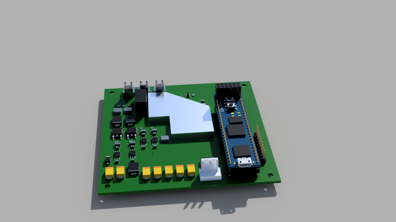

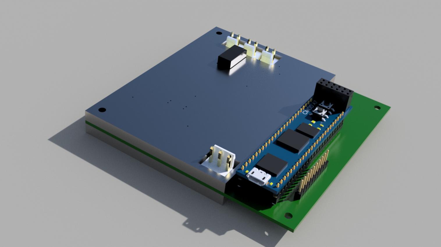

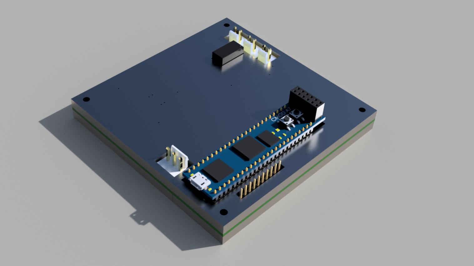

          I have also designed 3 versions of PCB shields, with my preference leaning toward V4 below
Name:	AdUm_TX v3_Shield_1.png
Name:	AdUm_TX v3_Shield_2.jpg
Name:	AdUm_TX v4_Shield.jpg
          These are very preliminary drawings just to convey the idea.
          All versions would be 3D printed and outside sprayed with super shield nickel spray

            I kind of like V4 also. Is heat buildup (especially in the TX area) going to be an issue?
              If we use some tin sheet top/bottom in those areas and 3D print the side walls, that should be ok I think.
              Press forming a thin sheet of tin is also an option.
              • Originally posted by Mdtoday View Post
                If we use some tin sheet top/bottom in those areas and 3D print the side walls, that should be ok I think...
                That should do the trick. The tin sheet can be secured to the 3D printed sidewalls with EMI shielding tape. I like it!!! Sounds like a plan!

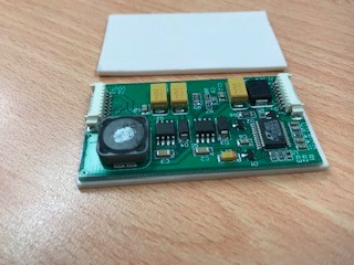

                  Also we could use something like this or this between the MOSFETs and the tin sheet. I worked on an automotive ecu that used something akin to these to conduct heat from the MOSFET to a metal case shield. Although those were a little thicker... maybe >=3mm and were black.
                    Also we could use something like this between the MOSFETs and the tin sheet. I worked on an automotive ecu that used something akin to these to conduct heat from the MOSFET to a metal case shield. Although those were a little thicker... maybe >=3mm and were black.
                    Yes, for sure, I use Warth heat transfer sheets for same thing in ECUs and this little 4 amp switch mode module, it's good material Click image for larger version

                      The idea of shields is good BUT - what is the purpose???
                      1- Keep external EMI out of RX circuit?
                      2- Keep EMI inside and from radiating- FCC/CE EMI compliance?
                      3- Which parts of the circuit need shield?
                      v4 will not work since it has a huge opening where the processor plugs in. This will allow RF energy in enter/exit.

                      From the shielding subject I am looking at the GERBERs to study grounds and current flow and notice a few things.
                      1- The 20V path on layer In2 goes to D1 through a single small via. Is this one via large enough and have low enough impedance? Adding a few more vias may be better.
                      20V to D2 should be ok since it feeds to REF regulator and op-amps. D2 could be a smaller diode.
                      2- It may be better to 'Split' the ground plane into TX and RX sections with a 'Star' connection at/near the power connector. This help keep TX circulating current out of the RX circuit.
                      3- Does the Processor module (plugs into J5) really only have One Ground pin? If it has more than all should be connected.
                      Great effort on this whole project and waiting for more results.
                          Part of this, I can answer. I will let @Mdtoday address the V4 issue as he has usually well thought out approaches to his design proposals.
                          The parts of the circuit needing shielding are the anlog RX circuitry, but it is hard to isolate all of the RX path as it consists of all current paths from the coil, damp switches, coil switch, RX blanking switch, pre-amplifier IC's, pre-amp out-put unipolarization switch, ADC input differntial coversion buffers, ADC input filter circuits, RX refernce generator, ADC refernce generator, and ADC analog supply. In fact "RX analog" includes much of the TX circuitry. This shielding is a further attempt to quiet down the RX, primarily for the 20 bit ADC envirionment.
