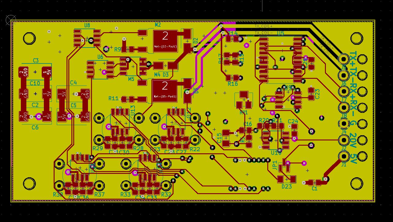

      I had to slightly change the two of the footprints for C21 & C22 (they are ceramic SMD 200V which did not come in a 1206 package) PCB layout and change C13 & C14 to non-polarized capacitors (although the footprints did not change. This resulted in an update to the schematic, the board, the Gerber files, and the BOM. They all have been updated and are included below:

            I had a look over your PCB design and it looks fine, the only comment I would make is the track width on some nets is a bit narrow for my liking (TX_A) for instance but still looks OK as is.
            The only reason I mention it is that during protototyping stages, the finer tracks attached to say S08 footprint pads tend break a little more often than .25mm> tracks with parts being soldered/desoldered and the low weight copper cladding combination.

              I have (I think) changed all of the 0.127mm tracks to 0.254. It took a bit of rerouting (especially around J9 ). Here are the updated files:
                    Nice work, yeah, that looks good.

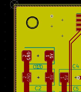

                    The only other very minor thing is top overlay, some resistor markings (R32,R33 etc) overrunning transformer solder pads and C3 moved up.
                    I have attached pic but didn't post the KICAD files not to be lazy but rather just to have one set of originals.

                      Picky... picky... picky! I have adjusted those as much as possible... should be clearer now. Also added 5V to pin 19 & 20 of J9 to support my intended FPGA interface ( will post that board shortly ),

                          Haha, yeah, Just thought while you are at it..
                          Your gonna hate me....C3 txt needs a shuffle... I'll shut up now
                          Ok on the 5v to J9 sounds like a good idea.
