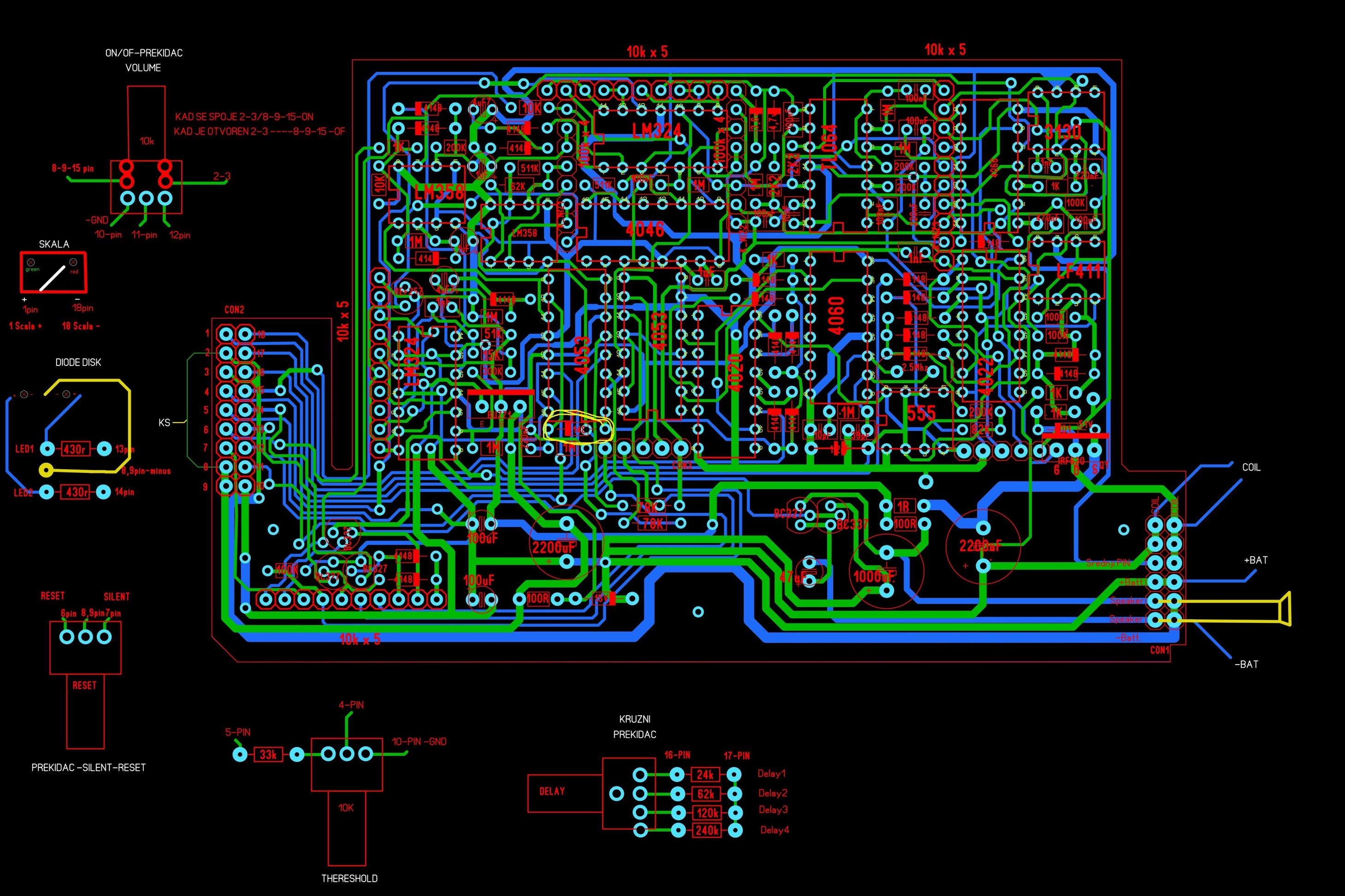

    • Good evening, I found another discrepancy in the schematic and the board. Look at the diode circled in yellow!
      • Like on pcb just rotate 4148​!

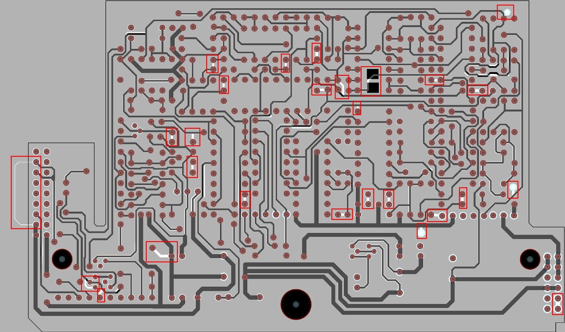

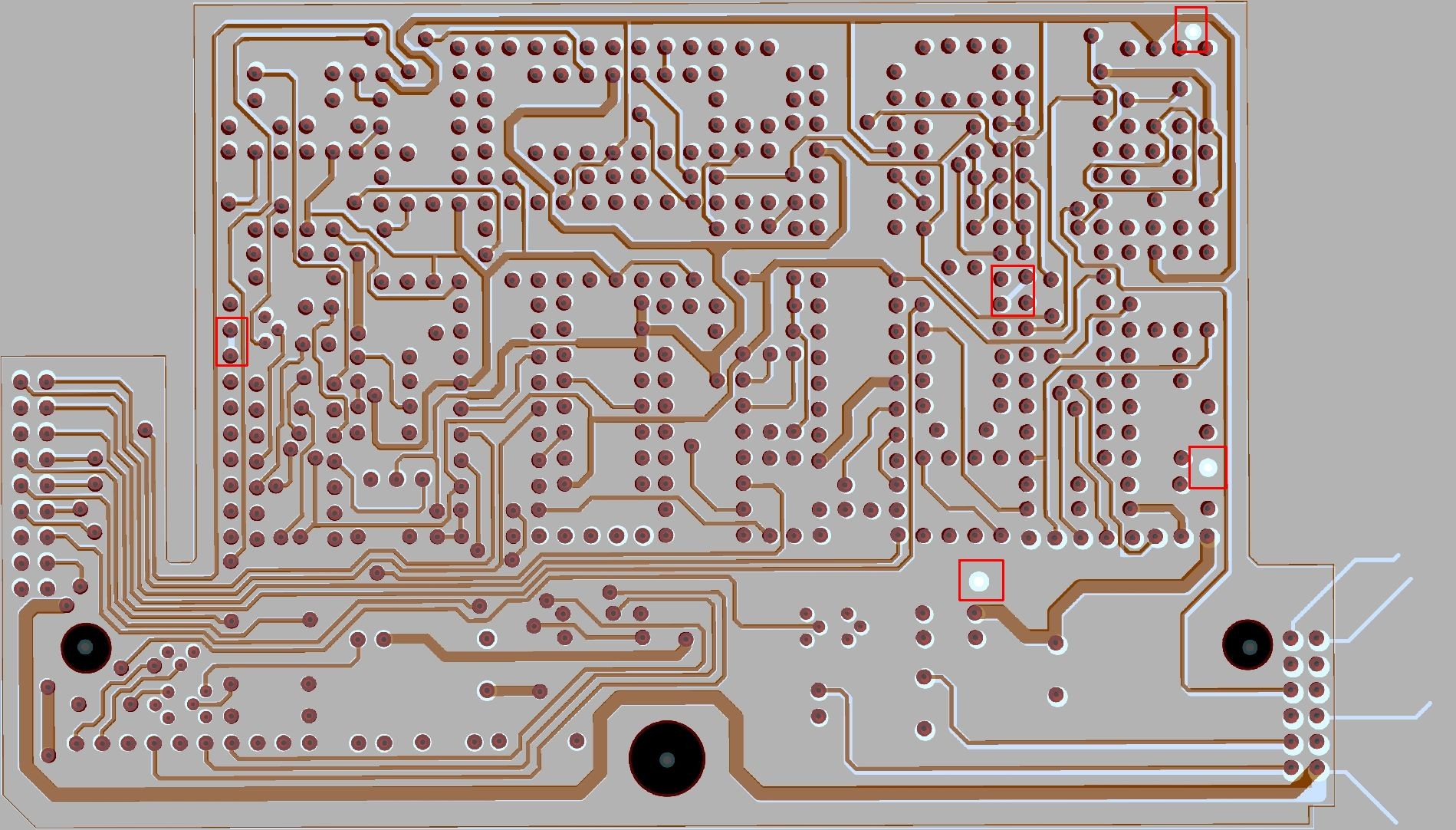

                  PS2 zip, difference in PCB Board 1 and Copy of Copy of Board1, layer C1 image C1B1vs C1CCB1 and layer C2 image C2B1vsC2CCB1.
                        Nicely written the pcb I put in is 100 percent correct! So is the schematic with the two silly mistakes with the reverse diodes. Everything is correct!
