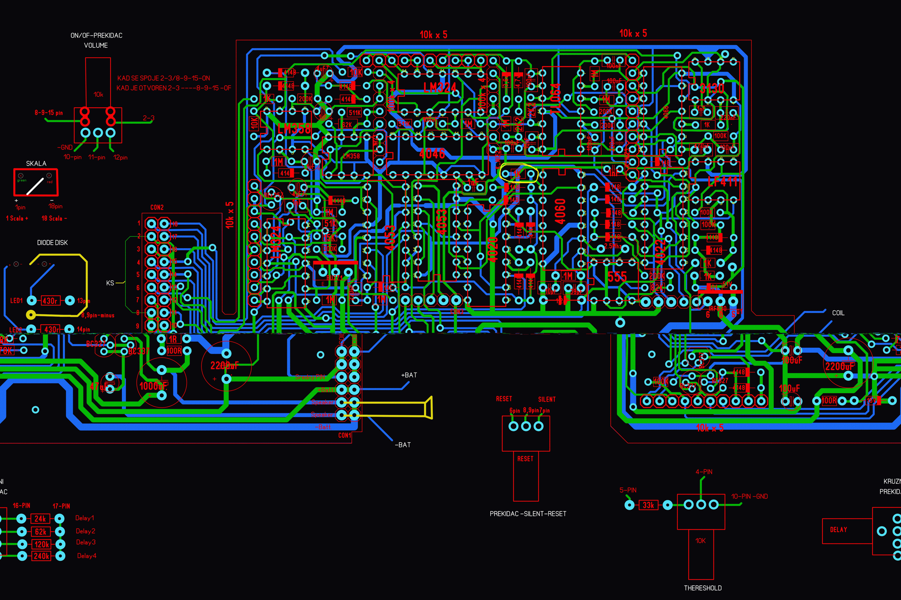

        Here is the correct schematic of the Pulse Star 2 motherboard​!

          PCB

                        In the schematic of the motherboard, both the positive and negative terminals of the 2200 uf capacitor, above the speaker are connected to the 12V power supply circuit, which is wrong.
                        I think the negative terminal of the capacitor should be connected to -10V.​

                          • That the 2200uf capacitor goes to the plus 12v battery and to -10v , that's the only mistake, follow the pcb! As for the diodes on the mosfet, it says 51v zener! And you try what you want, the original module uses 51v zpd!​

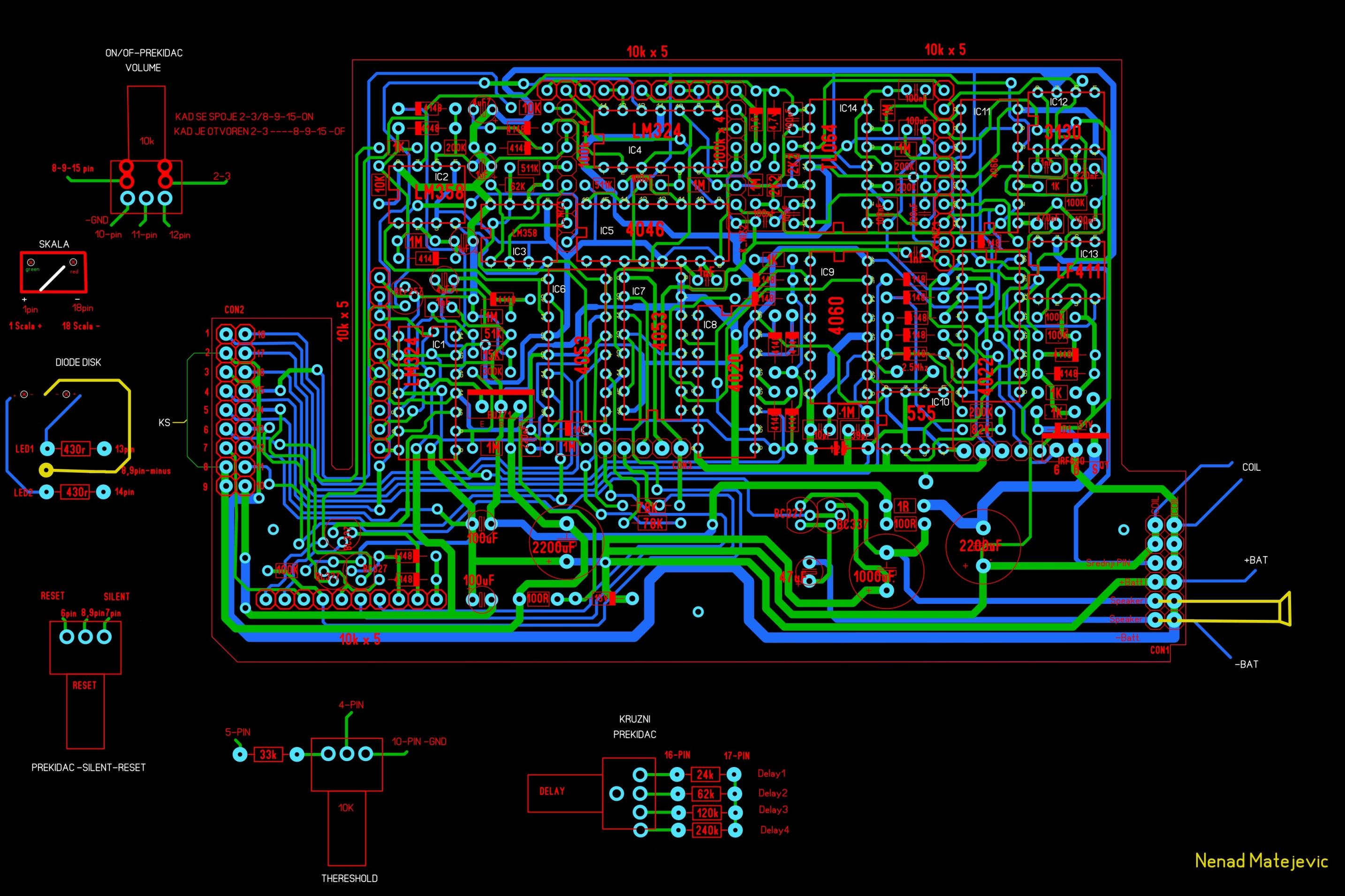

                            You already have a pcb from one member, I didn't follow the topic in detail, just compare my photo and fix the pcb that I think was put by Dbaner?! And you have gerber ?! Some people could try a little harder..​
                            All correct!​ PCB!
                                All correct!​ PCB!
