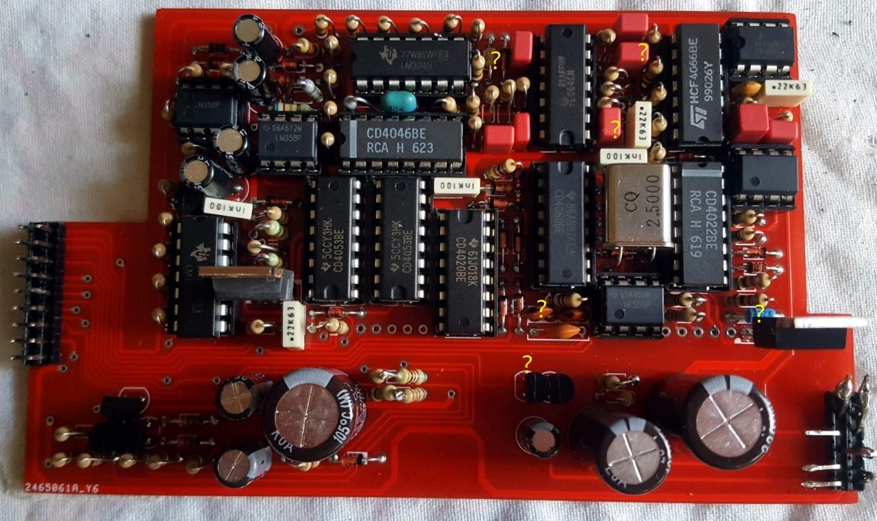

                          • I have a PSII circuit, I don't know the value of some parts, please help me.​
                            • Originally posted by milad.mohammadi13131 View Post
                              this is a pcb of Orbit. pay him for the boards and you will get sch, then share it with us.
