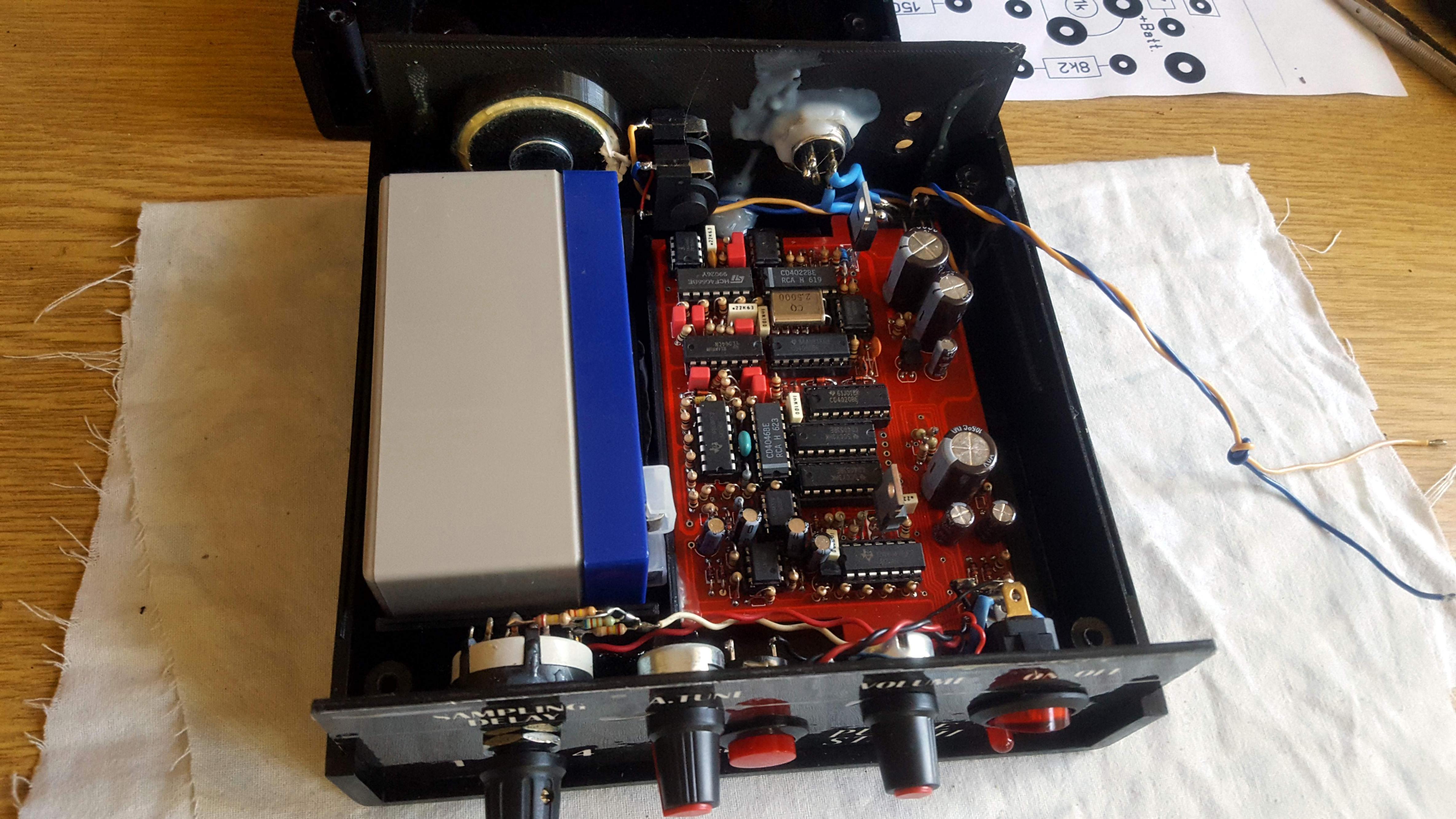

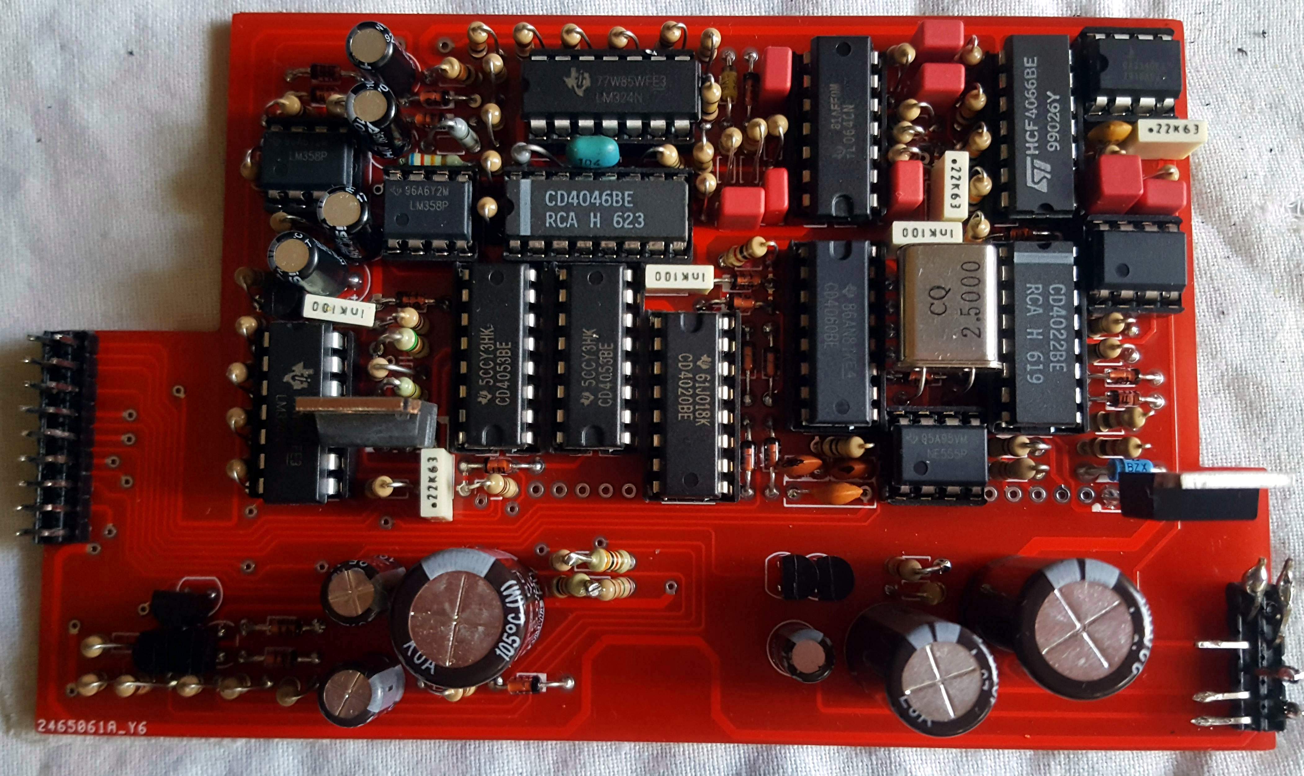

        Number two about to be finished.

          Looking good!
            I did not know to put pcb pictures PS 2 where you can see parts so I gave it to Ivica to brag about something what I'm around 4 months I would be ashamed ,I gave it to you that for you and not to brag by my work...

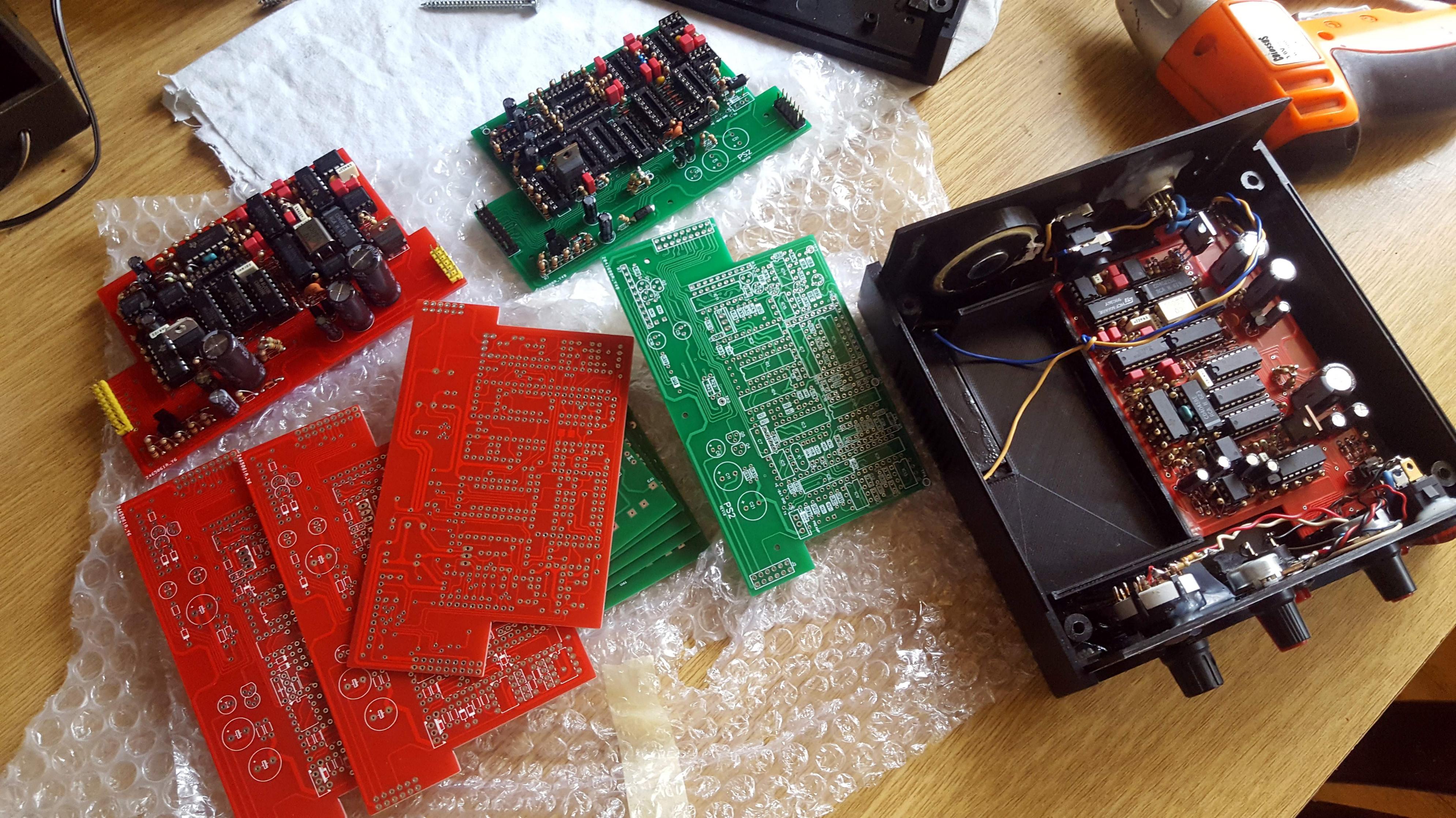

                  Today soldered two more:

                    Of course there is always more than i intend to show at first glance:

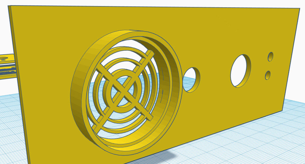

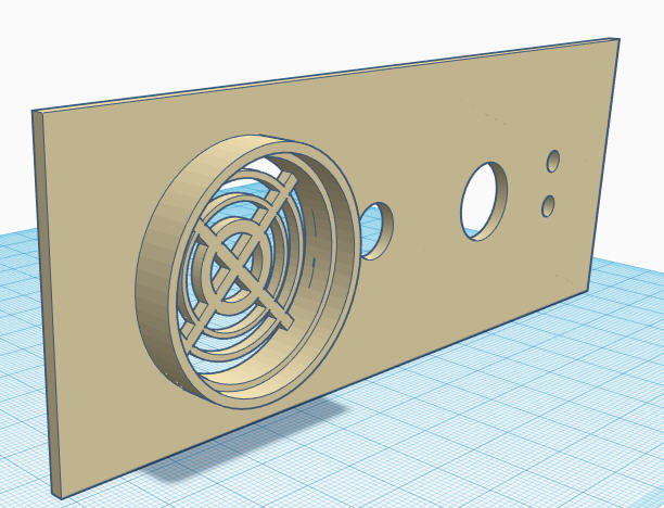

                              It s hard to obtain such speakers in local shops. Speaker is 8 ohms/2W but very slim, tiny, 40cmm diammeter.
                              Ultra slim, but very loud and splendid dynamics.

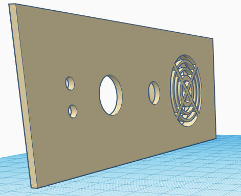

                              So what i do? I 3D drawn rear panel with special "pot" (round box as integral part of the panel) for speaker. Than i 3D printed whole rear panel.
                              Now it has even better dynamics and can produce low "bass" tone as well. Sounds the same (if not bit better) as original PSII.
                              Who ever saw PSII in alive and heard its sound; knows what i am talking about. It has powerful tone, pleasant and starting from very low.
                              How i obtain such speakers?
                              Only on scrapyard. Looking up for portable DVD players with LCD monitor included. You know, small ones, you can watch DVDs on your travel.
                              Those usually are having good sound. Thanks to two such speakers.
                              40mm diameter is large, providing good "air pressure" and wider range of frequencies that can produce. Splendid dynamics.
                              Also i scrapped lot of old laptops too. Great source of good speakers, suitable for our diys here.
                              Secret revealed!

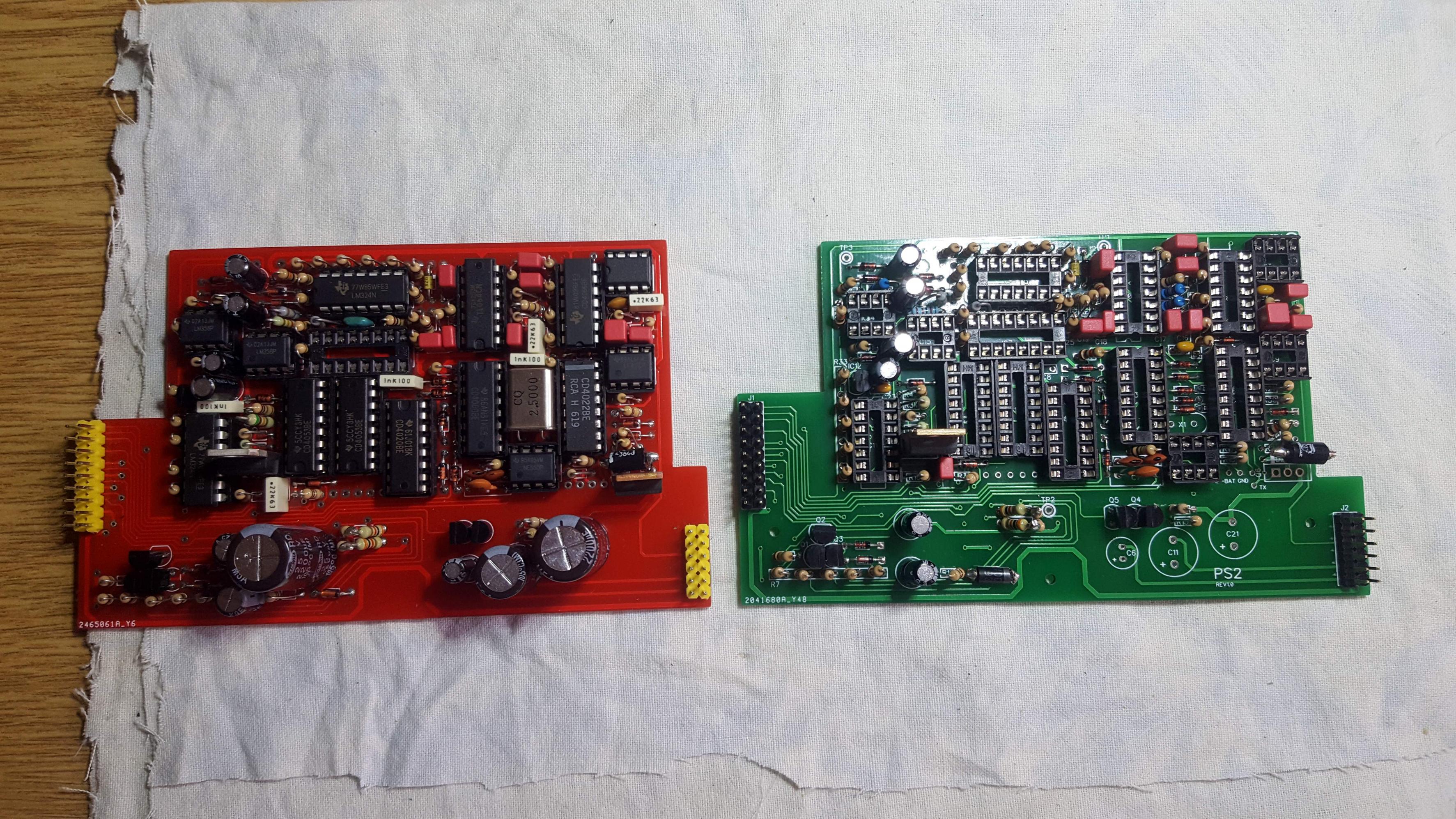

                                Originally PSII analog version is made of 4 pcbs.
                                Mainboard, front and rear panel boards and "disc" board attached over mainboard.
                                I tossed all and kept only mainboard. Everything i need is there.
                                Since Disc feature is not working quite alright on PS models, also not on PS2 Pro (with two Microchip PICs), it simply is not reliable and not presenting very useful feature; i decided to omit it completely from the design.
                                Orbit thinks he is original and the "first one". Small reminder. I bought my first PSII Pro back in 2001. Worked with it for couple years and than sold it. During the years i got one analog PS II (without Pro).
                                I am using Dichloromethane in my practice for several years back. What he claims that he did in 4 months; i could do in 40 minutes with Dichloromethane.
                                But i don't need to do that, since Orbit was faster and did indeed good job previously. So i only used his work since he was friendly and shared with me. That's the main reason i am not able to share any more details upon this here.
                                I don't want to make him additionally angry on me. I promised not to share and i will not share.
                                But point is; i had PSII for long time, two units, i collected decent field experience and that's why i decided to omit disc board from it.
                                Front and back panel boards are redundant too. To use front board; one must have exact dimensions suitable scale, exact type of rotary switch and exact type of potentiometers and two position knob.
                                Otherwise front panel pcb will not match with just any components bought from local shops and it will end up pretty messy.
                                So that's why i omit front panel pcb and wired up all the commands with wires.
                                Rear panel pcb consist of battery monitoring, testing and charging circuit. Orbit noticed, later when he told me i noticed too; something from the rear panel pcb is slowly draining the battery, in time. Something is wrong projected there.
                                Also as with front panel pcb, you have to obtain exact type of components to match pcb. Otherwise it can turn messy. So i omitted rear panel pcb too.
                                I made my own SLA charger for charging the battery. And battery alert is already present on mainboard. When battery reaches lower limit; you hear 3 "beeps" in repeating sequences, alerting you that battery is drained.
                                So, essentially you don't need any additional info upon battery state. All you need is there on mainboard.
                                At this last diy i also omitted scale. Because scale is also redundant. No disc, so no use from scale. No rear panel battery monitor and charge; no need for scale too.
                                Scale is deflecting as the sound in speaker arise. Big deal. Who needs such additional information? Sound is quite enough.
                                So i omitted the scale too. To make things much simpler and more practical on front panel.
