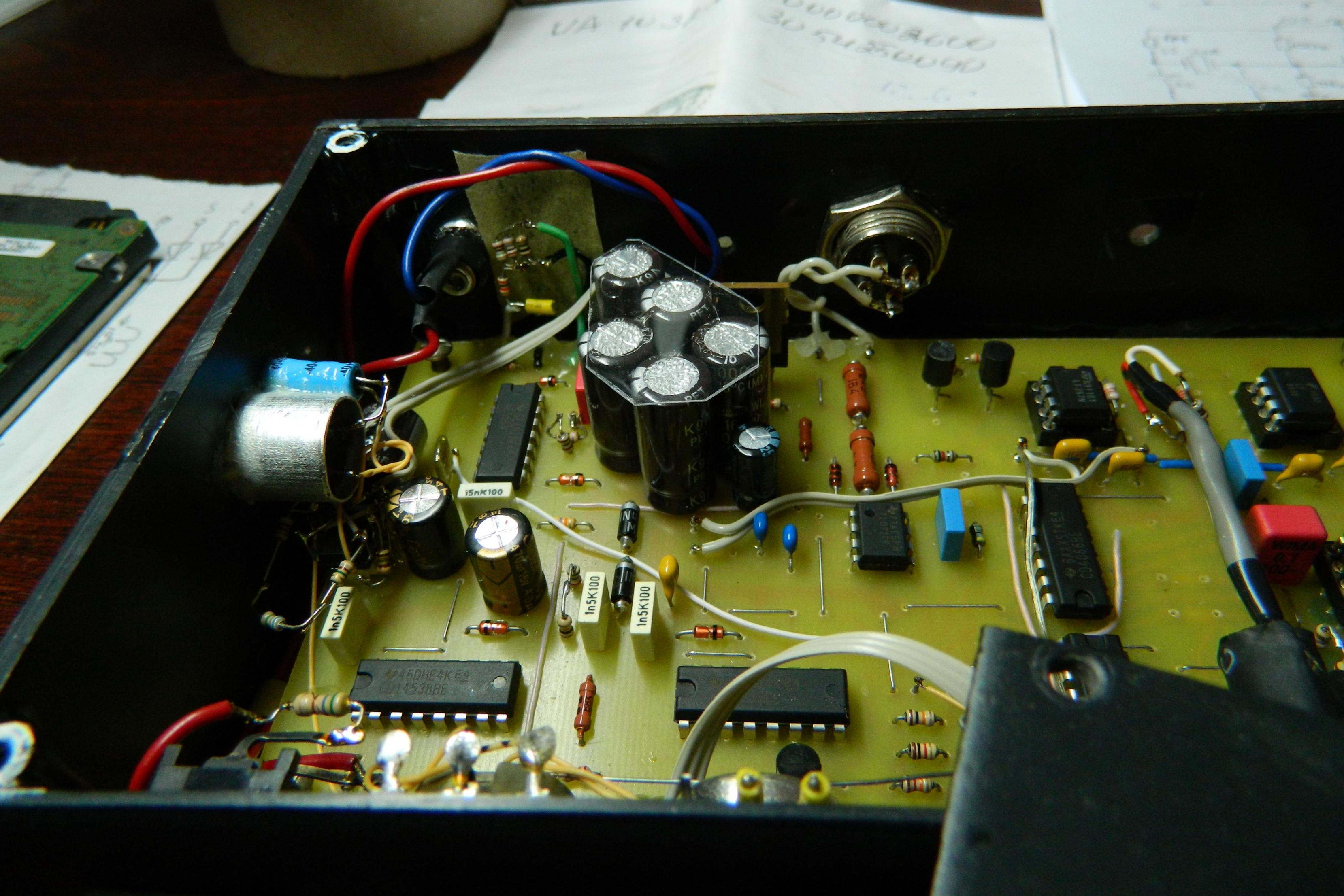

    I use pc speaker buzzer and made magnetic shield for that speaker, from aluminium pipe.
    Vadim, aluminum is not material that can provide magnetic shield. But It is good as RFI shield.
    • #47
      Yes, but aluminium shield form closed loop outside of the buzzer.
      Same electromagnetic shield for transformer Click image for larger version
      My shield on pc buzzer Click image for larger version
      It better to use copper foil and more than one winding.

          Yes, i use ordinary pc buzzer in delta pulse. It sounds better than piezospeaker from clock)
          loudness is near around acceptable and i already tested it in field.
          Yes it sounds more like a toy, but audible.
          No i havent, gues with 50% duty cycle vco and nice speaker it make sound like sportcar engine

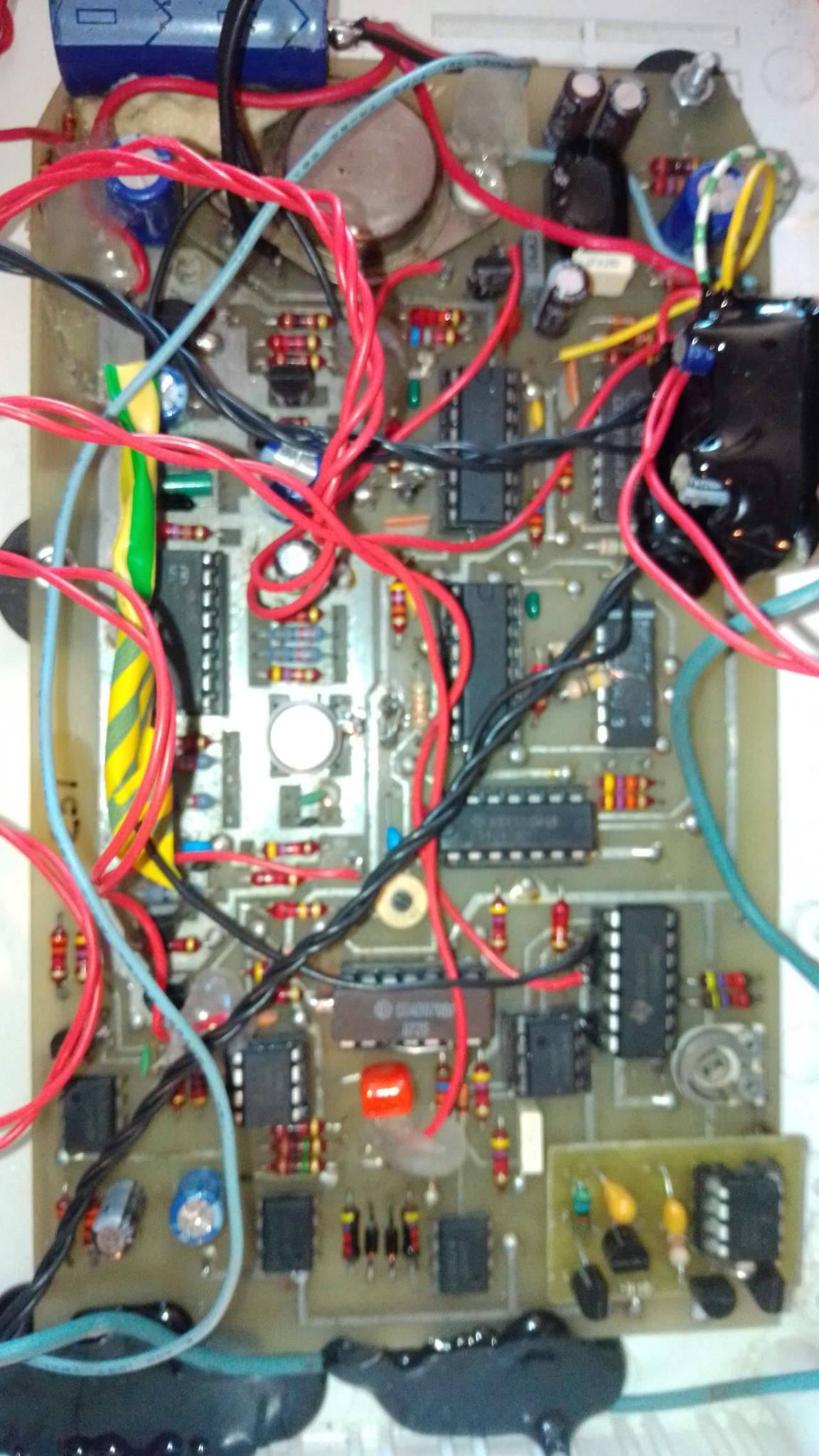

                        Puls Star 2 is very stable it is much more stable than delta pulse,and secondly every device almost always turn out exactly the same when u do...difference PS 2 and PS 2 pro does not exist ,i would say the analog is more stable I almost compared analog and pro "discrimination" it is better on analog than pro!You can also improve his work influencing the delay control processors and you can't play with it, there are little tricks that improve the depth of PS 2 and stability....Each have their own opinion but it is my opinion that Delta Pulse much worse combination from the DBP 2100 or Superdec and Pulse Star 2 or Lorenz ! Superdec for example has a pulse width which is just for coin hoards . Eric Foster described pulse width for coin hoards 500-800us...I almost measured. Click image for larger version
ID:	358118 Superdec reworked tonal part as on PS 2.

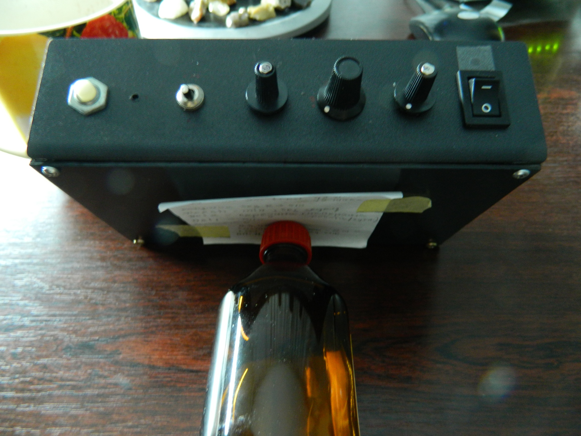

                            You 100% right Jose, thats why in my DP i use only 3 regulators and one switch at front panel for gain selection.
