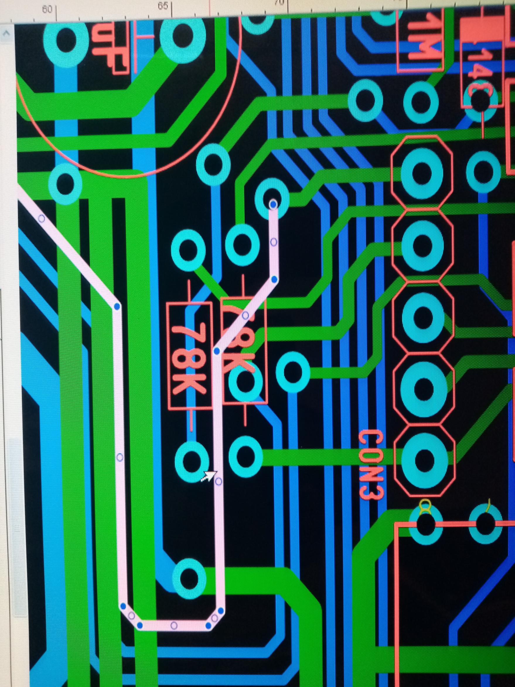

  • Thus, this resistor is not on the board/look at the PDF/. Question - will it work without it? It is not a problem to solder from below. Thank you!
    • Originally posted by nejdet View Post
      That it works without it... I tried that later.When one of you has finished the device, I will explain some details, a certain problem will appear, but I will explain that in the end when you assemble the pcb! I will repeat for the third time the pcb is without error.

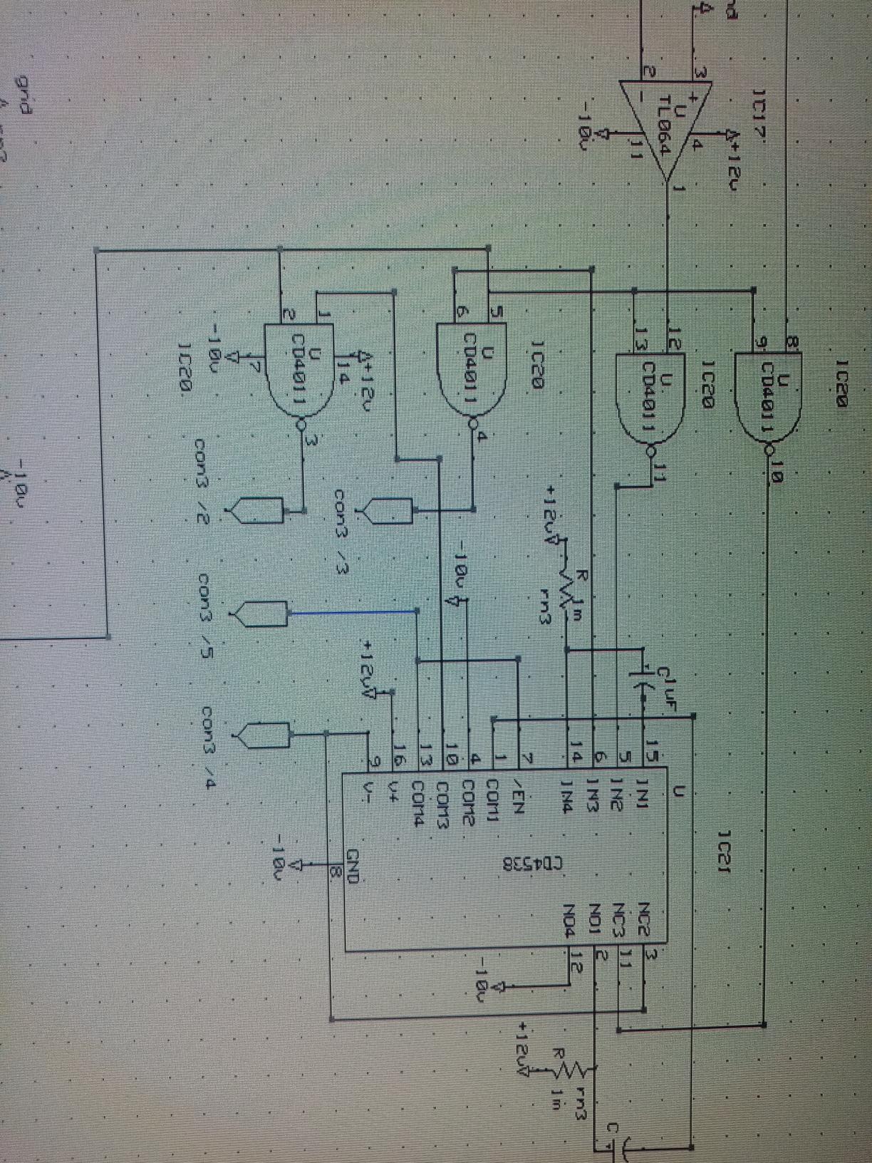

                  In the upper and left side of the schematic of the main circuit of the metal detector, there are two led that are controlled by two bc327 transistors. Considering that the circuits of these two are exactly the same, what is the reason for using two diodes and for what purpose?​
                  • One shines on iron, the other on noble, the instructions state that discrimination works for objects larger than 10cm! Although in practice we cannot rely on discrimination. This also applies to Puls Star 2 Pro!The signal for iron comes from the main channel from the mother board, and for precious metals from the small board, it is connected to the base bc 337, where the input is also for all metal, i.e. iron!
                    • hank you Orbit
                      But in the schematic, the signal of both transistors is from one point.​
                      • [КУОТЕ=росхик;н429231]хвала Орбита Click image for larger version
                        Али у шеми, сигнал оба транзистора је из једне тачке.​[/КУОТЕ]
                        Жао нам је што иде преко 10к отпорника до базе бц 327 са Цон 3.
