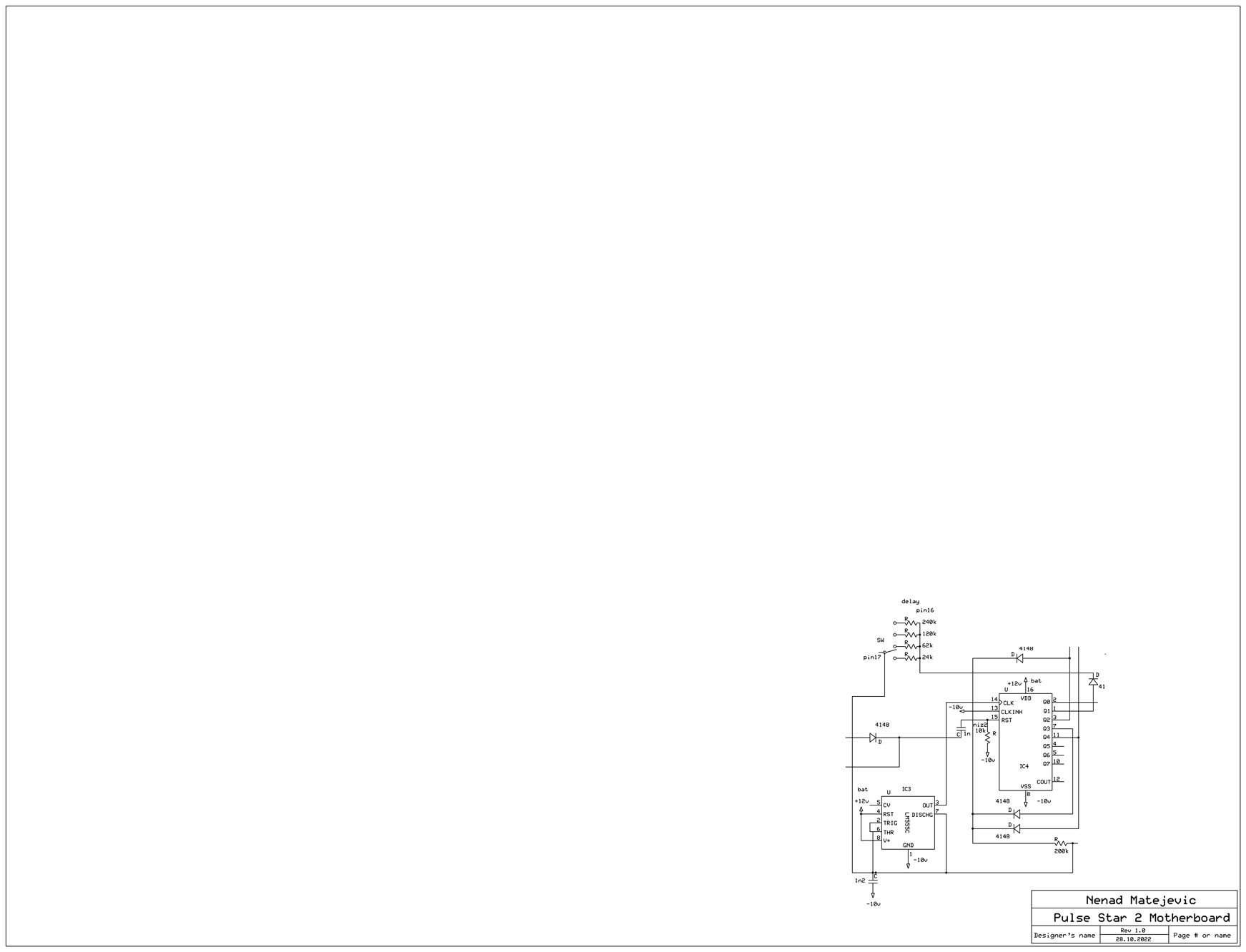

              • files:
                • PDF schematics were made on 26/06/2015. and I received them and recorded them on my archive disk on 26/12/2015.
                  I got them in a fair trade with a friend from Turkey.
                  Everything else on this topic is empty talk.

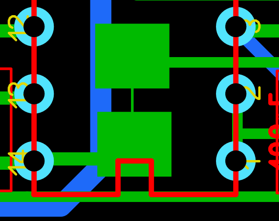

                  • PCB connections are correct, no error, work immediately without problems.
                    PCB files only require a little tidying up, not all holes are translated into "through-holes", there are elements that are in the wrong layers, etc.
                    I guess a friend from Turkey gave me those files during development.
                    So they just need to be moderated a bit, but the traces, vias, connections are all 100% correct.
                    Ok, don't worry, I'll give you everything on a platter, arranged...
                    pay attention to this one detail, these two rectangular parts of the print are there unnecessarily, they need to be joined.

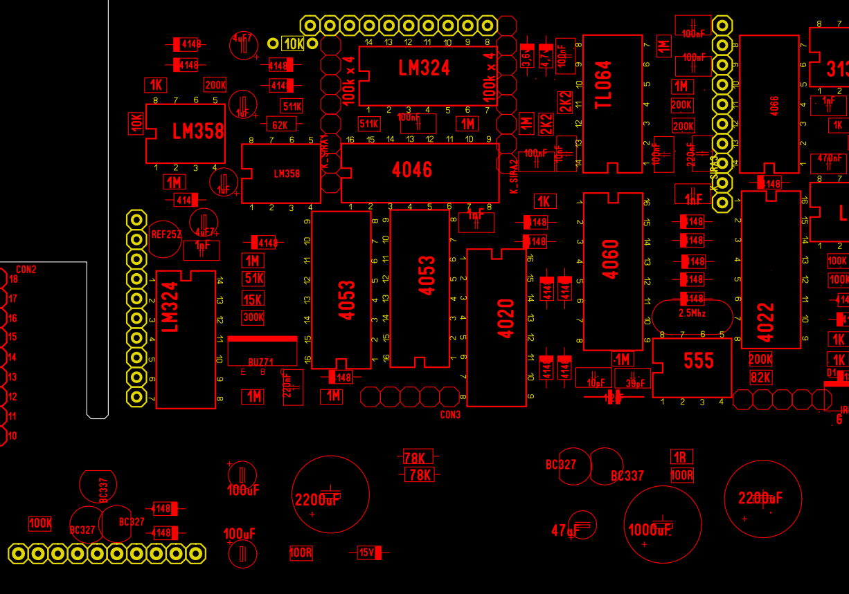

                    • Here are the sorted pcbs, these are the files that I directly use to make the detector.
                      The first detector I made with a set of all pcbs.
                      And then I left out the pcbs for the front and back panels.
                      I don't make them anymore.
                      Since then I only make "motherboard" and "disc" board.
                      And in the last few works I left out the "disc" board.
                      Although the "disc" board works alright; I left it out of my works because the PS2 serves as a "depth" detector for me,
                      there is no need for discrimination (which is not reliable enough on greater depths anyway).
                      "Motherboard_wirements.lay6" file will serve you for the final connection when you use only the mainboard because that pcb is
                      quite enough for the good operation of the detector.
                      If you want to test how the "disc" pcb works, just add it from above to the main board.
                      There are pin connectors and all you have to do is "plug" it into the main pcb.

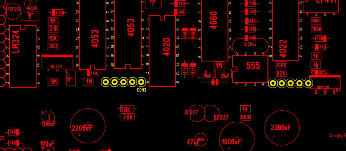

                      • Here, I have marked "resistor arrays" in yellow, so that everything is clear to you, so that it does not confuse you.
                        I don't use "resistor arrays", I use ordinary resistors, placed vertically.
                        • And in this picture I marked in yellow the two pin connectors with which the "disc" board is connected.
                          It's your personal choice which pcb you put the "male" or "female" pin connectors on.
                          I put "male" on motherboard and "female" on disc board.
