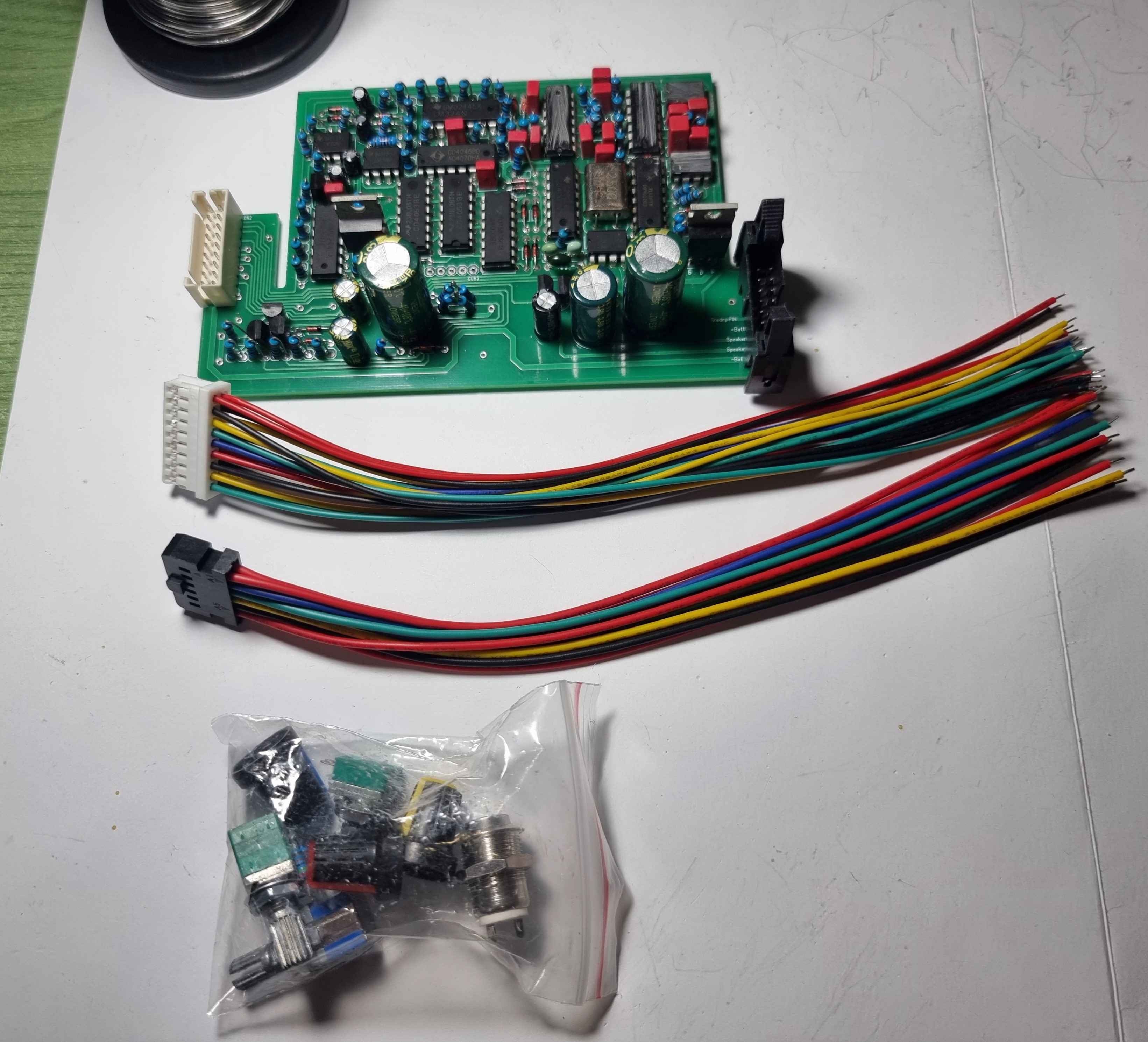

        I just received my Pulse Star 2 from Aliexpress. Congratulations on the great work you've done.
        Thanks to you I have had the opportunity to test this detector.

          What are the specifications of those four erased ICs?
          • Hello.
            The integrated circuits are completely erased and absolutely nothing is visible. I assume they are: TL064, CD4066, CA3130, and LF411.

              No, these are not ICs, they don't work.

                Everything is exactly as I stated on the pcb and on the schematic! It is possible to use lf444 instead of tl064 for greater sensitivity.
                  DISC board is filled by epoxy and that why it is invisible. the pcb is above on a photo and you have to see mark DISC PCB on it. Click image for larger version
