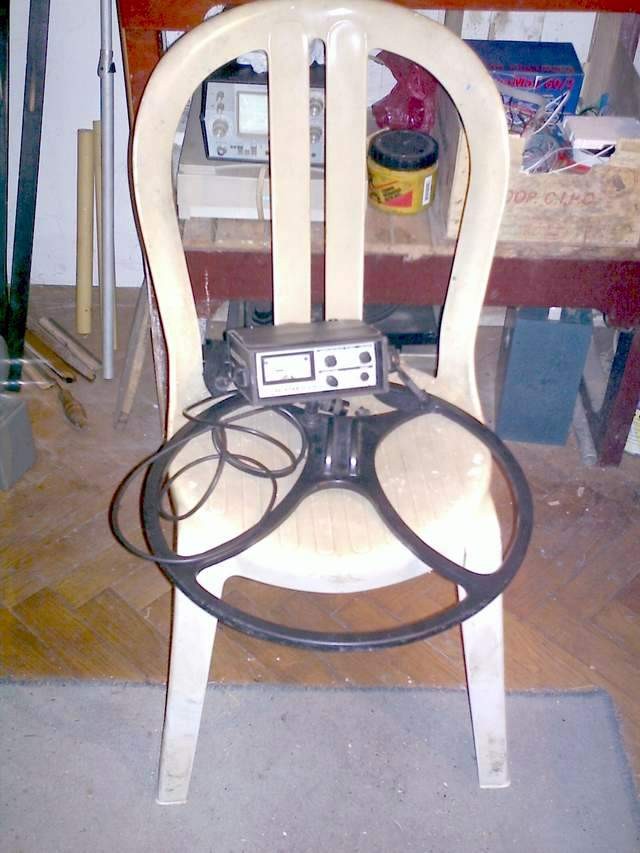

                              I bought my first Pulse Star 2 Pro sometime in the early 2000s.
                              I sold it to a local friend sometime around 2008 if I'm not mistaken.
                              A friend still keeps it and uses it.
                              I had coils 45cm and 2x2m.
                              Only later, a couple of years later, I heard that before the "Pro" version there was a regular "2" version, analog, without a processor.
                              The "Pro" version has a couple of flaws. It is unstable, often giving vague silent and unstable signals.
                              Even then I realized that I don't have much use from its "Discrimination".
                              But that is why it is exceptional as a "depth" detector. Of course, on targets of medium and larger size and mass.
                              The method of working with the PS2 (and Pro) versions is such that you achieve "stability" by raising the coil a little higher than the surface of the ground (the same as several Lorenz models that I later had the opportunity to use).
                              PS2 is not used for detecting individual coins and smaller finds.
                              PS2 is only used for rough locating of larger targets, at greater depths.
                              My brother-in-law successfully discovered a pair of gold earrings from the Roman period with the Lorenz DeepMax (he later bought it), but due to the enormous instability, he carried a 45cm coil at a height of 50cm from the ground!
                              Lorenz DeepMax is even worse and more unstable than PS2. Because it has a much stronger output stage.
                              It is very difficult to get it to work calmly and quietly. Usually you tune the Lorenz so that it emits a constant quieter sound and monitor the changes in sound that will be caused by the presence of an object in the ground.
                              Today, after so many years, we see that even the most modern Minelab PI detectors work similarly.
                              Why am I writing all this and mentioned Lorenz and Minelab?
                              Because these descriptions are a good guide for handling with PS2 as well.
                              Many years later when I made a couple of PS2 diys, I deliberately left out the "Disc" pcb for the reason that that accessory is absolutely unnecessary under the conditions described.
                              Today we have modern VLF I/B detectors to help us discriminate. And PS2, like most "deep" PIs, only serves us for deep targets. At such depths that discrimination will not work reliably anyway.
                              In your video you show how your PS2 reacts to ceramics, that's to be expected. Because the ceramic is very close to the coil. In realistic sarching conditions, this will not happen so often.
                              The coil will be at least 30cm from the ground. And the response of ceramic will always be much weaker than the response of metal.
                              That's the price you pay with a detector that doesn't have the optional GEB.
                              In other words; if you expect "miracles" from PS2, you are wasting your time.
                              The PS2 is a project from the '90s.
                              Quite backward and with many flaws.
                              Still usable but with the prior knowledge described above.

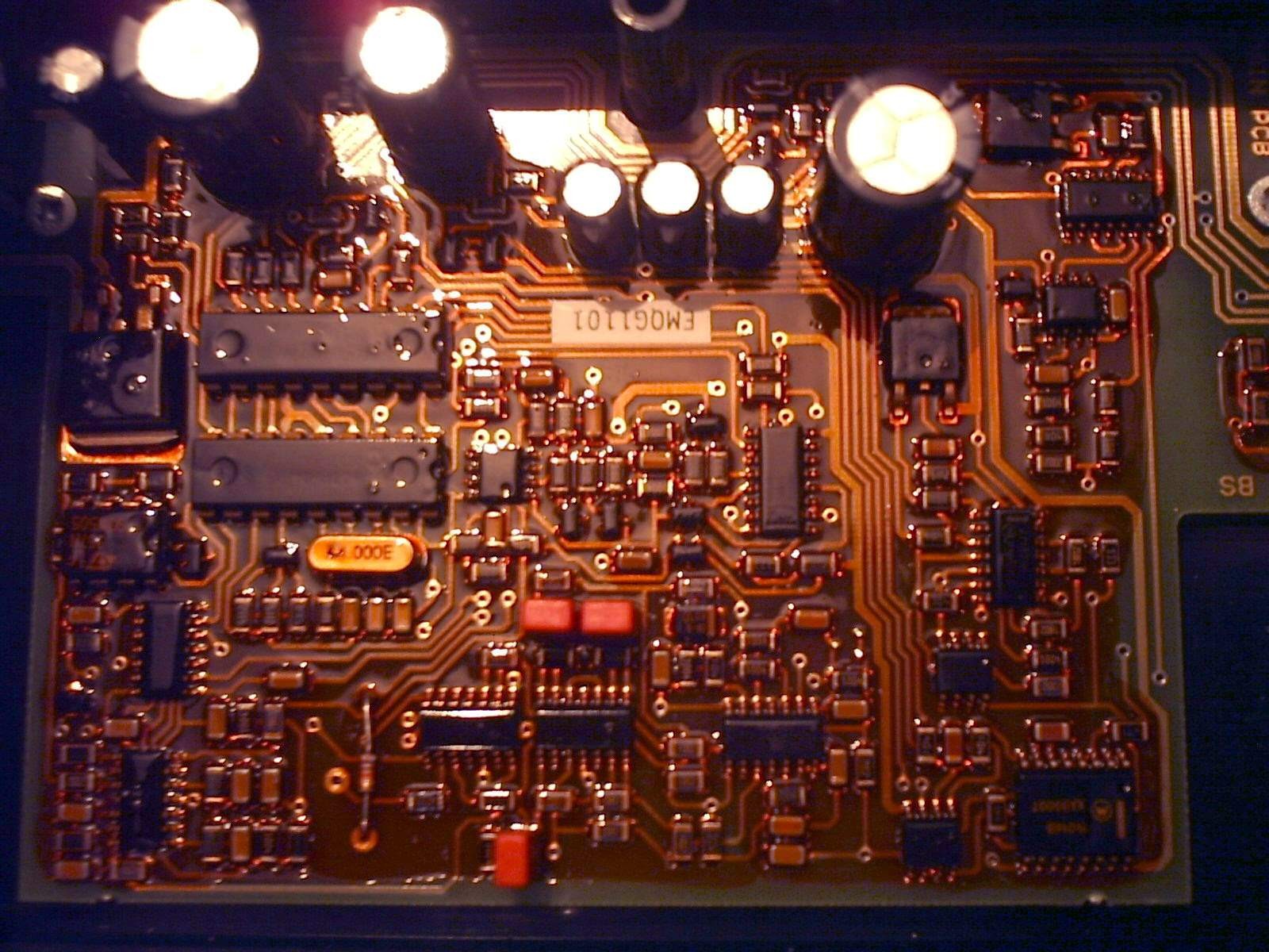

                              I posted these pictures on the forum many years ago as well:
                              (I tried to find the old threads on the forum but I didn't succeed.
                              Carl can answer this, has the forum suffered any losses in the meantime, has the forum database been damaged or disappeared, etc.
                              Because many of my threads and hundreds of pictures that I once posted are now impossible to find.
