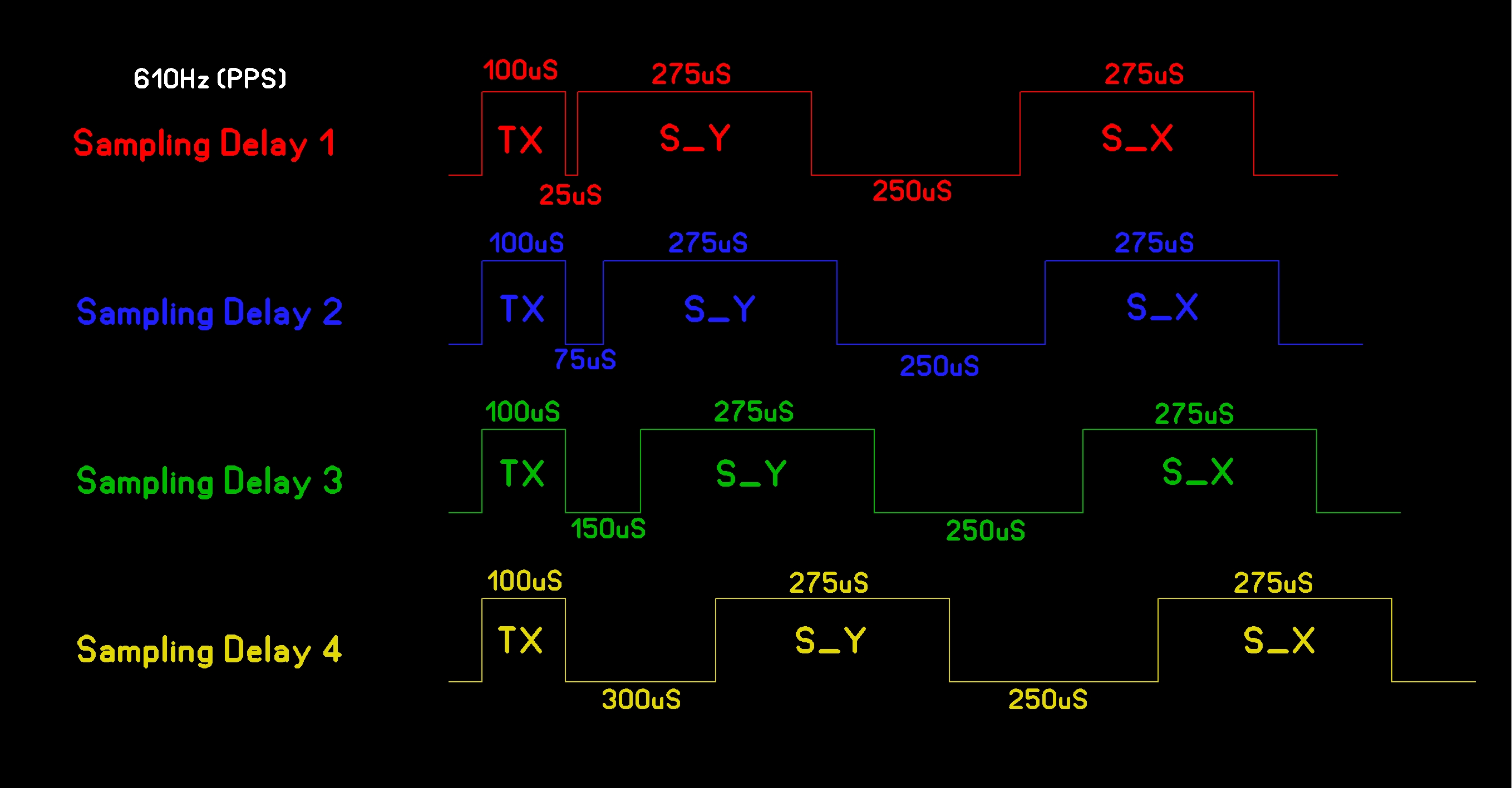

      What delay preset and pulse width you use (uS value) to match coil size/target size? What preset values should i use for delta pulse when using >60cm coils. Example 60cm, 1meter, 2meter coils. Thanks

            Obviously, from the timings schedule posted in previous post; only sampling delay set at position "1" will be suitable for smaller targets, preferably smaller diameter coils used.
            As explained with simple language (my most favorite) in the PS2 and PS2 Pro manuals; sampling delay set at positions "2", "3" and "4" will eliminate small surface items, ground mineralization effects and generally all the smaller targets, respectively set from lower to higher value.

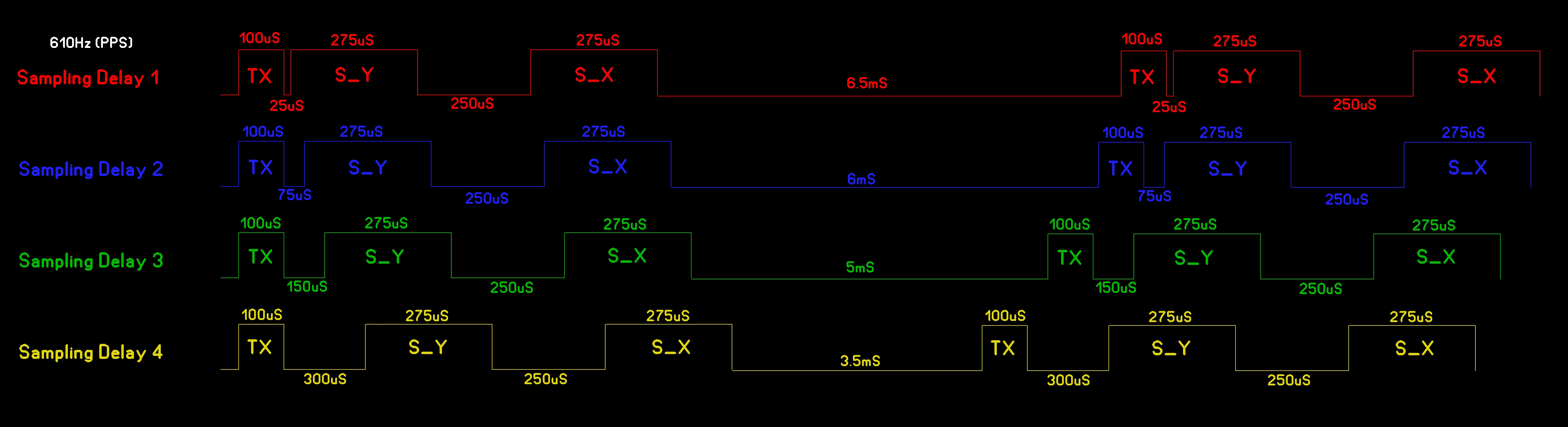

              Here comes the interesting part, which i don't understand quite well, will need clarification by someone more conversant:

                I haven't measured the timings (no scope right now but from these graphs) TX width is 100uS (somewhat lower than expected ~200uS).
                Sample Sy is the first sample with 25us-300us delay from TX. Sx is the second sample 250us after Sy. Sample widths are 275uS which is somewhat higher than expected (200us) but I guess it's OK. Frequency seems OK. If you want try to increase TX width up to 200us for better response on large targets. Timings are easily doable with MCU.
                • #68
                  Correct.
                  Although i measured with oscilloscope and draw those early this morning (barely awake); i think i didn't make mistake.
                  So, what is confusing me are those long pauses between cycles.
                  Long and so different between choices from "1" to "4".
                  • #69
                    25-300us is the primary delay for skipping small items. 300us is rather high I think you get natural small items rejection with large coils anyway but this also reduces the amount of useful signal which is processed further I wouldn't keep it, probably ~150us (max) seems a bit more useful in my view.
                    3.5ms to 6.5ms (dead period) shows quite a bit dead period.
                    I would place Sx pulse at the end of the cycle (right before the next TX cycle) this way you won't get reduced signal for large Tc targets or just add 1ms between Sx and Sy to have better response on really long Tc targets.

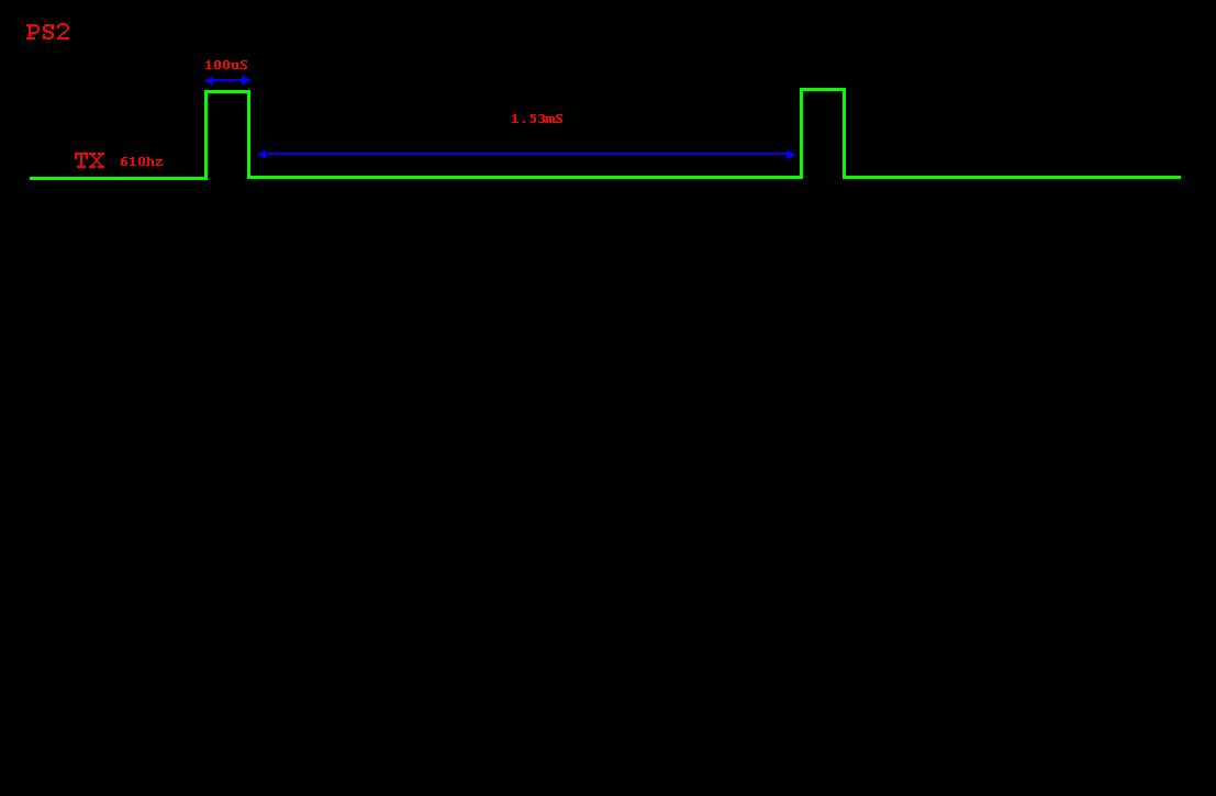

                      I was not interested in time at all but here's just the transmitter time..Click image for larger version

                          I was not interested in time at all but here's just the transmitter time..[ATTACH]53589[/ATTACH]
                          That's strange?
                          How did you measure that?
                          Whole cycle: is TX - 1.delay - S_Y pulse - 2.delay - S_X pulse.....certain pause ... again next cycle TX - 1.delay - S_Y pulse - 2.delay - S_X pulse
                          Now, you shall measure the time from point where S_X pulse ends to the next appearance of TX pulse.
                          According to your graphic; that time from one TX pulse to another TX pulse is much shorter than what i measured last night?
                          • #73
                            That's strange?
                            Measured at the gate irf640 pulse width 100uS time between pulses 1.53ms , I measured with a digital oscilloscope there is certainly no mistake! When I calculated the period you measured you have a longer period therefore low time 100us high time 1.53ms = Period (T) 1.63ms
