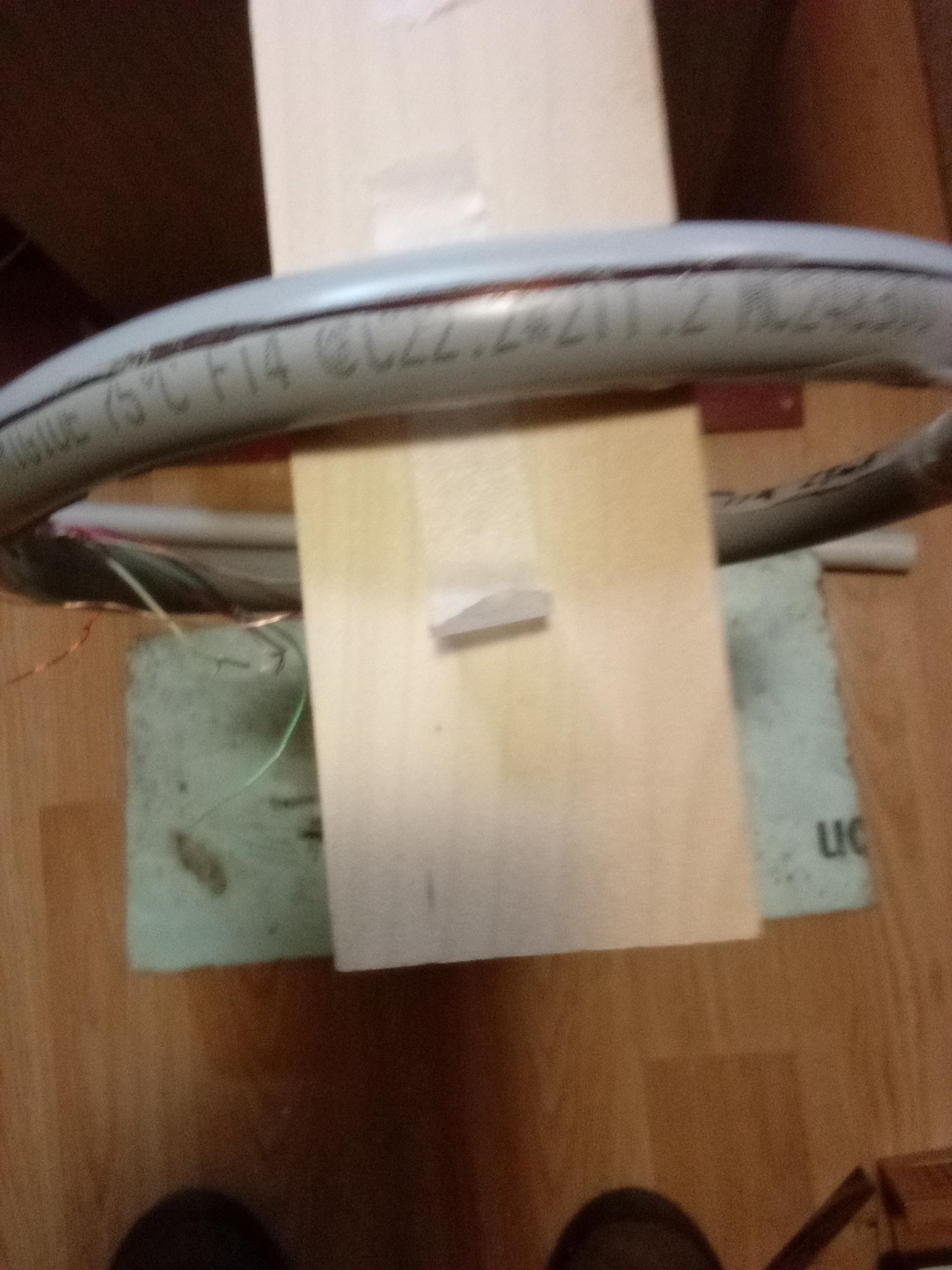

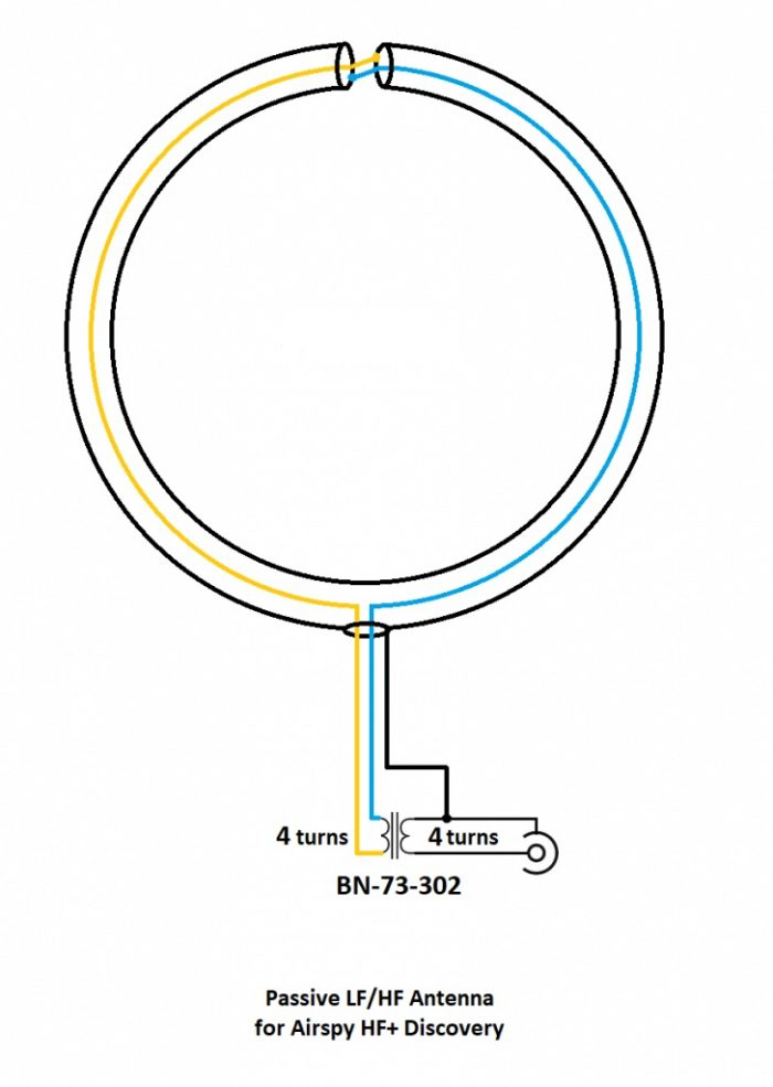

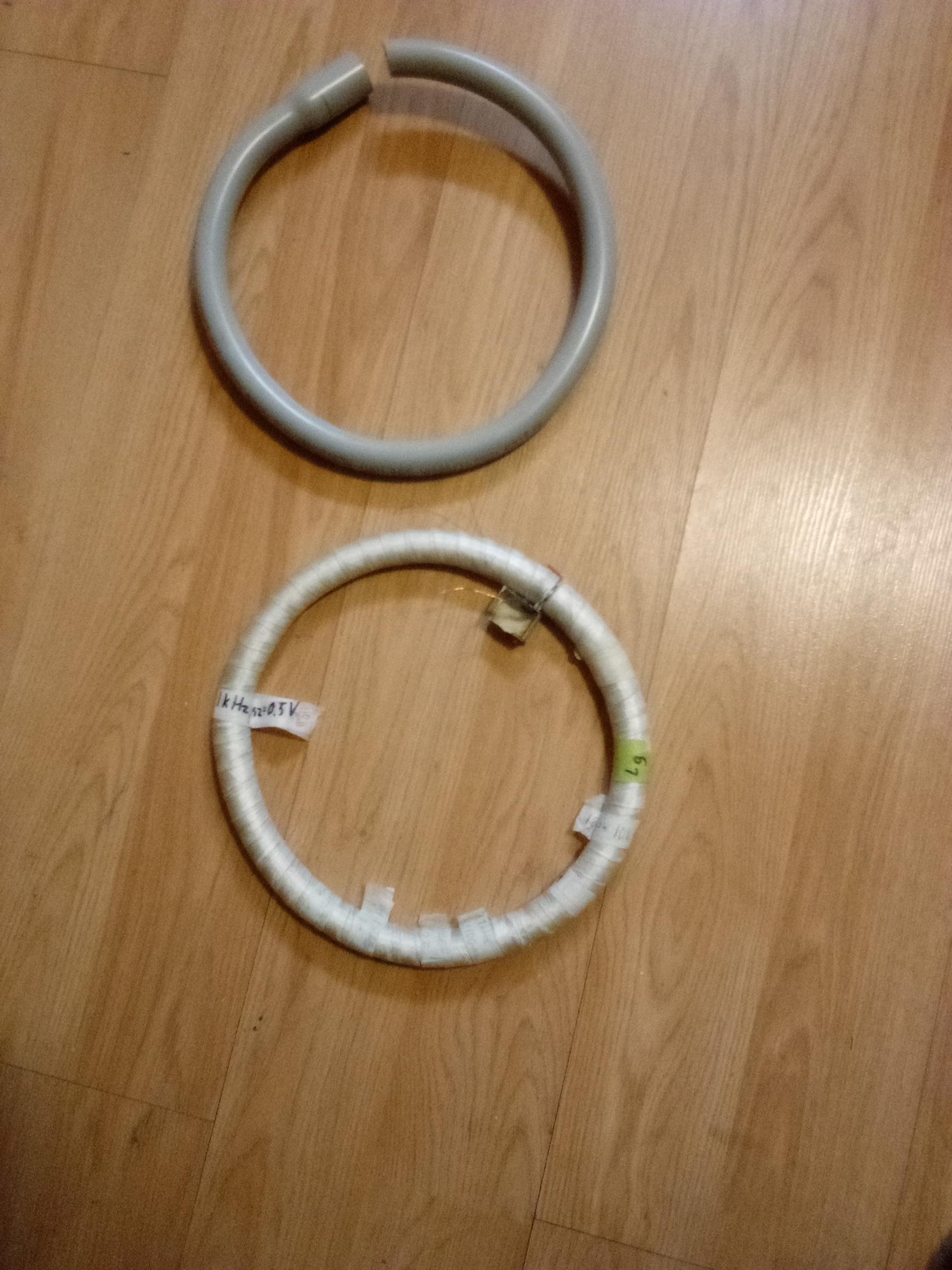

                  • #54
                    this coil has 300 pF capacitance to ground, thick wall pvc tube,
                    Click image for larger version  Name:	thumbnail_IMG_2024-01-23-10-05-18-279.jpg Views:	0 Size:	447.0 KB ID:	419342​Click image for larger version  Name:	thumbnail_IMG_2024-01-23-10-05-27-723.jpg Views:	0 Size:	421.1 KB ID:	419343​
                    to eliminate cable problem move Tx MOSFET and resistor to coil side = small metal box in first picture.
                    These eddy currents must be conducted (current) to ground.​ = but not through shield
                    Click image for larger version  Name:	image.png Views:	0 Size:	248.5 KB ID:	419344​
                    0 current through shield
