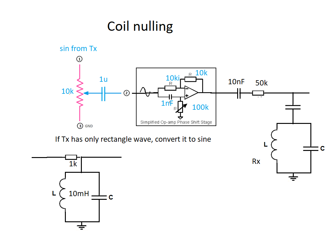

    my mistake was that I removed the top shield, adjusted the balance and then added the top shield again. = Leave it as it is and use the electronic nulling circuit (I described it earlier, check my posts)
    Electronic nulling is interesting, as it gives the possibility to re-adjust sealed coils. I tried to find your post with the search function but failed. Could you point me to your post or thread please?

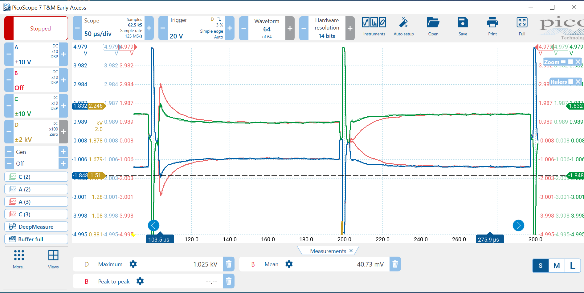

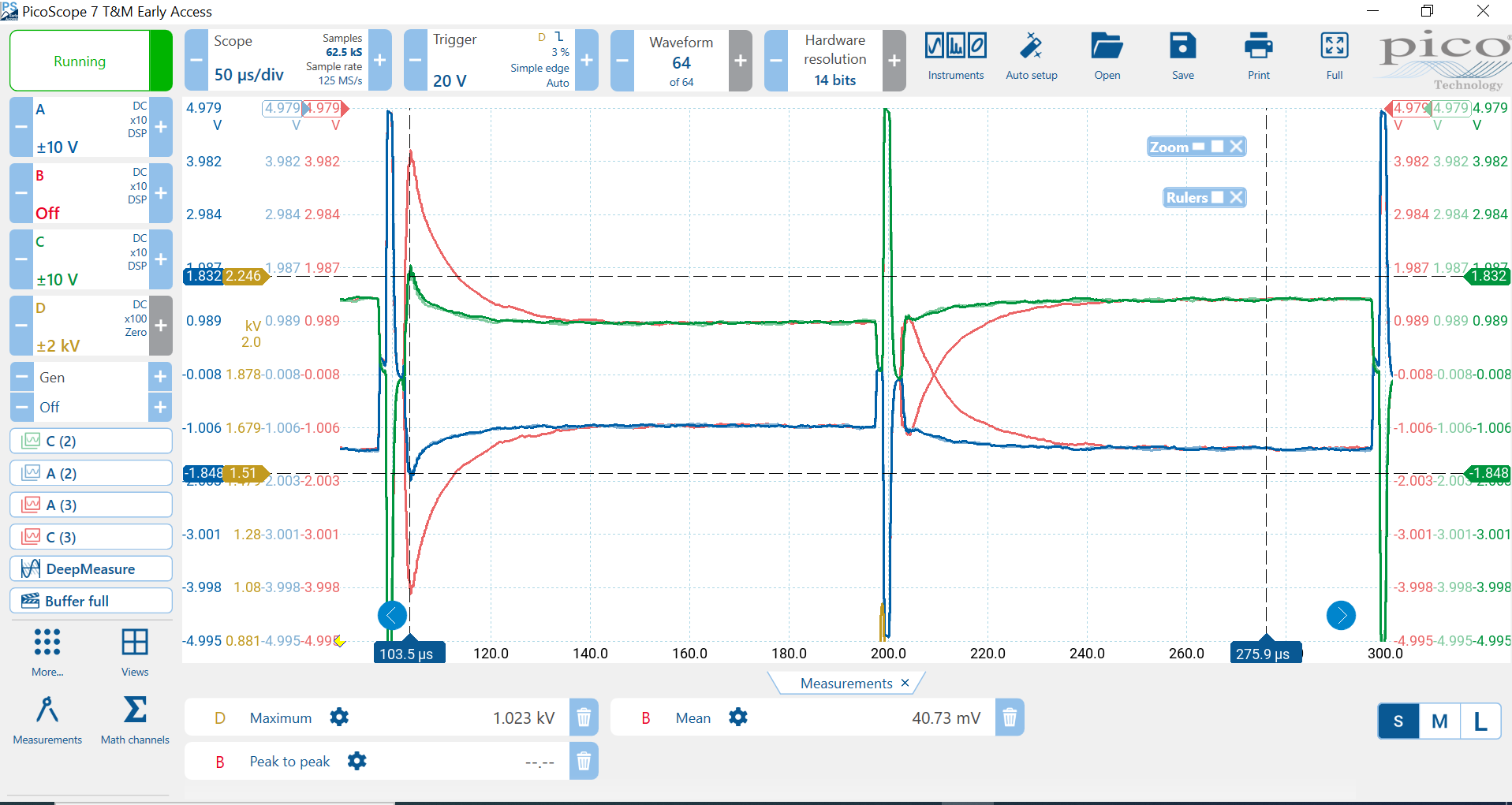

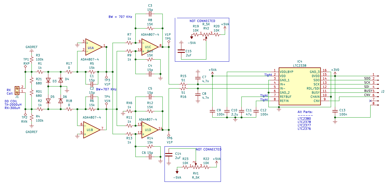

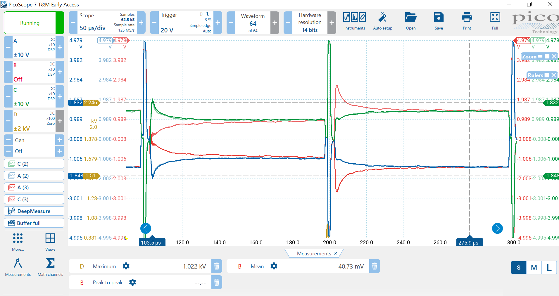

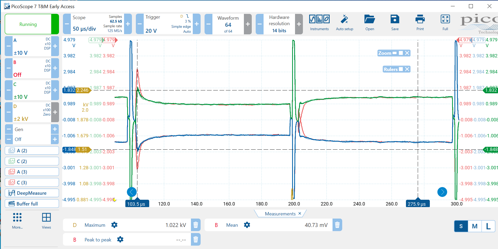

      PREAMP.pdf Click image for larger version  Name:	01-24-2024_PREAMP.png Views:	0 Size:	149.8 KB ID:	419389 Here is an update: The RX damping and the preamp as it is now.
      The following screen shots are the RX signals of the targets:
      The red trace is the target signal.
      The green and blue traces are the no target signals.
      1. 25x25mm foil
      2. Nickel / USA 5cents
      3. Lead coin, a lead ball hammered into about the shape and size of a Nickel
      4. An iron coin of about the same size of a Nickel. Notice how the iron target signal is inverted.
      On the schematic I also show the continuation. The input into an ADC.
      My questions are:
      1. How does the offset of the A and B waveforms fit into the ADC?
      2. Do we need to adjust offsets? Click image for larger version  Name:	01-24-2024_FOIL.png Views:	0 Size:	213.1 KB ID:	419390 Click image for larger version  Name:	01-24-2024_NICKEL.png Views:	0 Size:	210.1 KB ID:	419391 Click image for larger version  Name:	01-24-2024_LEAD.png Views:	0 Size:	222.3 KB ID:	419392 Click image for larger version  Name:	01-24-2024_IRON.png Views:	0 Size:	225.5 KB ID:	419393
      3. How does the ADC react to the overlapping waveforms? Most notable on the lead target.
          My questions are:
          Shouldn't be an issue. The ADC literally takes the differential of the 2 inputs and digitizes, so the offsets will add, but the LTC2338 has gobs of input range. If you want to minimize the additive offset then add a slow autotune circuit to both final opamps. Do a mathematical subtraction of the signals on the oscope to see what the composite waveform will look like.

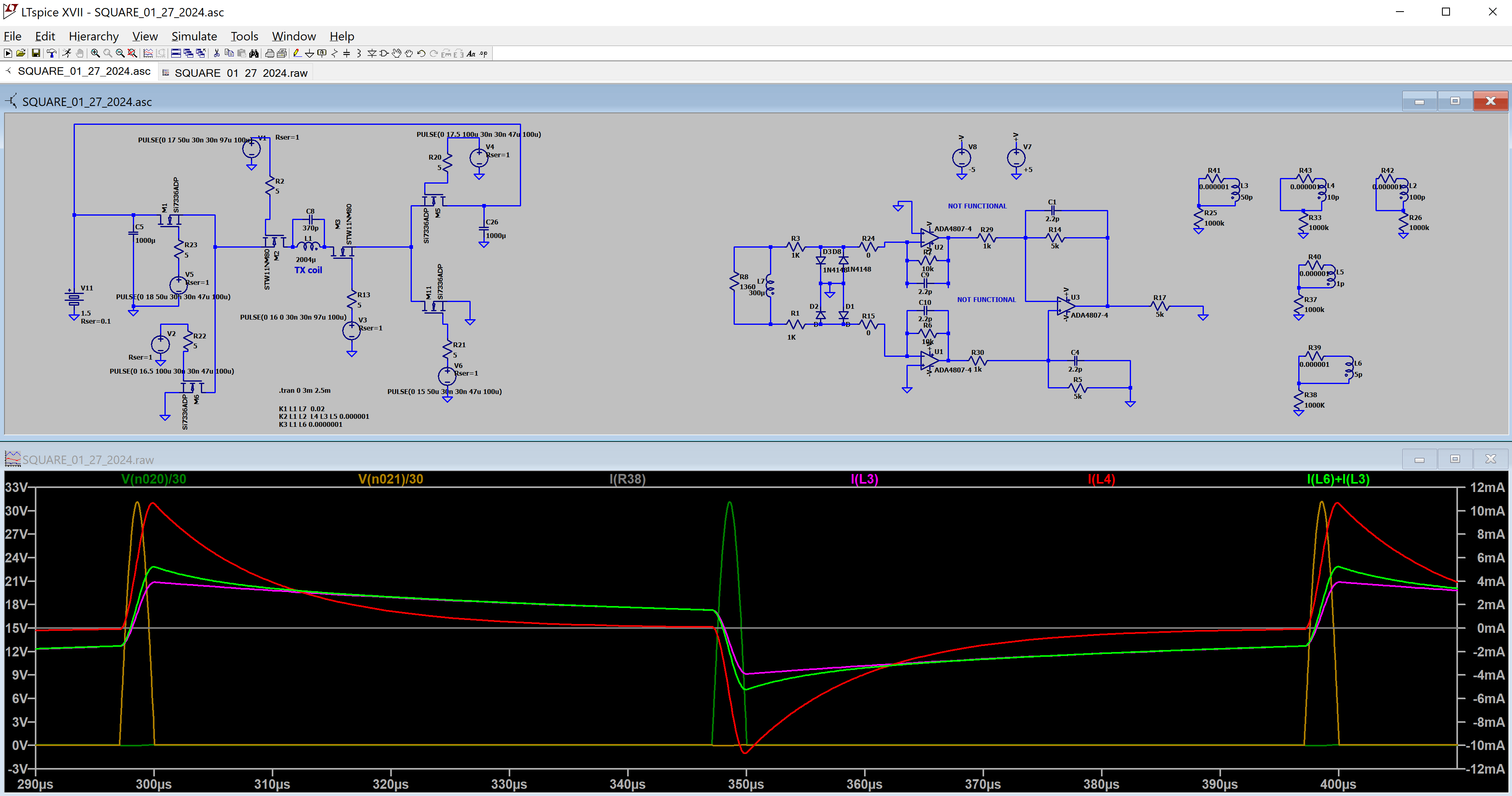

ID:	419442With the signal in the ADC, we need to start thinking of the digital signal processing. If we sample every slot at 1us per slot, we have a fair representation of the decay curve without target. If we save this curve, we can then subtract it from the decay curve with target and ground.
            Why should we look at the whole decay curve and not just a 2 or 3 samples?
            The decay curve is an approximate exponential curve. Any target or ground changes this curve. Often the resulting compound decay curve is composed of more than one exponential decay curve. For example: Iron produces a short TC decay curve for the magnetic component and a long decay curve. T ​​he long decay curve is very similar to the long decay curve of silver.
            The difference of the decay of iron, the short magnetic decay is at the very beginning. If we only take 2 or 3 samples we can not see this initial short decay signal.
            Above is a simulation where I try to simulate this 2TC decay curve of iron.
            The red trace has a TC of about 10us like a Nickel (US5c)
            The pink trace is the decay of a small silver coin, with a TC of about 50us. Note how slow the decay is. It is far from ending after 100us.
            The green trace has an initial fast decay, then the decay continues slowly similar to the decay of the silver, so the 2 traces are on top of each other.
            The simulation: [ATTACH]n419443[/ATTACH]

                        • #72
                          It is hard to help if info is limited. What for you ask for coil nulling if you not using it ?
                          • #73
                            pito, sorry we seem to have a language problem. I work on a PI Time Domain detector. You are offering a circuit for a VLF detector?
                            • #74
                              my guess (based on info you provided) , you are using 2 wire audio cable with the shield, for Rx one wire and ground for Tx second wire and ground,
                              You are offering a circuit for a VLF detector = for any balancing
                              • #75
                                The nulling circuit in post #63 will only work for a narrowband single frequency. Won't work for MF or pulse.
