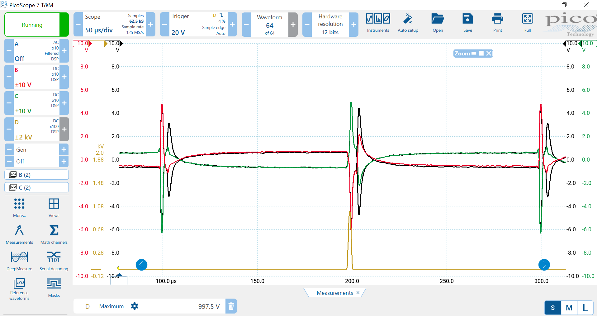

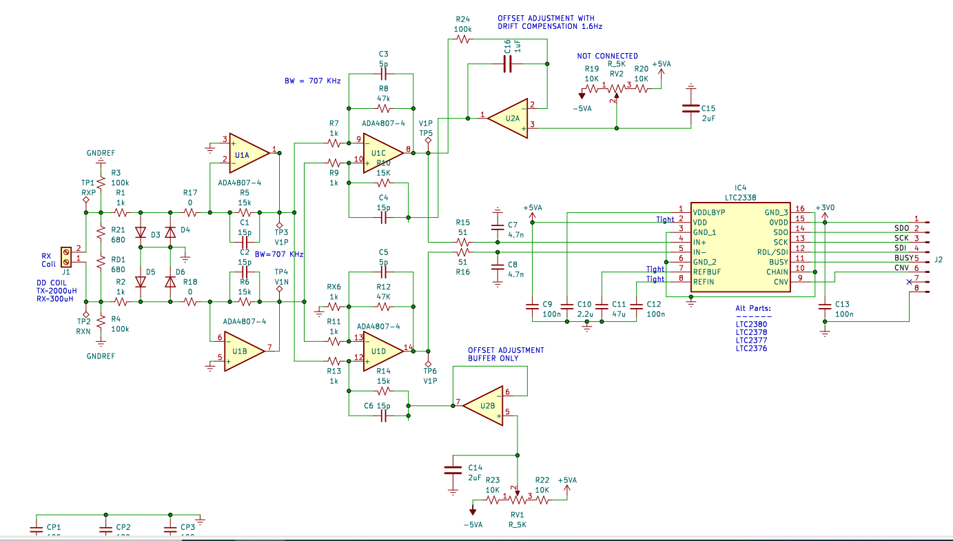

          [ATTACH]n419523[/ATTACH] Here is the last breadboard experiment of the preamp. with a gain of 15x47. The black trace on the scope shows the signal of a 25x25mm kitchen foil. I will now starting to draw the layout of the Preamp PCB. I will also end this thread and continue on the AMX RX thread where is belongs. https://www.geotech1.com/forums/foru.../408950-amx-rxClick image for larger version
ID:	419524 Click image for larger version
