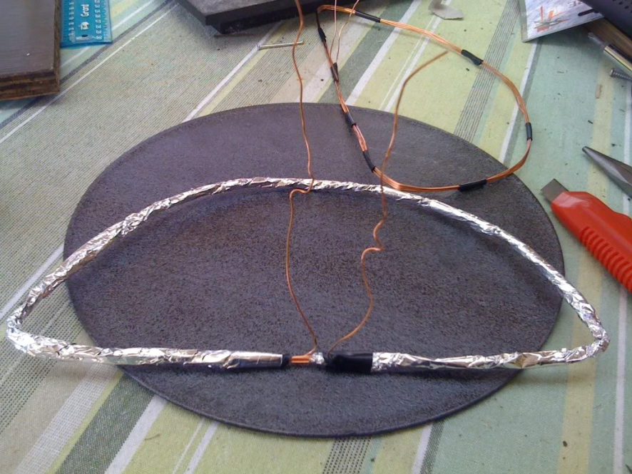

          0Click image for larger version  Name:	image.png Views:	0 Size:	1.34 MB ID:	422302​
          if I find somebody willing to help me.​ = you should post coil schematic and photo
              Pito, thank you for the driven shield picture.
              You want to see a coils schematic and a photo. Please explain, because I do not understand what you want. I have posted pictures and parameters of my DD coil on the thread AMX COILS.

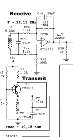

                              • Please explain, because I do not understand what you want. = example showing how coils are connected to PCB, here is missing shielding .
                                Click image for larger version  Name:	image.png Views:	0 Size:	34.4 KB ID:	422481
                                and how it is done
                                Click image for larger version  Name:	image.png Views:	0 Size:	1.00 MB ID:	422482Click image for larger version  Name:	image.png Views:	0 Size:	1,003.2 KB ID:	422483​​​
