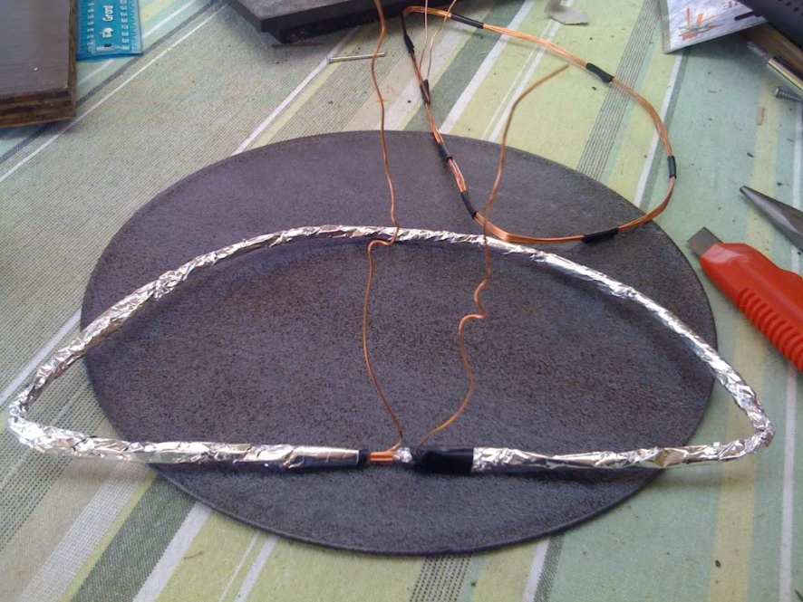

    Please explain, because I do not understand what you want. = example showing how coils are connected to PCB, here is missing shielding .
    Click image for larger version Name:	image.png Views:	0 Size:	34.4 KB ID:	422481
    and how it is done
    Click image for larger version Name:	image.png Views:	0 Size:	1.00 MB ID:	422482Click image for larger version Name:	image.png Views:	0 Size:	1,003.2 KB ID:	422483​​​
    For the coil, look at: https://www.geotech1.com/forums/foru...625#post419625
    For the preamp schematic and test results look at: https://www.geotech1.com/forums/foru...387#post419387

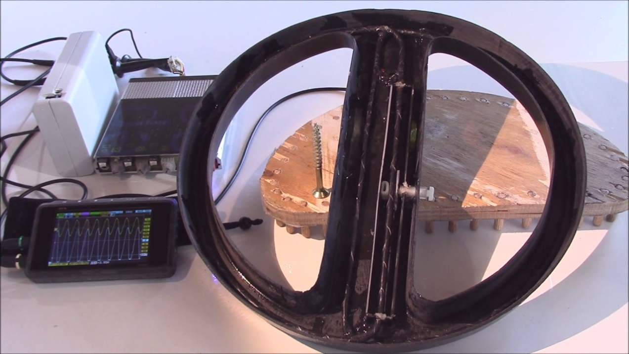

    To be able to detect a target with a TC of 1us (one microsecond time constant), with a PI detector, we need to take a very early first sample. A TC of 1us means that after 5us the eddy currents are gone. With a delay of 3us we should have a chance to still detect the 1us target. (filedata/fetch?id=418898&d=1704960623)

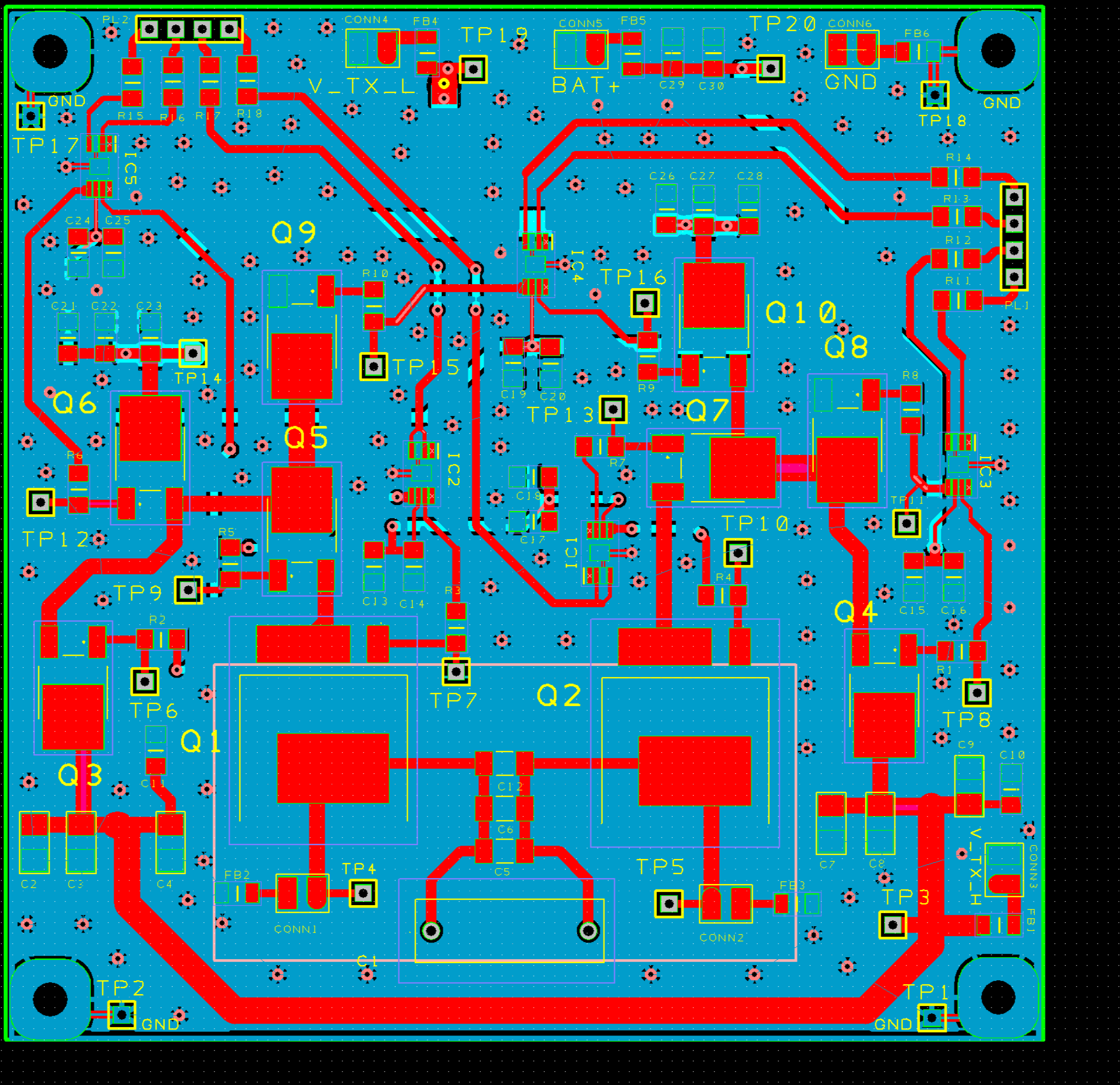

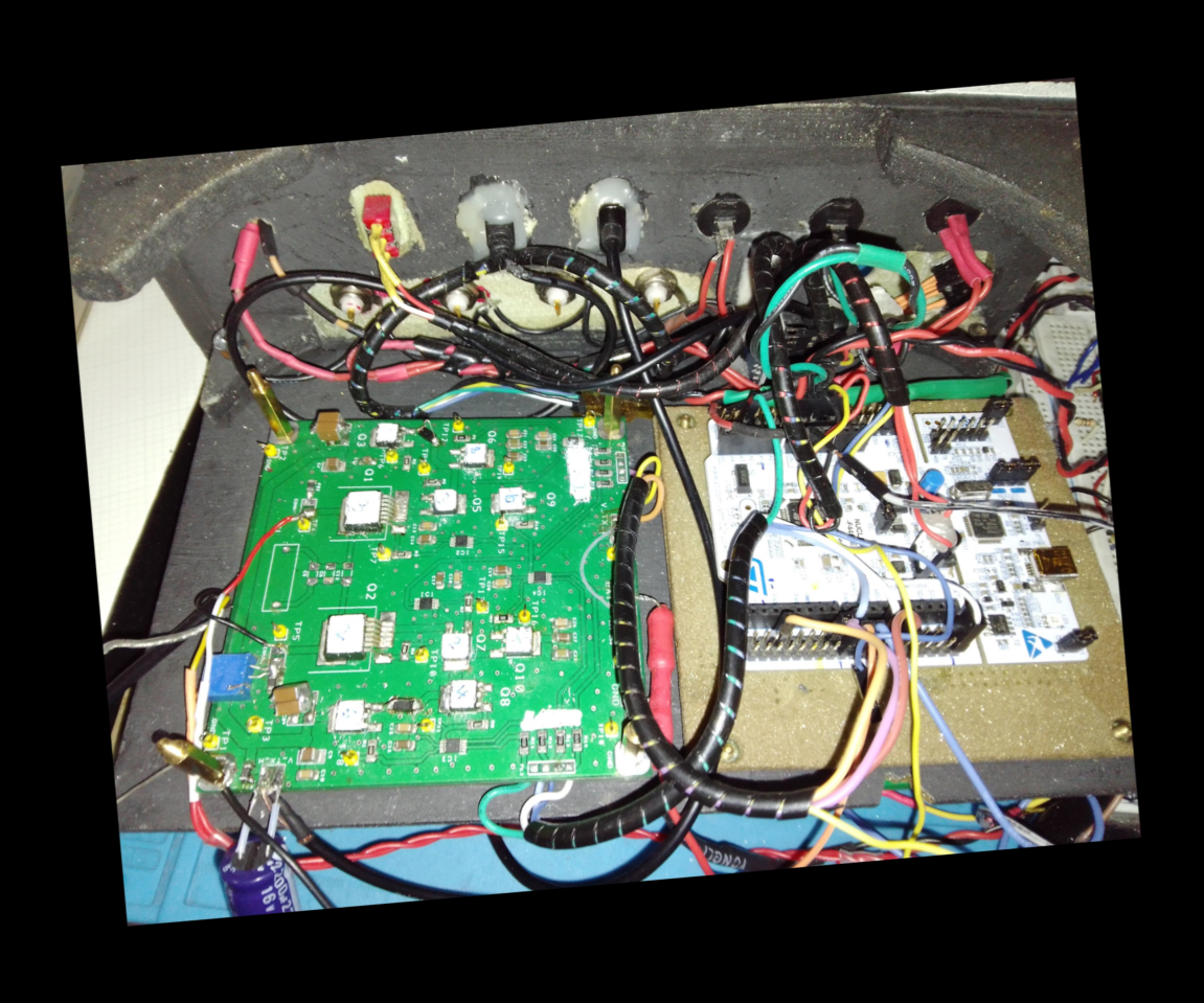

    For the TX schematic and TX board
Name:	TX board.png
ID:	422499 Click image for larger version
Name:	TX and Nucleo.png

      • Hi Tinkerer,
        Do you really think that TX end stage with 10 MOS FETs is appropriate for hobby manufacturing of PI MD?
        • Originally posted by PICON View Post

          I have worked a little on the RX :https://www.geotech1.com/forums/foru...387#post419387 For the testing of the frontend I used my own well tested TX board that is a bit more complex for the timing because it is synchronous. (Mooz's TX uses the internal diodes of the Mosfets). The use of the Nucleo STM 32F446 is definitely not ideal. This seems to be where we are.
            Detectorist#, thank you for the feedback.
            I think it is 8 Mosfets or did I post a wrong schematic? Right, I just checked, it is a different schematic with 2 additional Mosfets. I will look for the right one.
            2 high voltage Mosfets about US$ 10 each
            6 Cheap low voltage Mosfets.
            I would appreciate if you would tell me in more detail what your concerns are. Cost? Assembly? Timing?

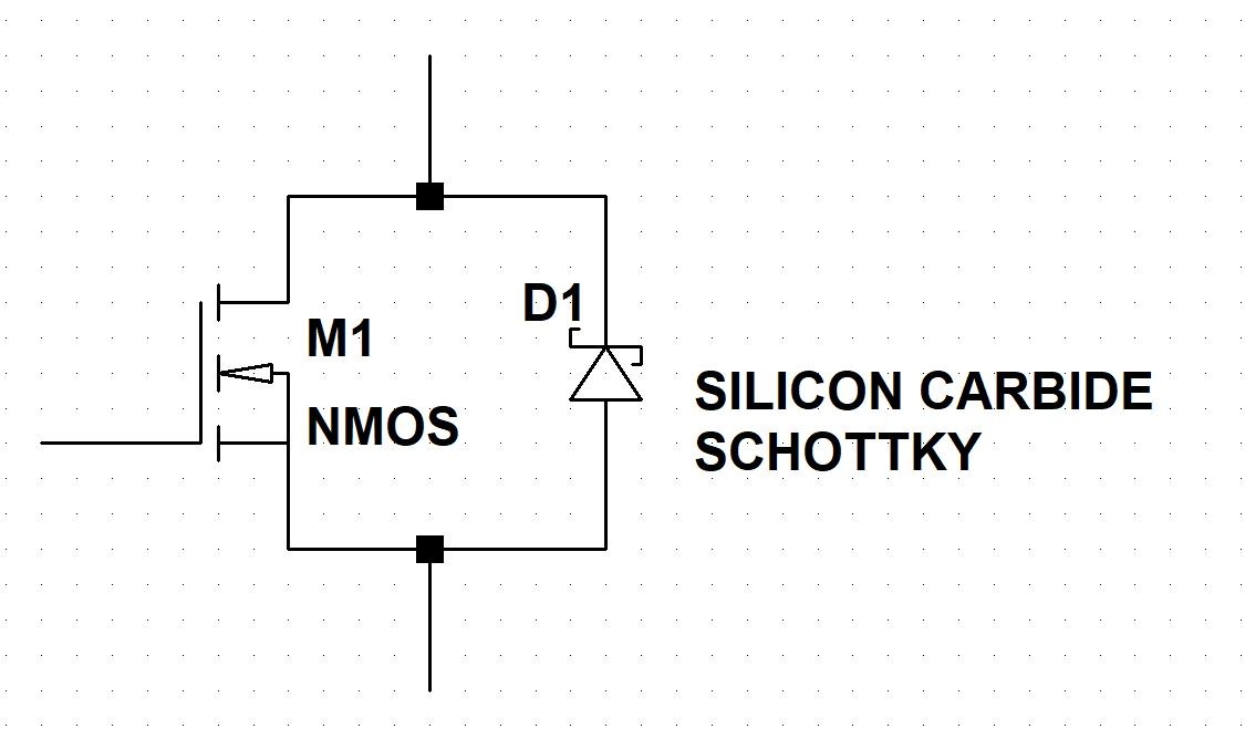

                              Slight correction the circuit is not a H bridge but more correctly a switch buffered H bridge as there are only two switching elements connected to the coil ( unlike 4 in a "conventional" H bridge )

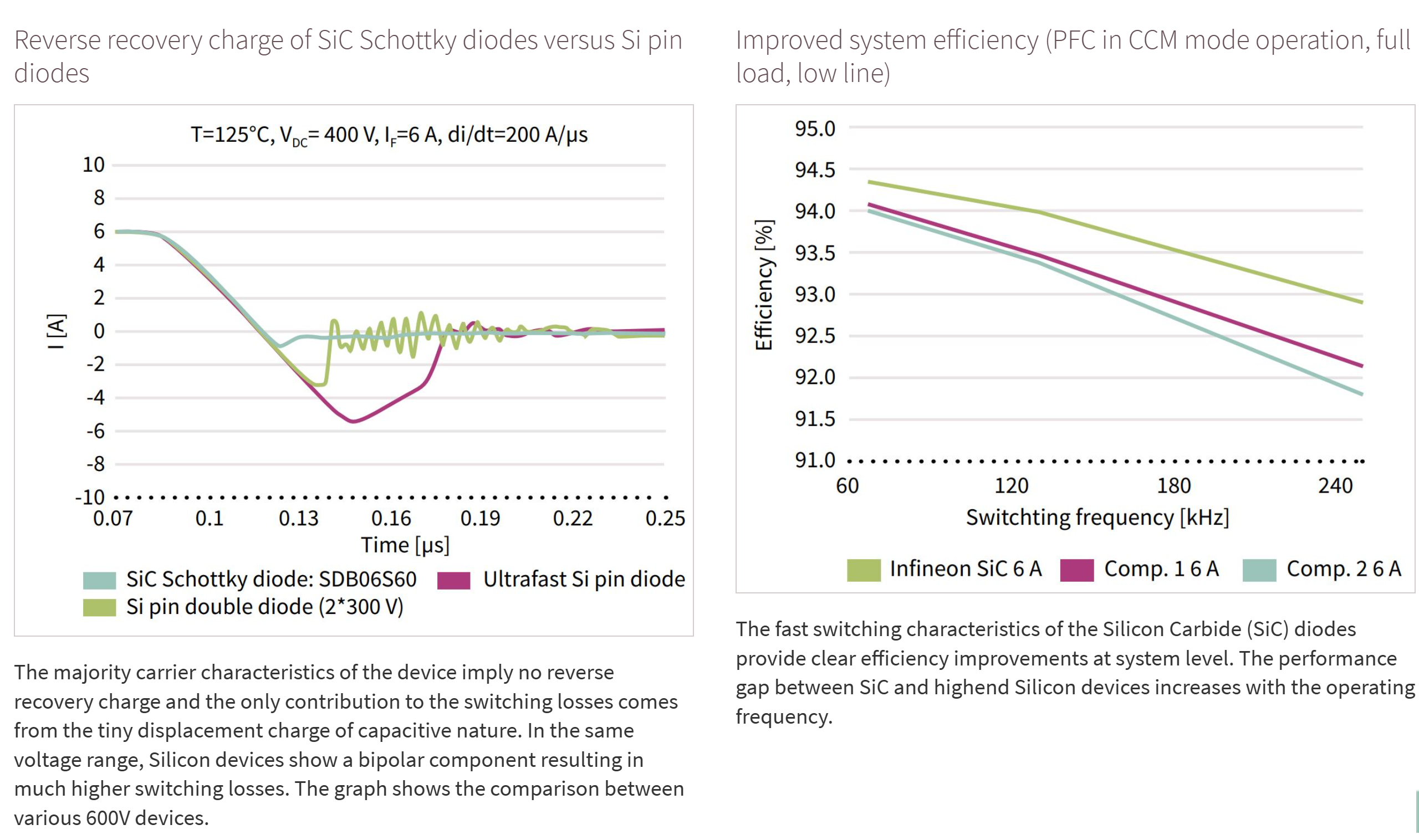

                              Also the two high voltage Mosfets should be used with a parallel shottky diode to minimise body diode losses like so below ... I dont use the body diode.
                                Click image for larger version  Name:	SW.jpg Views:	0 Size:	67.1 KB ID:	422543
                                Discrete Silicon Carbide (SiC) Schottky Diodes | Wolfspeed
                                CoolSiC™ Schottky Diodes - Infineon Technologies
                                Choices of Silicon Schottky diodes.
