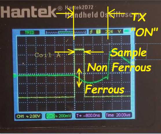

          The purpose of flipping the polarity of the RX coil is so you can hear non ferrous targets on the iron DISC channel instead of ferrous targets. In iron infested areas hearing all the iron would drive Ya nuts!
          While sampling an induction balanced receive coil while "TX ON" , the extracted signal will show opposite change in polarity between ferrous and non ferrous targets.
          The DISC channel will never trigger the comparator otherwise.
          We found out that flipping the polarity MAY require the null position to be adjusted slightly by moving the fine tuning end of the bucking coil in order for it to work properly.

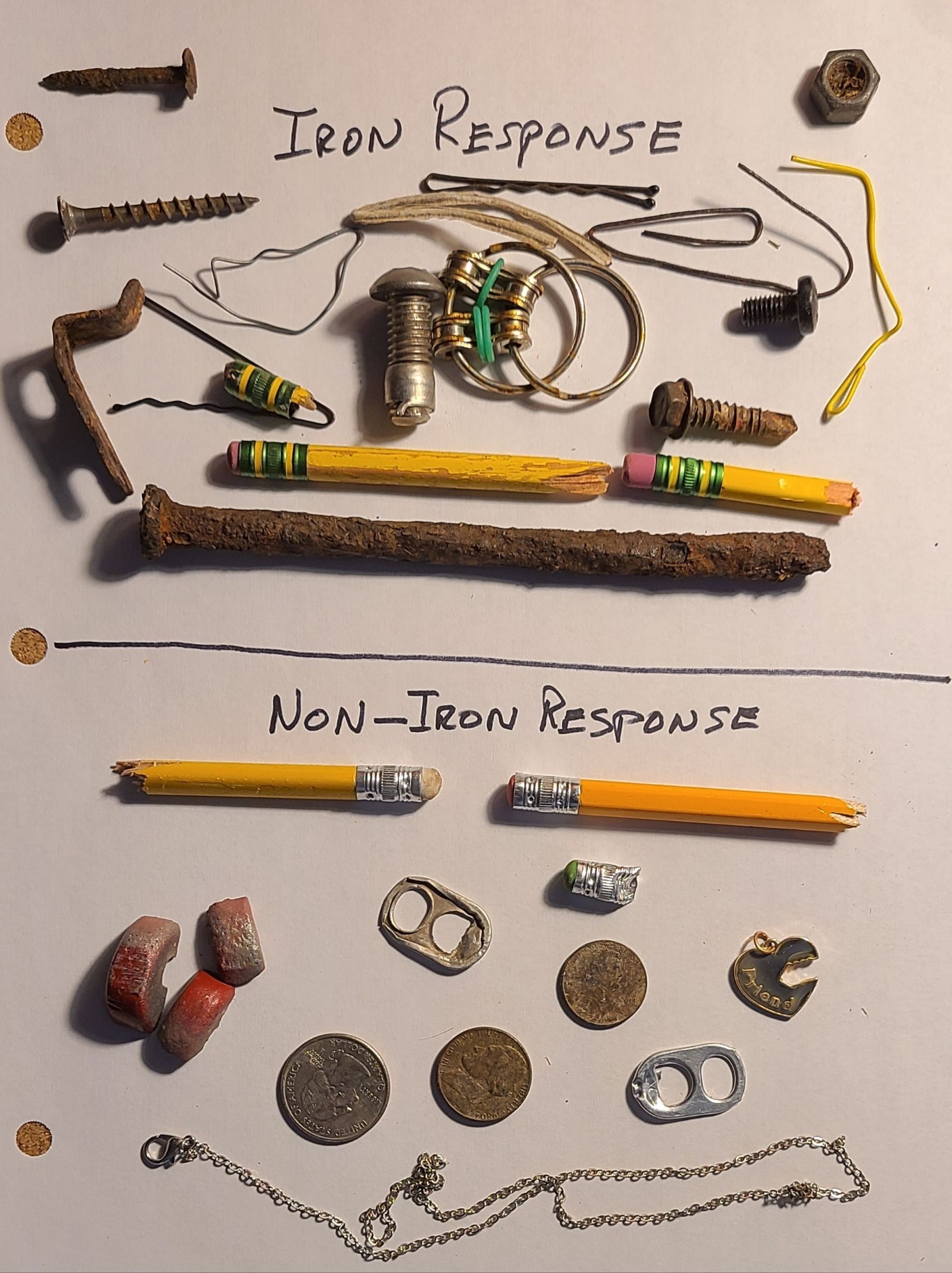

                  Here is an example of a school yard hunt with the MPS-PI.
                  Cyril ( Who layed out the PCB and designed the PI section)
                  sends me pics like this all the time.
                    I'm surprised any pencils register as iron since the ferrules are aluminum. What are the 3 red things in the non-iron pic?
                      Carl. The red things are some sort of cast metal. One thing about the MPS, it's really good at identifying any ferrous content, like bottlecaps. Some pencil erasers do have ferrous content, checked with a magnet.

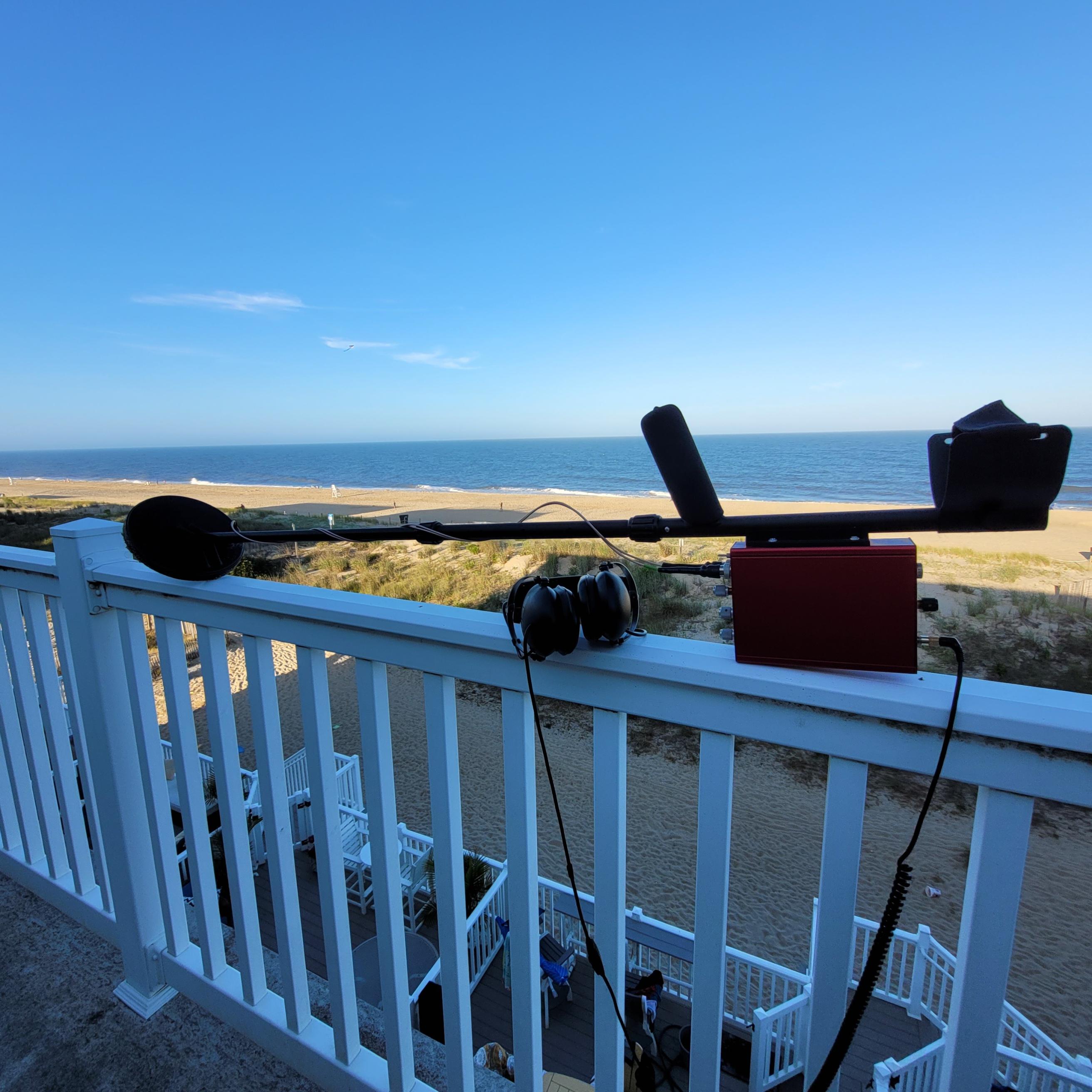

                        More testing with the MPS-PI today.. I originally did not have high hopes with this design when it comes to salt beaches, just because it's a "hybrid". But.. I was pleasantly surprised to find that It's100% at home in the salty surf. No noise or false signals on either the PI or iron disc channels in the surf! In fact, I ran my iron disc reference pot at 0V (max sensitivity). I was fooled by one very deep bottle cap and one piece of steel wire on edge but otherwise was nearly 100% accurate on iron ID. I didn't find much other than a handful of corroded coins, fish hooks, Bobby pins and fence wire (I dug everything for a sanity check). Ocean City Maryland...
