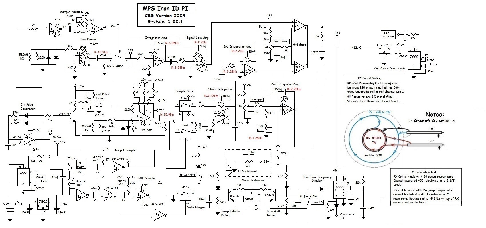

        Sharing the latest component values. Changes here include efforts to closer match the frequency response of the the All Metal and iron Disc channels. The original 1.09 build posted is a bit hotter, more like the Baracuda project with a longer transmit pulse and longer sample. This version is more tame but handles mineralized ground better I think. This version has been tested quite a few hours by C.B. Smith.

              for what reason is there a separate power supply for the disc channel?
              And what purpose has the bucking coil?​

                The second power supply is not really needed. It just provides some headroom.
                As for the bucking coil, it creates an induction balance coil, just like a "DD" coil. A concentric design works much better with this design though. There is no other way to reliably discriminate iron with a pulse induction machine that I know of. It just happens to work well!
                As far as the PCBs go, I dont know.. the gerber files are provided if you want to make your own board or modify them.
                The schematic is drawn using "Paint" , standard with Windows.
                I just Draw basic components, then copy, duplicate and paste.

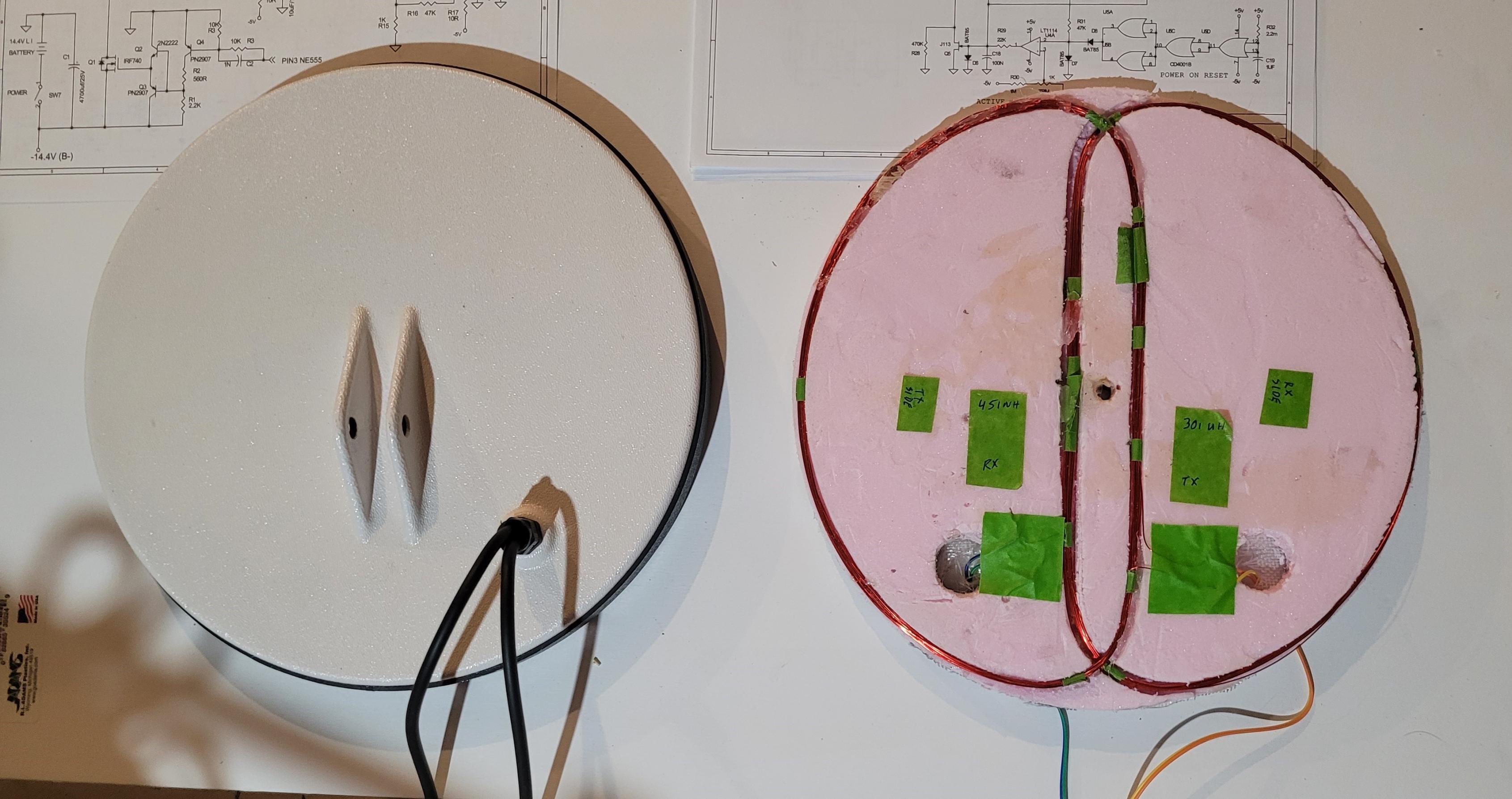

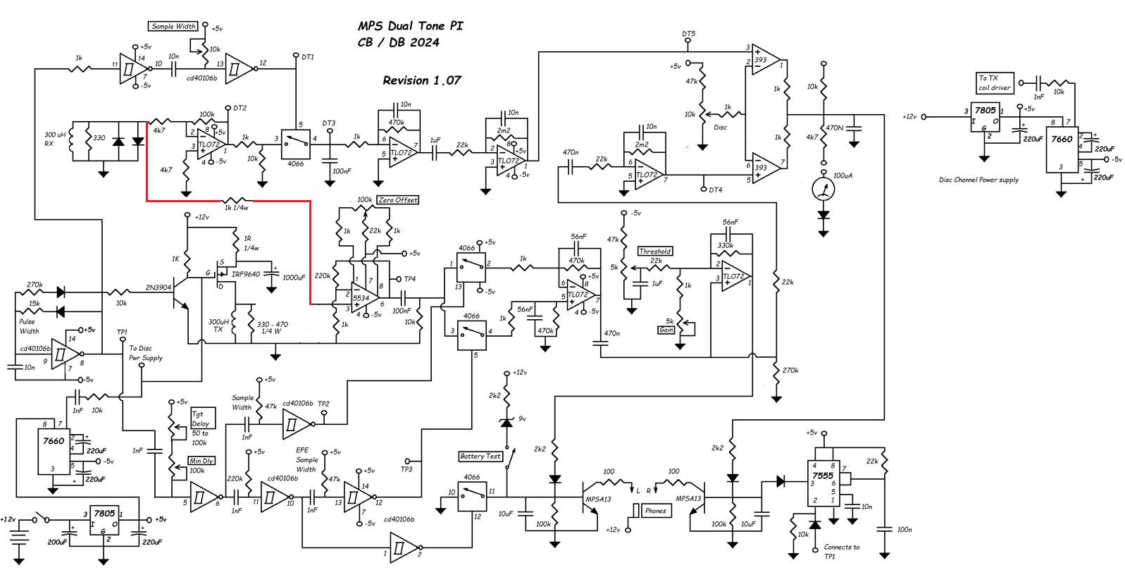

                          Howdy folks!
                          I have been doing a bit of work lately on getting DD coils to work correctly on this design and have met with a bit of success. I see advantages with the DD coil configuration on ground rejection, slightly faster sampling capability, noise reduction and ground coverage and I can run a higher gain as compared to a concentric design. Plus, by sharing the RX coil between the PI and iron disc channels, the DD will pinpoint right down the center of the coil. I still must stay that DIY concentric coils are easier to get to work correctly though. (I guess I just like concentric designs) A 7" concentric is still my favorite!
                          Note the modification in red on the schematic needed to get the DD coil to work correctly (centerline pinpointing).
                          My coil values are:
                          TX - 300uH
                          RX - 450uH
                          Coil diameter - 10"
                          Coil shielding was done with graphite paint applied to the inside of the shell, joined with drain wires to the RX cable shield. I don't know why.. It just works best when wired that way..
                          Both windings are made from 24 AWG magnet wire for simplicity, just glued to a round sheet of 1/8" hobby plywood, installed in the top half of the shell.
                          Coil leads are a pair of high quality audio cables.
                          I have included a pic of a test coil and my completed coil.

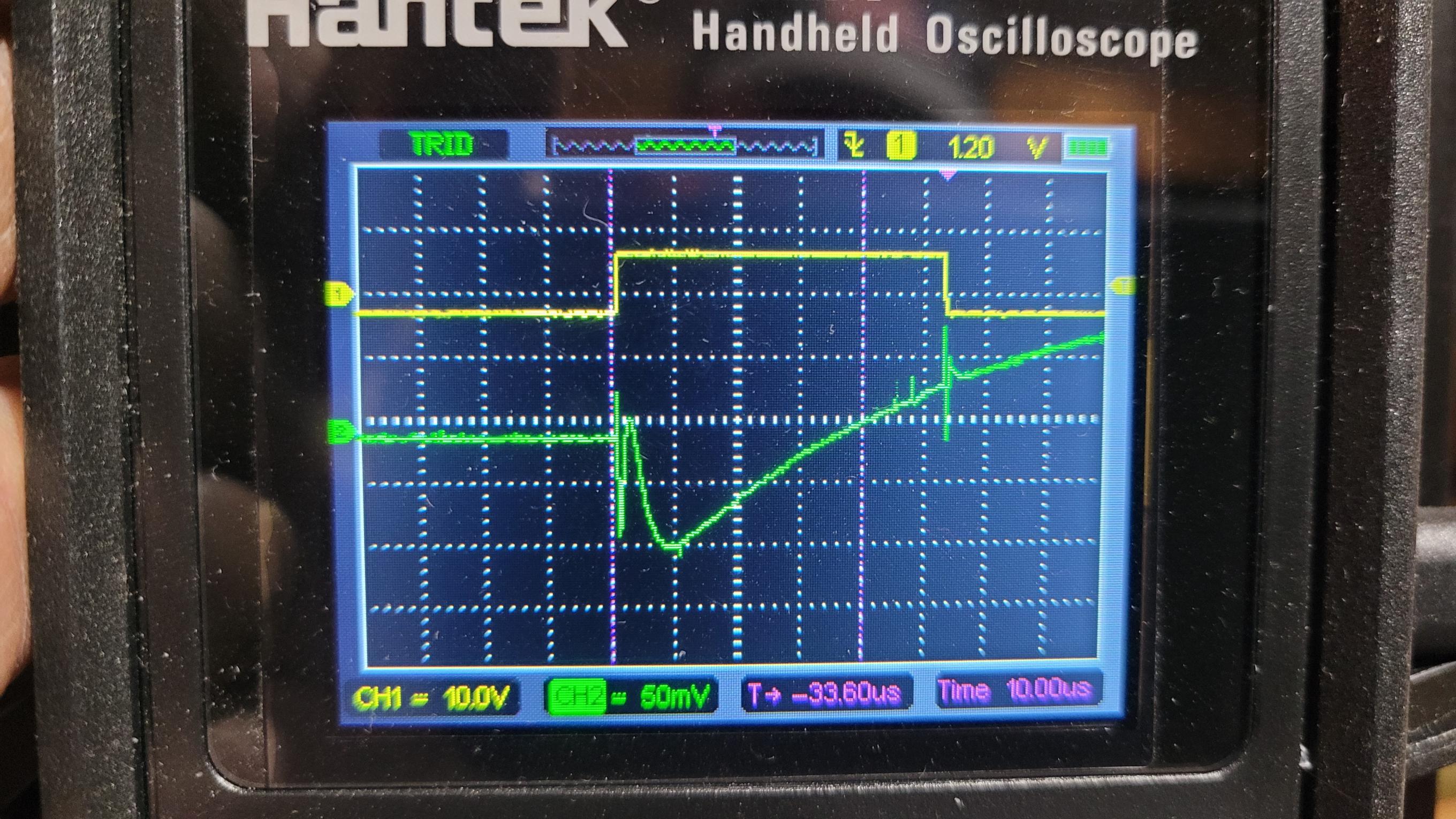

                          Also, note a screenshot of what a correctly nulled coil will look like. If the null is not correct, the iron DISC channel audio with sound raspy or may not work at all.
                          Channel #1 is the iron DISC channel sample window (DT1) .. and the Channel #2 is the output of the iron DISC channel preamp (DT2).
                          Anyway, maybe this will encourage others to consider this project. If nothing else, it's a good learning platform for experimenting with the DISC SAMPLE WHILE TX ON method of iron discrimination.
                          Don.
