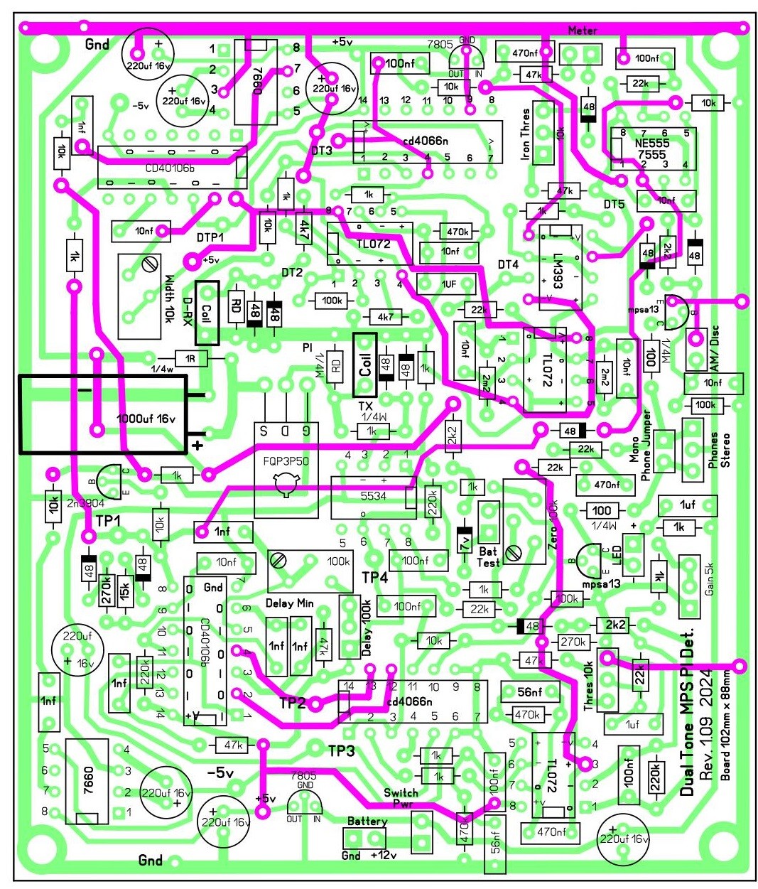

    Originally posted by phred01 View Post
    Is a Gerber files for the PCB available?

          Originally posted by algan View Post
          Very nice layout obviously done by hand Converting the cct to Kicad which will make it easier to make enhancements

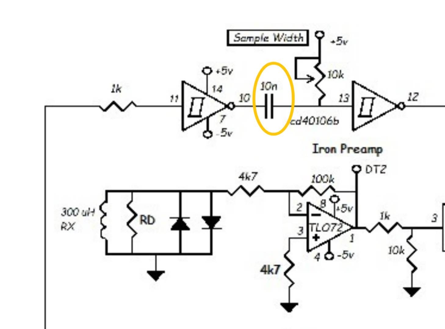

              Dear dfbowers,
              Click image for larger version  Name:	caps.jpg Views:	0 Size:	98.4 KB ID:	432893
              I have question, does change this 10nf lower to 1nf will make it sample sooner? Thanks
              • #52
                Hi Op04,
                This capacitor influences on the sample width. This sample starts with the start of the TX pulse. Sooner not nothing!
                • #53
                  Hi Op04,

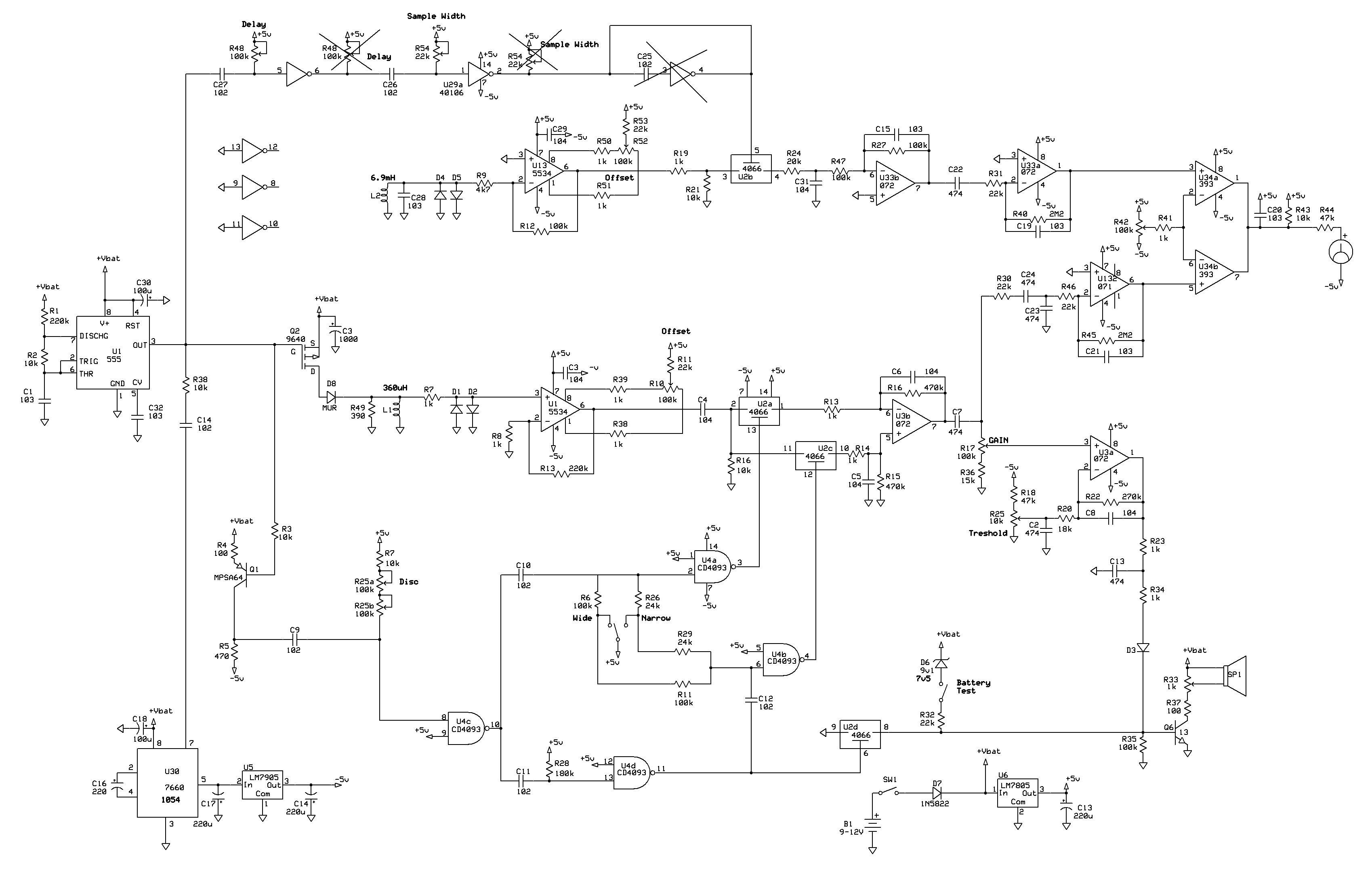

                      Hi pechkata,
                      First source of this idea is from 04 Jan 2021 from DFBowers. This is the first variant of this idea. DFBowers generates this idea after reading of Voodoo project from year 2020 from George Overtone. Until waiting of the parts for Voodoo project, DFBowers decides to test similar solution but without microprocessor control. "DB_HIBRID_ALTAIR.jpg" is only the copy of this first variant.
                      • #56
                        This is the link:
                        https://www.geotech1.com/forums/foru...cussion/page57

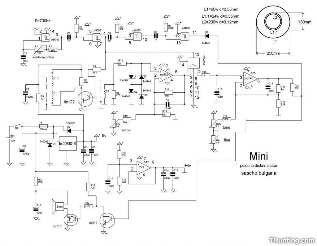

                          It is interesting, but the first raw idea for PI IB discriminating detector is maybe from Bulgaria from year 2008. Autor is Sascho from town Varna. This idea is publicized in THunting.com
                          • #58
                            Hi Detectorist#1
                            can you explain how the pulse ib discrimination part of the circuit works?
                            • #59
                              That circuit works only because there is no ground balance, the rest works..

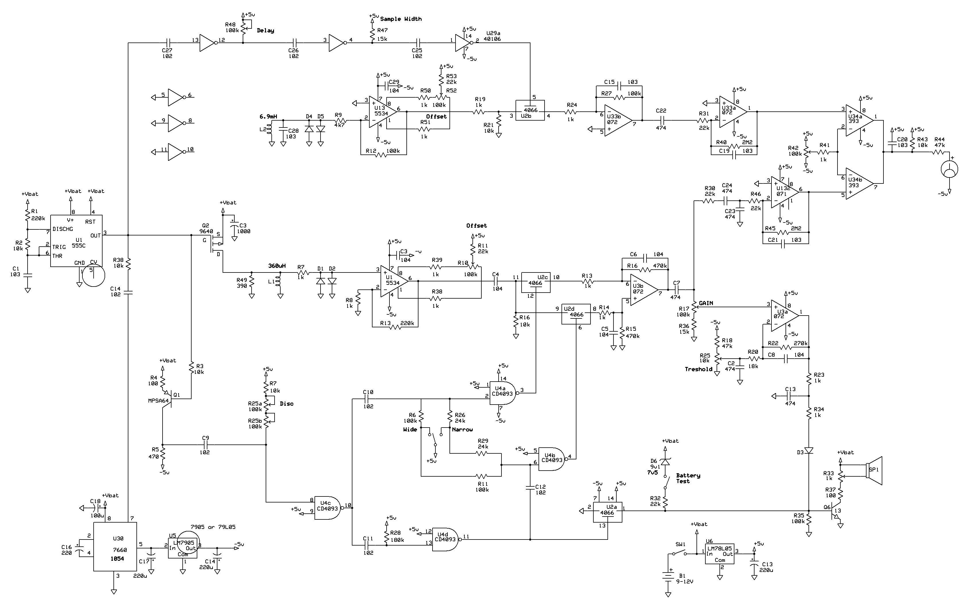

                              • #60
                                G'day all
                                Looking for proof readers Just drew up 1.22.1 in Kicad ver 6 using Pi4B running latest Bookworm OS
                                please find attached pdf of cct drawing Would verification the drawing is correct in detail before releasing the sch file
                                It's been a learning curve so far haven't reached the PCB generation bit​
